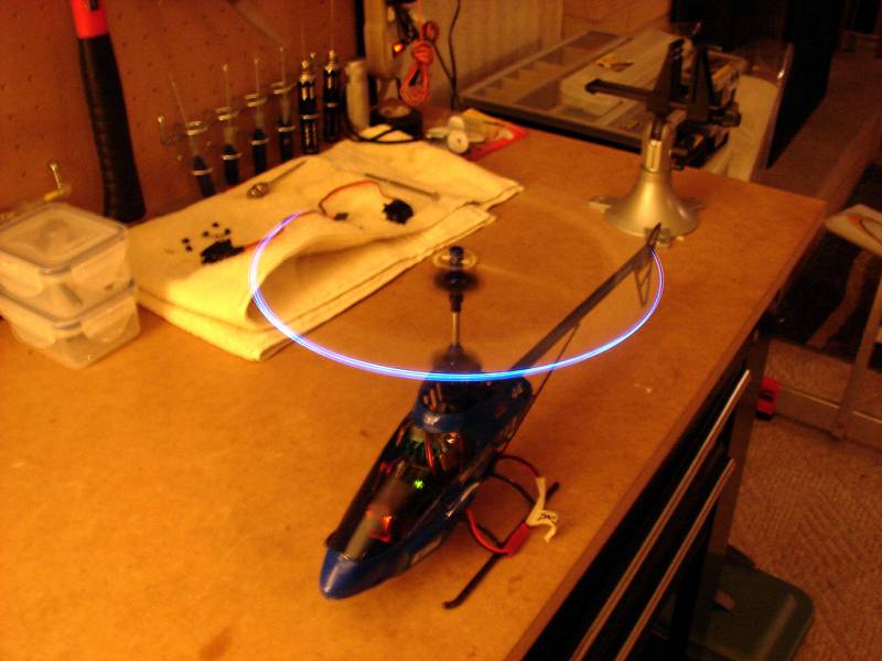

Default RE: CX2 unstable hover after xtreme upgrades
I'm going to order the Xtreme upgrade myself here in a couple of days. I installed the brand new blue LED flybar over the weekend. My X180 motors should be coming soon and then I can complete the project with the other Xtreme upgrades. I'm trying to decide whether to upgrade my newer CX2 or my older CX2. Decisions, decisions...
Here's some pix of the new flybar.
