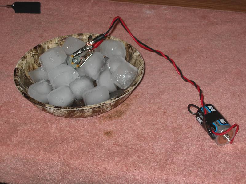

Really helps for the tail motors for the CP. You can just hook up a AA battery and let it run for a long while. Turns the motor slowly and smooths out the brushes.

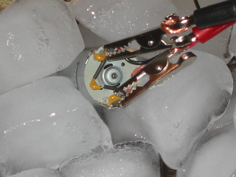

Also here is how I just broke in my main for the CPP. I had it in front of a fan (upper-right hand corner in pic) hooked up two AA size batts, through it up on some old scanky skids, and let er run...!
Hope this helps partner,
-- Jeff

If you dont break in the motors, what is the consequence?
I am a college student, living in dorms, so I dont have access to soldering irons and other useful equipment.
Thanks for the info guys!
Its going to increase the life span of your bushings in the motor. It will also insure that your getting good conductivity and lower resistance to give proper power gain.
Is it nesessary, no.
Flyinsolo11--
Don't worry about it...Some guys do, some don't...Before I got into the heli's, I was into the RC-cars (electric) and I never did. Only in the last few months have I started doing the procedure on the heli's... I've noticed longer motor life, along with them running cooler, and quieter... I hear breaking them in improves the effeciency of the motor.
It will give ya that little extra edge...
-- Jeff

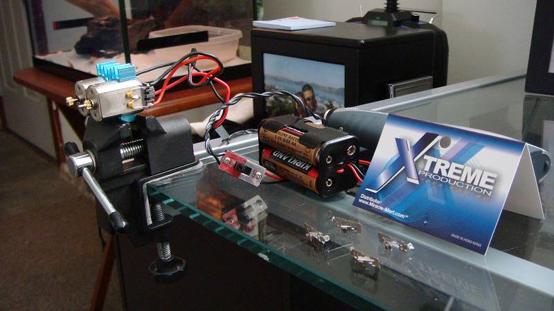

Hey flyingsolo, you can makeshift a system with electrical tape and the battery. I was too lazy to solder myself so just strip back the wires and tape them so prtect against a short. I also used the tape to hold the leads to the battery. I know it ain't pretty and but it does work.
cltmte--
Lol...I do the same..! On my second engine break-in I just started using the tape...Hek with it, and it worked fine for what it is...Lol.. Which Flyinsolo11, you could easily just "jerry" something up for a quick-doohickie type little unit that will adapt well for your limited space that you are dealing with for the moment, besides it will give ya something to tinker with, and maybe confuse the roomate or something...Lol..
