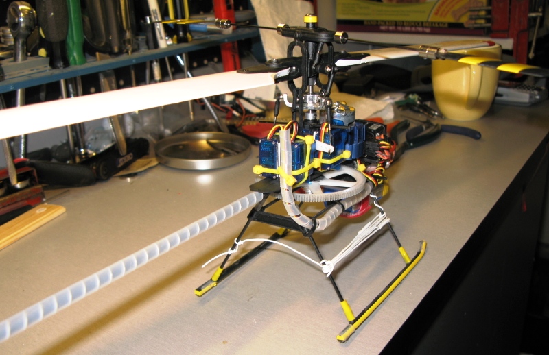

You can also use "Spiral Wrap" for wire on the boom. Light and elastic...[8D] Comes in Clear (looks white) and Black at Home Depot.
I would wrap the ends of the blades with clear box packing tape after some strikes. It really protects and holds the plastic covering in place.
Don't forget to balance the blades after installing the tape...

i'm liking the look of the spiral wrap - probably light too - if you get too much weight back there you'll have problems getting the nose down and have to put some forward on the swash, which could affect performance in ff - try it and see, just watch the cg
