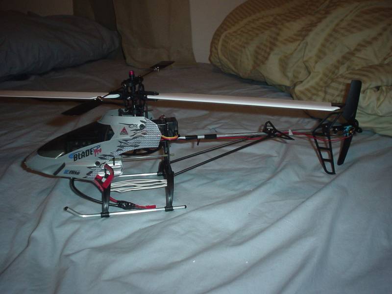

Hi guys I am new to the forum and hopefully some of you guys can help me out here. I have a blade cpp which is stock except I just bought a g110 gyro for it. Now heres my questions. I am running it with the 5th channel setup so I can adjust the gain from the TX. Heres the first question. When using the remote to adjust the gain what should the gain be set on the g110 itself? Do I turn that down all the way and just use the TX to adjust it or do I turn it up all the way on the actuall g110 and still use the tx to adjust it. The instructions say that you have to turn the pot all the way down on the 3 in 1 but I have read that that is wrong and you have to actually turn the gain all the way down. Is that right? Leave the pot alone and turn the gain down? I've tried it both ways and the problem I am having is the heli just wants to spin counter clockwise in super fast circles. I know I have all my wires setup right because the heli flies fine with out the g110 on it. I am still running the stock rear motor but have a dd setup waiting to be put on. I want to figure this problem out before I start adding more parts. My LHS is pretty much useless on helping me they didn't even know you could hook up the fifth chanel for TX adjustability. The guy said "I always wondered what that extra wire was for" If someone could give me a good starting point for this or a link I would be really greatful. I have a 60 dollar part sitting here and its getting no use out of it. Heres a review of my questions...
I am using my remote to adjust the gain on the g110 via the 5th channel. What should the actual gain be set to on the G110 itself not including the TX? Do i turn it all the way down or all the way up?
Do I turn the 3in 1 gyro gain all the way down or do I turn the pot all the way down like the manual says?
Do I mount the g110 straight up and down with the lable facing the back or do I put it on its back with the lable facing up?
Please help me out rc universe your my only hope!

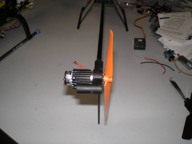

I actually have the direct drive setup sitting right here. The problem was that it came with a new motor mount and when I was having problems with the g110 it spun like nuts it landed and snapped it in half. The motor I have will not fit in the stock holder because this motor is all the way round with no flat spots on it. I think I can just make some cuts to make it fit but I am just going to wait till I get the right part for it.
Joined: Aug 2007
Posts: 6,441
From: Lincoln,
NE
I am using the stock motor mount. I just used a X-acto knife and if fits just fine. You have to make the rotor spin down away from the main blades or the helicopter will rotate left with right rudder.
