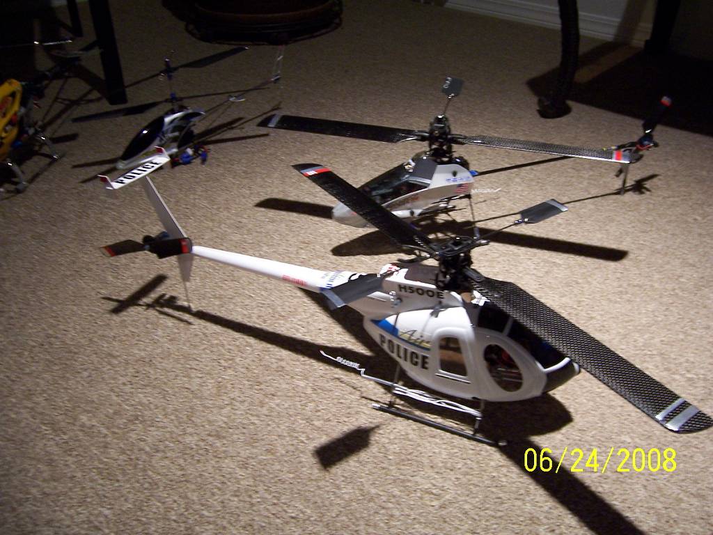

Steve ~
Just as the others keep hinting about balancing your blades, it will make a big difference in the flying performance of your heli, and if not balanced will show exactly what yours is displaying in your video, although the shaking could still be a few other things also. When I was in Cali last year working there for the year, I had both my CPP's up and flying good, and then I stored them and took the CF blades off of them during this. The last time I flew them both, they flew perfect.... Well, when I got back home to Washington State, and got ready to take one of my CPP's for a spin after putting on the CF blades back on, I couldn't figure out why the darn heli was shaking so badly... Worse than yours in fact... So since I had a bunchload of new parts, I started the process of elimination and started swapping parts... Dang I gave myself a headache because I couldn't for the life of me figure out why this thing was still shaking... Heh... It drove me mad, because usually I can troubleshoot a heli in my sleep !
Well, as you can see in my pics below, I have CF blades for both of them... And there tracking tape is similiar on both sets of the blades... And guess what ? I had accidently mixed those sets up, and so those blades had variances then in the weights / balances than from when I flew them last with the right sets balanced for each bird. There was a difference in half a gram, and with all new parts on my CPP's (the original CPP's) it didn't matter, as it made the heli's vibrate like a big dog from having imbalanced blades. So I put on the correct set after weighing and balancing, and then the heli's flew very smooth with no more shakes...
I was so discouraged that I even flew one of the CPP's with that bad shaking, and even crashed at the end... This was 8 months ago... And as you can tell, at the end of the video when I crashed, that soft paper clip, snapped ASAP and saved my main gear and shaft... It beats that very strong stock retaining pin that will usually take out your main gear, and stress out your rotor head. The "paper clip mod" is really a saver, and so think about that also for the future...
Its hard to tell in the video, but the CPP was shaking violently... If you look at the antenna you can kind of see it then shaking :
http://vimeo.com/3464598
I wish I would have been able to learn on the newer CPP2's as those things have so much more power and especially tail control from the upgraded stuff now used on them. Not to mention already equipped for the Spektrum TX's... The original CPP's are VERY underpowered, and tail control on them is near to nothing ! Not to mention they had the famous glitching from the old school 72mhz systems that they had and used.... Eh....!
I still fly them though for fun still to this day however, there all stock still except for CF main and tail blades...My recent video then of one of them was 4 months ago at a bigger field, and although underpowered, there still a fun little craft to take out once in awhile... In this video now, you can see what a CPP fly's like with a set of blades that are balanced ! No more shaking !
http://exposureroom.com/members/J-MI...f14216dcf7b36/
~ Jeff

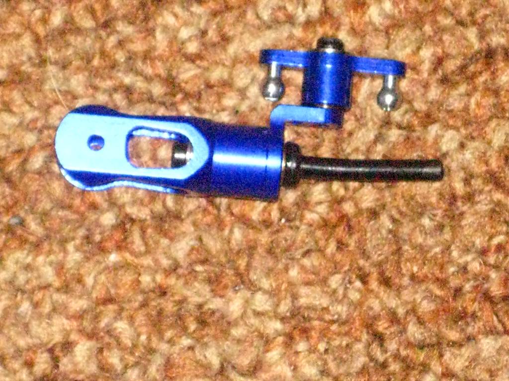

Alright, i guess i should have picked up on this before, but i didn't realize when people were saying "bent spindle" they may meant the thing inside my rotor head...
I took an alan wrench to the inside of my blade grip, and something is definitely bent in there, i just can't figure out how to get my blade grips off...

The gear mesh won't have anything to do with the wobbling your having on the heli, but will wear out your gears faster, and also creating excess drag and heat problems, reduced flight times, etc. etc...
What will make your heli wobble is your spindle / feathering shaft (same thing) and they almost always need replaced in a crash. Definately check it and roll it on a piece of glass... After a crash, I don't even check mine, I just replace it... Just a very slight tiny bend will cause havoc with your heli without a doubt.
To remove the spindle, it best to use 2 alan wrenches on each end of the spindle to break them free... Usually one will free up, and then allowing you to slide the spindle out as the blade grips should loosen up then to remove them also. Most likely, if that spindle is bent then that is the big cause of your vibrations, following then by imbalanced blades. But the spindle would be the #1 cause at this point...

Yeah, i think it is the spindle... i managed to get one of the alan screws out, but i can't get my blade grip to come off my rotor head... the second one is still locked in so im having trouble getting that out, too.
i shouldn't need to take both out, right? should i just pull harder on the blade grip to try and free it up?
im just afraid of damaging it further, or sending small parts flying
EDIT: nvm, i just pulled it off...

Yeah, definitely the problem...
although, my rotor head was brand new the last time i crashed, so it couldn't have been the problem before. i was flying wooden blades that had been in a crash before, though, and lost uneven amounts of their plastic coating. i'm convinced that the crash was due to unbalanced blades, or poor tracking before.
It was a mess;
I'm going to order whatever parts i need and hopefully get it fixed this weekend. Ill post a (hopefully) success video
Thanks everyone!

except i dropped the center-ball part of the three piece ball bearing things you see in the top right of this picture http://www.helihobby.com/commonImage...n/EFLH1182.jpg and i cant find it so i might have to buy a whole new grip set
EDIT: I was wondering if someone could confirm thisare the ball type bearings (top right most bearing in the picture i linked to) called thrust bearings?
I'm going to try to find the same dimension bearing online somewhere so i don't have to drop $35 on something i pretty much already have :/
Thanks, still!
