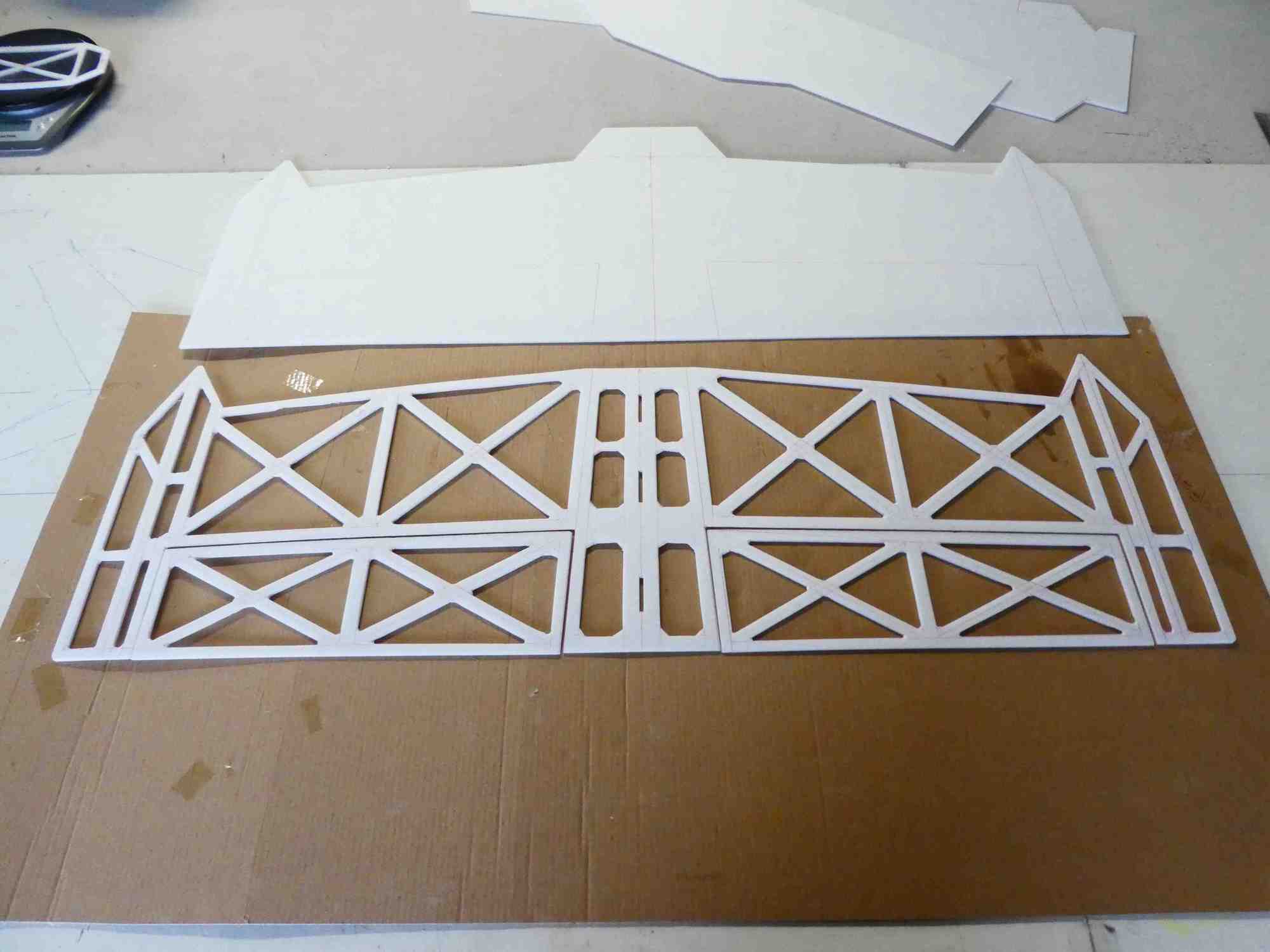

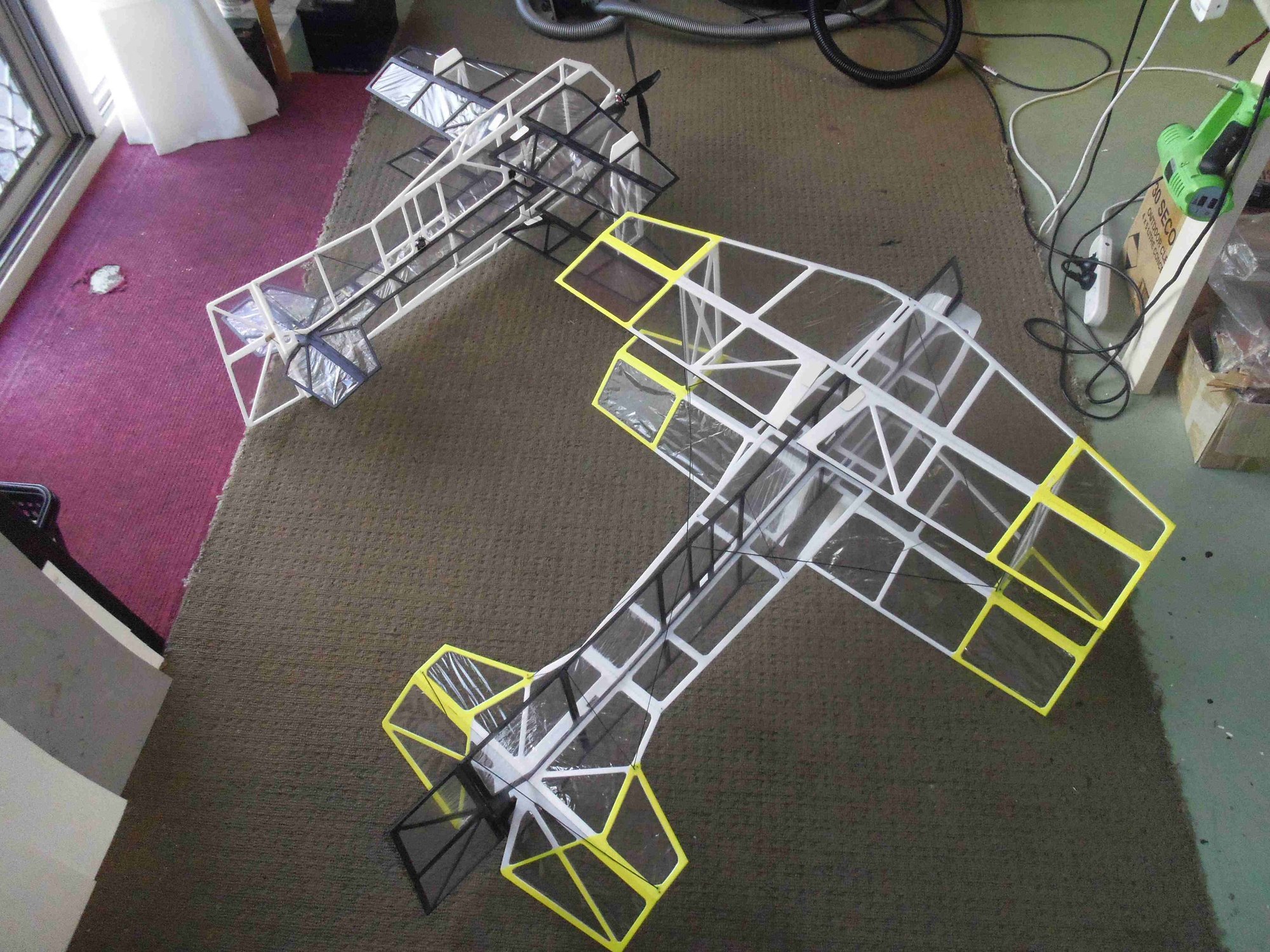

Started on the top and bottom new wing design.
DDDC175 project on its way.

Lot bigger job than expected, this one will take good 120 hours judging by my last 75 h mono project to fully complete. Extremely delicate, it will take some carbon fiber to make it air-worthy for out door action.
More progress well on its way.
Delicate sanding of all cut outs take lot more time than cutting it out!
Handle like eggs job!

Outer wing supports test fit, and start on the main fuselage frame.
No strength whatsoever at this stage of build.
Slight positive lower deck.
Careful cutouts of center fuse X.

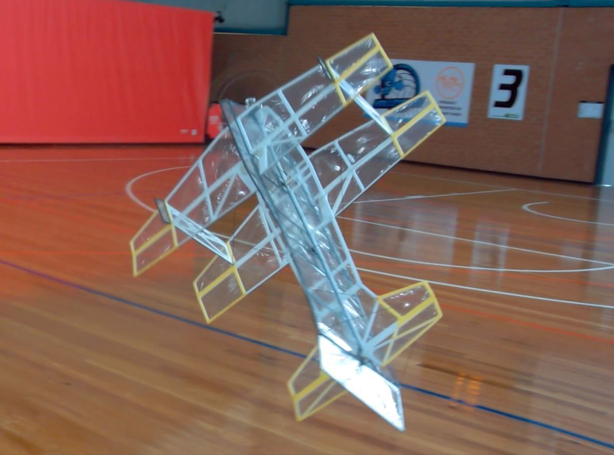

TX Mate, I got thousands of videos on YT over the years with all sorts, these micro lights I don't bother to load on as I fly them mainly late evenings during dead calms in twilight darker hours so the footage doesn't come so well.
I fly them daily, just over the fence, this eve flew 3 models, incl. this BI winger, and after bit of hard 3/D manouver I could hear a little snap, thinking it might be just CF ripped out at some joint but after landing it was clear.
The weakest link, Elevator "L"shape broke off, still fully under control but with next builds I will make that corner bit stronger.
This model at 230grams is little too heavy for that weak point during hard manuevers. Easy fix by foam glue and
Bit of a weak link, the corners of the "L" shape Elev. moving tabs,now reinforced with strong tape.
ading some tape over the break but will have to take it little easier in the future on the stix.

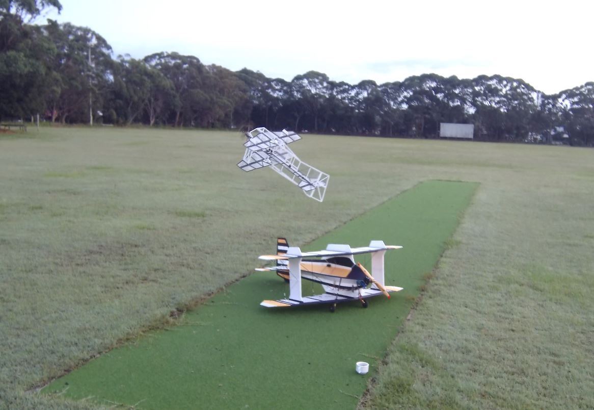

Great evening with the Bipe, 4 fun runs on 4 different capacity batteries, 2S/260-350mA.

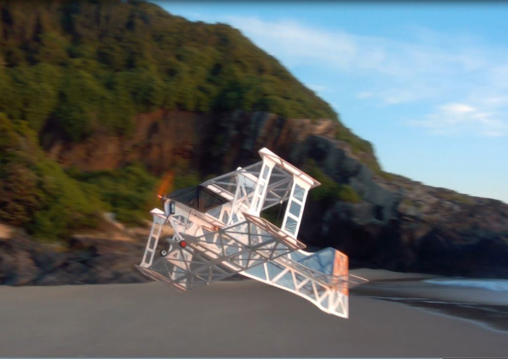

Took the Bipe to the beach.

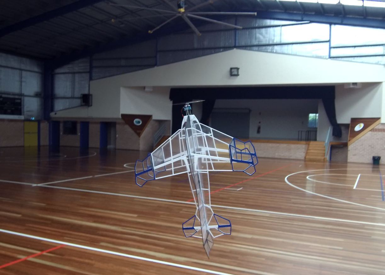

Still running nicely, indoors for a change.
Over the pitstop.

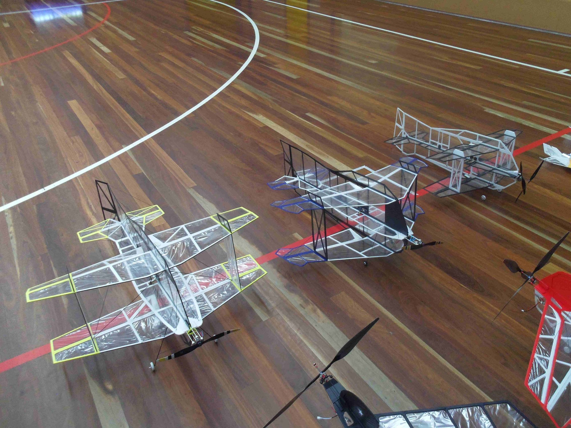

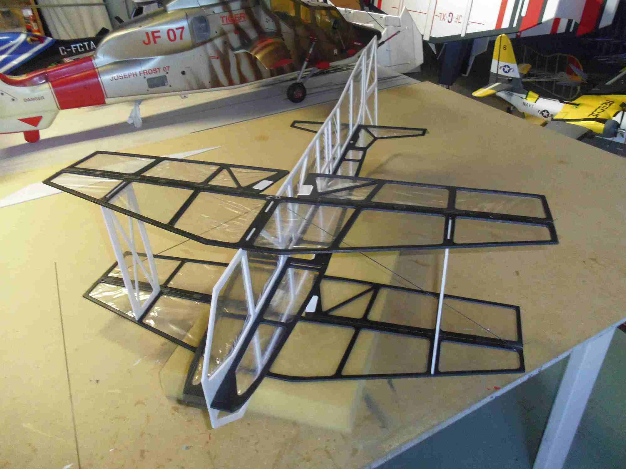

Six mo

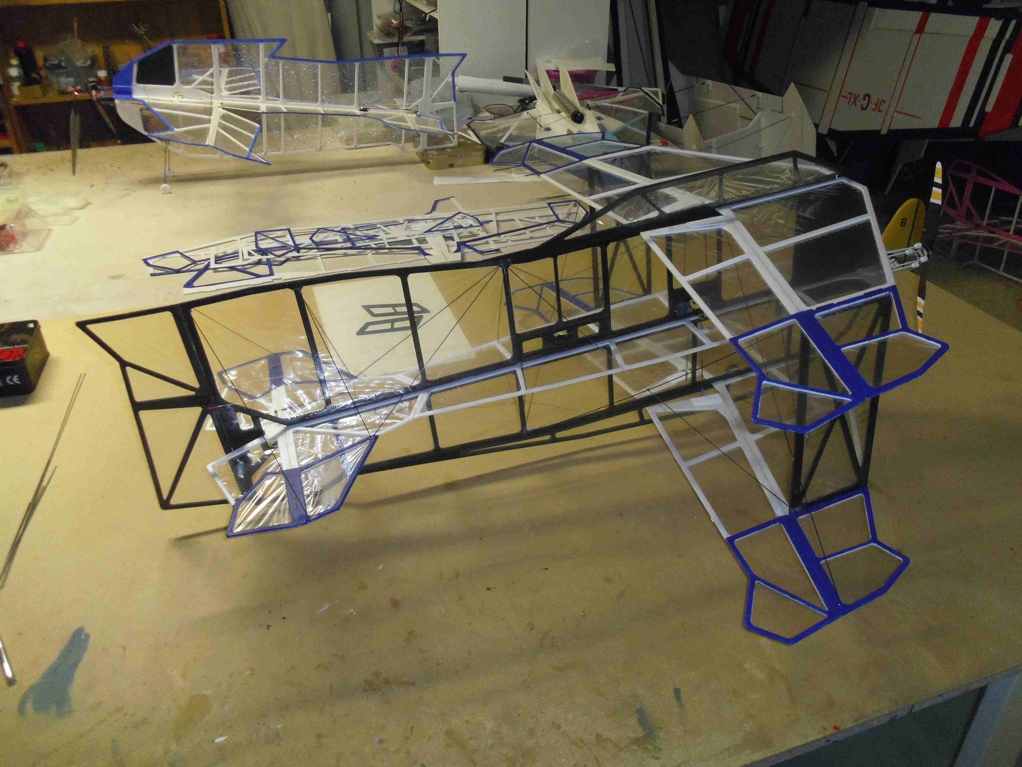

Bipe replacement in progress.
XL V2, nearing completion.
Final touches to V3 design.
Bipe Triplets at the Indoor Airshow.
Smaller V1 at outdoors.
V1 demo at Coffs/H Airshow.
XL close up.
V3 Maiden at Max Stadium Airshow.
nths later I sort of missed my 'Doubledekker" Bipe, so decided to build replacement with much lighter components and further experience with my skeleton design models. The new slightly smaller frame size model was such a success I have decided to build almost identical version as XL resulting with brilliant performance, "bigger flies better', so as a result started on the V3 with touch of sleeker frame shape Mid-size design to enhance my skeleton fleet with the set of "Bipe Triplets' as a feature for my weekly "JF-Indoor Airshows" I demonstrate at variety of indoor facilities.
