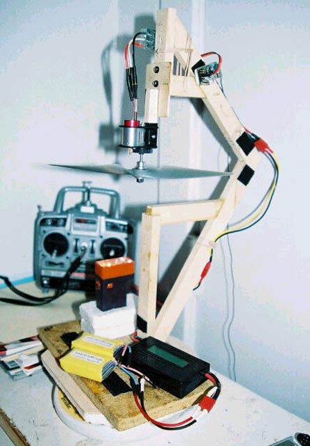

I want to measure the voltage, current and thrust being produced by various combinations of motor prop geaerbox etc.
I can measure the voltage and current easliy enough but I would appreciate ideas, or references to sites, which shows the different ways of constructing a device to measure the thrust.

A simple spring scale, attached to the tail of the airplane, is typically what you'd see used to measure thrust.

Here's a link to a long complex thread which does include instructions and pictures for several types of thrust stand
http://www.radiocontrolzone.com/foru...hreadid=116059
I've attached some photos of my system - referred to in this link above.
Cheers, Phil

Get a stick, mount it vertical in a baseplate, strap the drive (or plane) to the stick, set it on a scale and weigh it. Power it up and the difference is the thrust.
