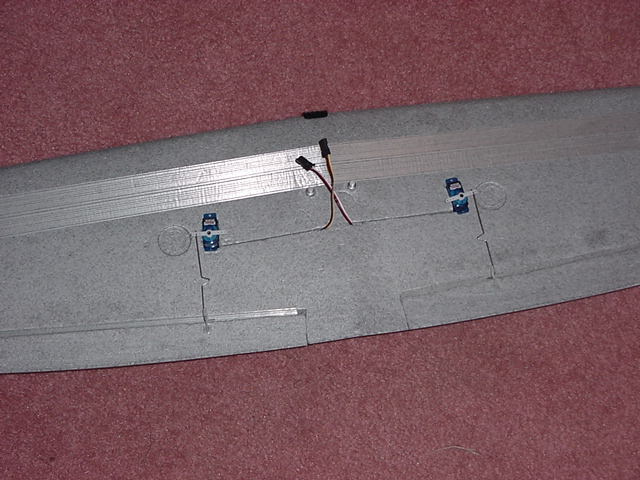

Here's a pic of how I reinforced the stabilizer. It came off on my first landing(not crash!). Any ideas on strengthening the wing mounts? The inserts pulled loose after a couple of flights too. I re-glued with more epoxy this time but it still seems weak. Also will post a pic of my aileron setup.

This setup works well. There is more weight in the Y harness than the servo adds. I will trim the Y harness and get rid of 80% of the wire. Also, thoughts on the down thrust angle. Seems to pull mine down when I go full throttle. Wouldn't ballooning up in altitude at full throttle be a positve thing in a model like this?

I like how you did the ailerons. How did you hinge them if you don't mind me asking. Did you gut a simillar bevel as the rudder and elevator, or did you completely seperate them and then tape them back on?

The ailerons are cut, then I beveled the wing. I taped them with 3/4 strapping tape on top first thenfolded the aileron all the way up and taped the bottom all the way up to the top tape.
Let us know what kind of performance you get with that motor! Climb rate, flight times, ect. Oh, prop selection also.
