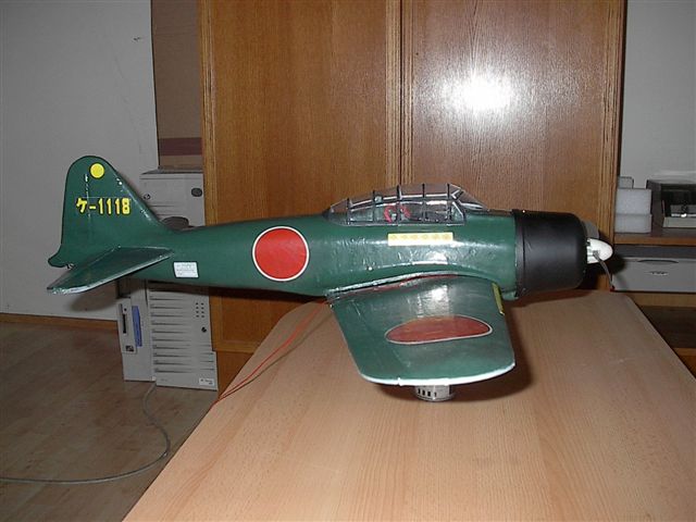

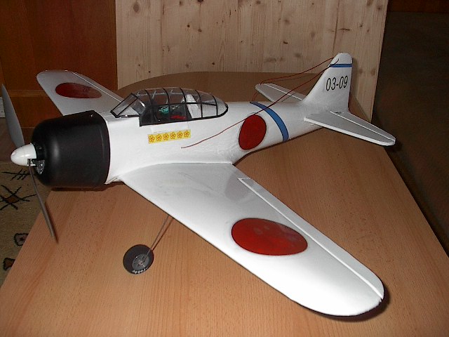

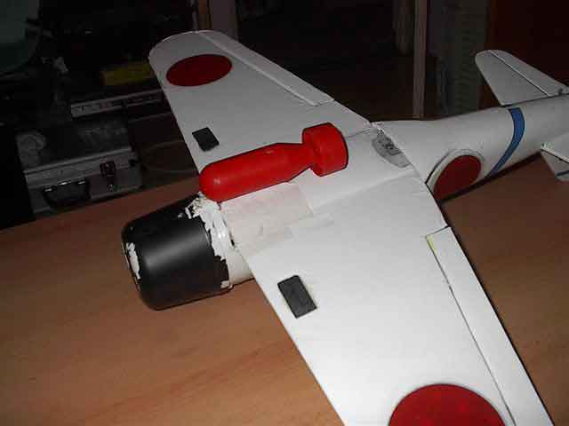

Congrats to your Zero. I have two flying. One Oracovered one and a glassed one. The oracovered one has a droppable bomb.
Both are running a Typhoon Micro 15 on 8 KAN 1050's on APC 9x6 = ROCK AND ROLL! I had to cover/glass them because the high speed caused Zero #1 losing the wings in flight. Tore them apart in the center.

Alright, I just got in from flying at lunch, she's got everyone here at work wanting one now. Saw your pics, nice job!! I love the idea of the bomb drop. I haven't tried different props yet, today I was doing outside loops and flying inverted, no problem. But it doesn't hurt to try out other sizes and maybe pickup a few rpms of some other benefit.
