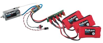

I'm building a CBM a-10 with twin electric ducted wemotec midi fans. What I would like know is if 2 of these powerplants will be adequate to power the plane (it will have full retracts)
And if so, how do I control 2 motors - would I just use a Y connector, plugging both speed controls into the receiver?
Any help is GREATLY appreciated!

LiPo Propulsion Pack with KOK1500HC-2S3P, FMA ASC30 Speed Control, and Speed 600 (7.2V) Motor.
Ratings: 7.4 Volt Pack
Outputs: 4500 mAh Pack will Handle up to 36 Amps Continuous Current
Applications: Speed 600 Powered Electrics - Direct Drive or Geared.

If they are brushed motors, you can simply wire them in parallel to the output of a single speed control. Bear in mind that this ESC needs to have TWICE the normal rating, because two motors means twice the current going out to them. If, for example, one motor drew 10 amps, the ESC would need to be rated for at least 20.
If you already have two ESC's you can connect things with a Y-cable, as you suggested, but I think you have to remove the red wire (whichever one carries +5v) from one of the receiver connectors on one of the speed controls. The receiver cable carries power to the radio from the BEC (battery eliminator circuit) in the speed control, and you don't need twice the normal power to the radio- just to the motors!
Steve
Steve
