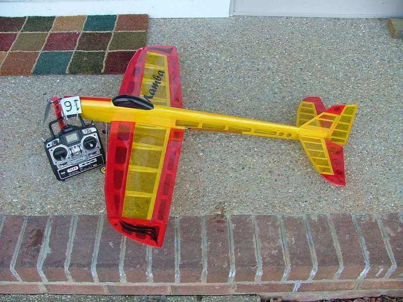

I am putting together a Mamba and need help with a prop. I am using the MP Jet 25/35 with a 4:1 a Phoenix 25 and a 3S2100Ma/h
thunder power battery. I know props for 40 , 60 and 1.20 size glow but this is my first E power model. I saw the review in Fly RC and they used a 3:1 and a 10x7 on the same plane with nicads.

On a recomendation from a club member I downloaded Motor Calc and it gave me a 9x 4.5 - 9x6. I had guessed a 9x6 and that is what I will try first if my rec ever comes in. I have both the APC electric 9x6 and the APC 9x6 slow flyer props. What is the performance differences between the two styles?

My Mamba is ready for flight. The 9x6 turns 7700 rpm. Suitcase and I plan to fly tommorow. I haven't flown since Nov some I will get a few flights on my US 60 first.

Here is the picture.

After trying many different props the one I liked the best is an APC 10x7 Slo-flyer. This E-power stuff sure is catching. I got in a flight on the way home from work last week. All I had to do was plug in the battery turn on the Transmitter and fly. No fuel no tools no hassel.
