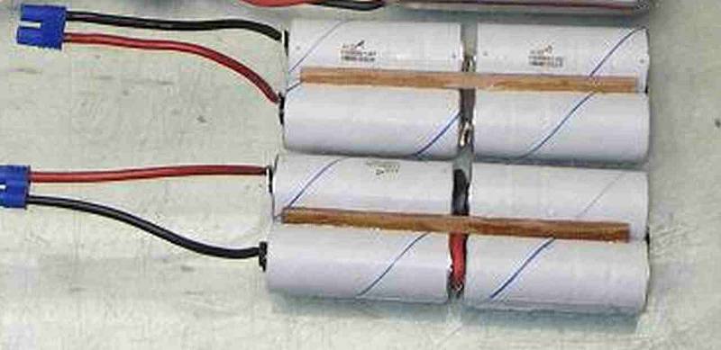

Would 2100 5s2p or 4s2p A123 packs fit in a Pulse Xt 40?
I think this is two possible pack configurations
4 x 2 x1
66 x 4 264mm lenght
26 x 2 52mm wide
26 x2 52mm height
70 x8 560g
2 x4 x2 pack
66 x 2 136mm length
26 x2 52mm wide
26 x2 52mm height
70 x8 560g

not sure bob the size may not let me get a good cg on the plane .I am going to go with the 18.5v 4000 pack if it does not work I will try the 14.8v 6000 pack.
My Li-ion batt. measures 114mm long, 70 wide and 40 thick with the velcro that holds it in and it's a snug fit. Close as I can get for the compartment is 130 long but there's a small half former to brace the undercarriage that's 100 mm back from the firewall. My batt just slips under it. 80 mm wide and 50mm deep. Hope this helps.

Looks like it is going to be a tight fit. 136mm x 52mm x 52mm this based on bare cells. I am sure what finished packs would be.
How heavy is your pack? A123 would be 560-570gs
