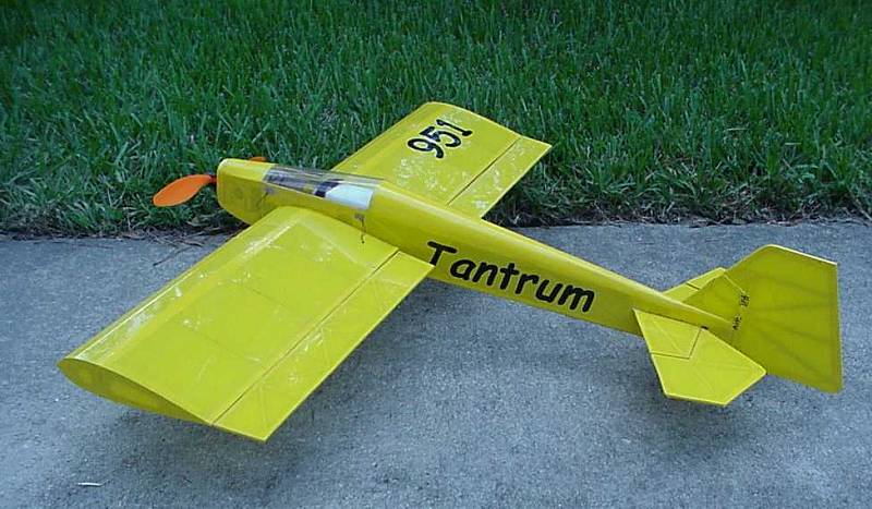

IMHO on small models pull-pull gives you much more positive control and at a lower weight. Of course this depends a great deal on setting up a pull pull system. My Tantrum has been flying with pull-pull (per design) on rudder and elevator for four years with no problems.
