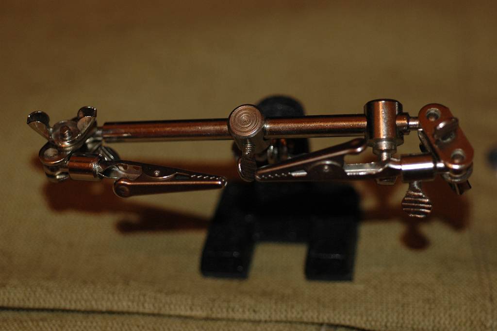

Default RE: soldering question
I have been using this small gadget to help hold two tinned wire ends overlap to each other. The a touch of the soldering gun tip will join the two nicely.
A tiny bit of flux helps both tinning and joining. Do need to wipe out the flux residue with a piece of soft paper.

Old 06-27-2010 | 09:29 PM
