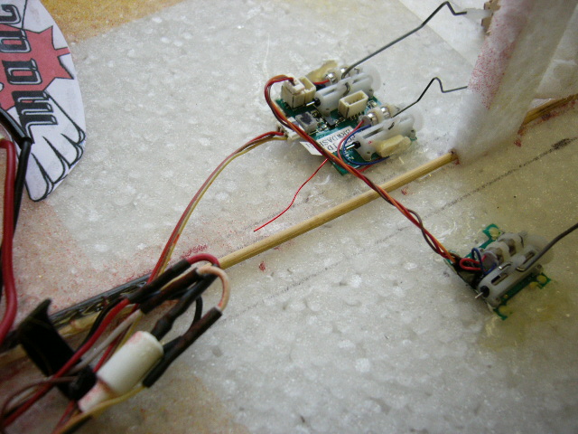

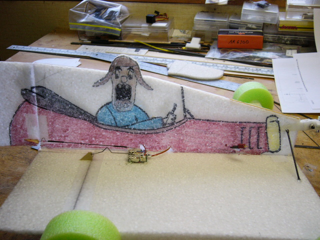

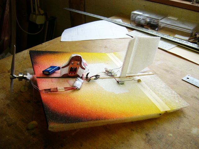

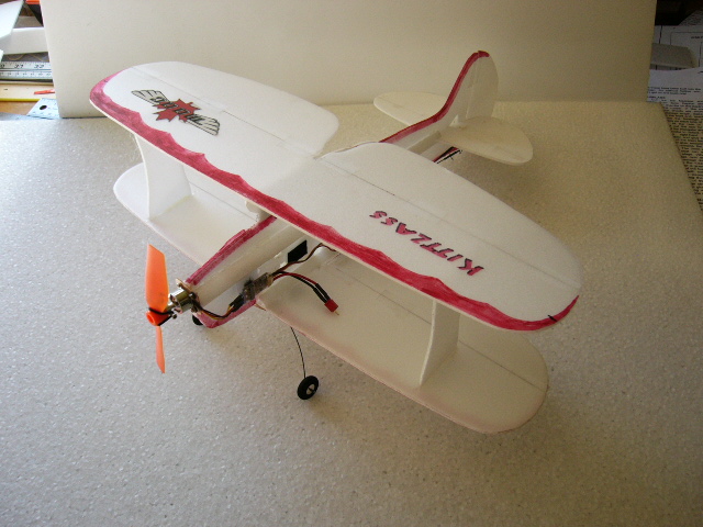

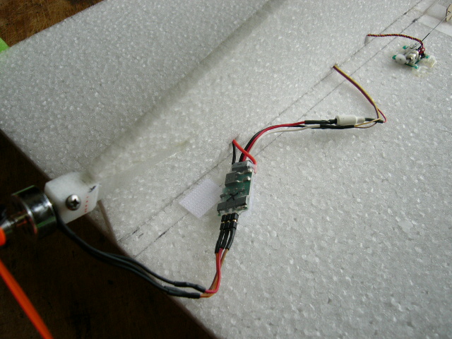

I have 4 of them in use. As said use a diode to drop the voltage to the rcvr and servos.You can see the lump in the wire on the PBF which is the diode. Going to 2 cell snd brushless wakes these little suckers right up. The Kittysass bipe will accelerate vertically out of a hover with lots of poop.

Would be the same setup for brush type ESC. Cut the +,red wire on the ESC that goes to the batt. and install the Diode with the white ring on one end, towards the ESC. You can get the diodes from Radio Shack. The package I have says EPOXY RECTIFIER 3AMP/400 TIC. The power to the motor jumps from 3.7 to 7.4 volts. You will likely need a different motor that will hande the higher voltage. Hope this helps.

The diode goes on the wire from the ESC to the rcvr dropping the 5 volts to roughly 4, which the rcvr can handle with no problems. The full voltage, 7.4, goes to the motor wires from the ESC.

I think I see the problem. You bypass the ESC in the rcvr and use the external one as shown in my first pic. You use the rcvr as a normal one without an ESC. If you don't have it already, the Spektrum website shows, under the AR 6400 rcvr. you can download a page to reprogram the rcvr. to do many things. It tells you where to apply the power from the ESC and where to connect the ESC to control the throttle speed.
