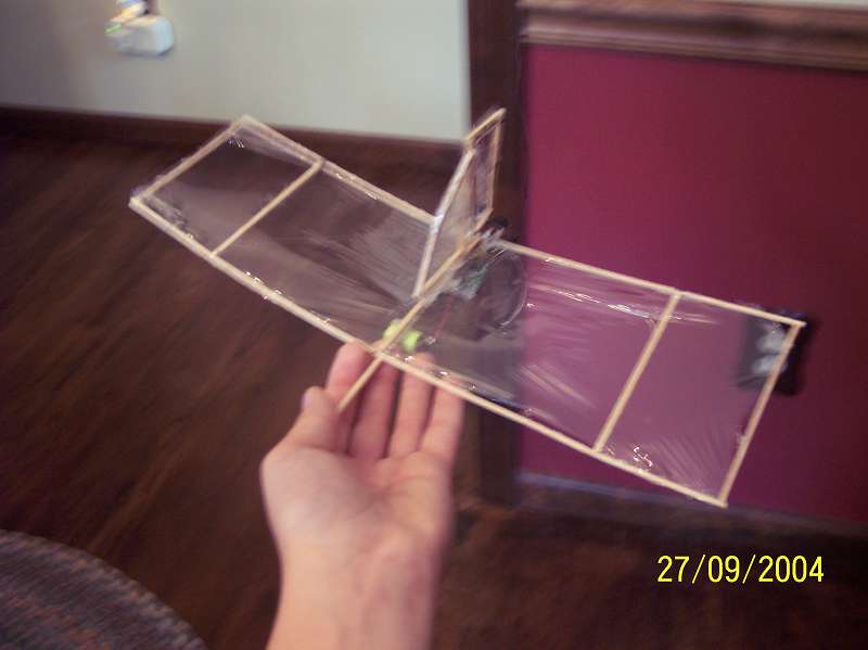

i want to try and build a micro flyer, it will be for a school project, does any one have plans or very good hints and tips for a 10th grade physical science student

do you really want to invest $200+ for a project??? A micro rcplane will be easy to build, some sticks and plastic covering, all set. The expensive part is the radio, receiver, mini-servos, expensive charger for the little batteries (Lithium Polymer cells) you will need.
Lets start here, what is your project outline? What must be accomplished? What is the instructor looking for?

it's got to be able to fly (duh) and have pretty good directional controll,
im thinking about making mini coil accuators to replace servos, and using a reciever from my microsizer.

Micro's are too difficult for a beginner to keep stable. I'd suggest looking at the Slow Stick and maybe scale it down slightly and use the GWS Rx with their Nano servos and speed control. We fly all the sizes at our winter indoor sessions and even the experienced pilots have a hard time keeping the micro's under control. It's not worth the extra expense unless the project has to be under a 16" WS.

i think you could at least try, it wouldn't bee to expensive using the reciever and transmitter from a microsizer, and just because a plane is small doesnt mean it is harder to control, some micro planes can fly like trainers.

Modifying a micro car has been well documented. Look here: http://www.rcgroups.com/forums/showthread.php?t=84771 and check out the threads listed under 'RC Car Conversions'. There are a lot of possible mods to get enough range and power from these little units. Do some reading, solder up a few parts and you are ready to go. The only draw back to these is they have limited range, limited number of functions, and almost all are 'bang-bang' systems (where controls are simply on or off, banging from one side to the other). I prefer real, proportional micro R/C gear myself, but for a school project, you may find it is just the ticket.
If you already have access to a real aircraft transmitter, you can get the RFFS or JMP RX for under $100. These radios are proportion control, 3 (or more) channels, and use actuators (kind of like in the micro cars)
Some of the motors in these little cars are quite adaptable to what you want to do, although most require making up a gear box so you can turn a reasonable sized prop. The 'pager' motors with gear boxes (like the PU-04 from Falcon, available in the US from Bob Selman Designs) are quite powerful, draw 1/3 amp and are less than $20.
Depending on how much room you have to fly your creation, you have a number of plane choices. The Guillows 16" Prairie Bird or One-Nighter, or most other similar sized rubber band FF models, even beefed up Penny planes are quite suitable for light weight R/C.

If you do want to drop 2C+ on a micro project the Super Skeeter is a foam winged, carbon keeled, almost ready to fly micro that is far more durable than the balsa Skeeter kit. It doesn't glide quite as well with its thick foam wing compared to the original balsa sheet wing but is indestructable by comparison and handles very well.
The magnetic actuators are already installed and pushrods finished. Mount the battery and RFFS-100 receiver and wire it up. I got the base loaded Mini Antenna. Its about a foot shorter than the 18" standard. Charge it with a lipo charger and fly it.
Order it with your channel- its a teeny crystal- so you can use your tx. In your line of work I recommend a buddy-box to spread the airtime. There is nothing like a slowflyer for teaching people to fly.
