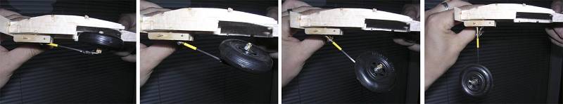

I´m building a 16,5" Guillows P-40 Warhawk for e-flight. I have been working on it for two years or so since I want to have retracts and flaps (yes I know, it´s a crazy idea). It took me about a year to develop the retracts since they have to be ultra-lightweight and since they have to turn around its axis 90 degrees while retracting... now I have a working prototype and I am currently building the final versions of the l.g. I will cover parts of the plane with 0.4mm balsa for strength and cover the whole plane with tissue. Since it will be quite heavy, it will probably be quite fast and demand relatively much power. I will probably install a miniature brushless motor and Kokam 360mAh 20C Lipos.
Andreas
Wez
Can you give some details and maybe post pictures of those rotating retracts you have developed?
David

Hello David,
I will try to take some pictures this weekend.
Regards,
Andreas

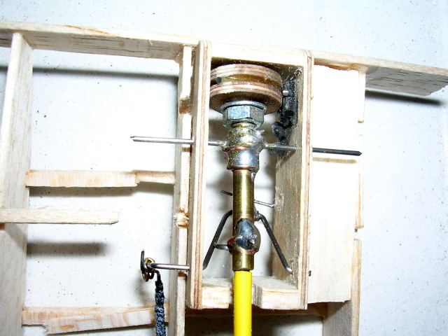

Hi David,
Here are the photos of the prototype retract. Sorry for the delay...
Regards,
Andreas

Looks great Andreas! I need to study the pictures more until I understand the operation. I may be asking more questions as you move along. Please keep us posted. You might consider a retract construction thread of it's own.

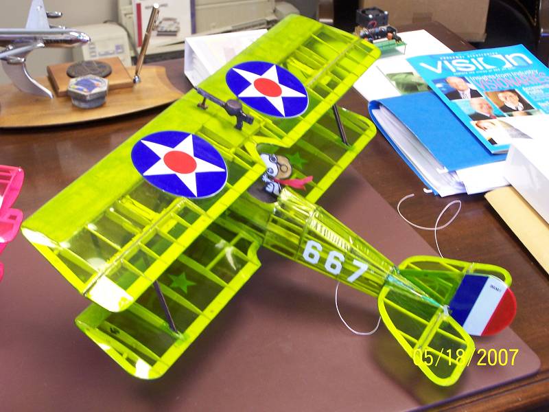

I recently converted the 20" Dr1 to four channel electric RC and flew it last week. I first built this model as rubber powered and tissue covered in 1966. I later had a two channel Kraft radio (1971) and thought how fun it would be to fly the little triplane as an RC model but at that time only Dick Tracy could do two way TV on his wristwatch! After building my first all electric (40" Dumas L-19) I dug out the old Dr1 plans and looked at the lipo/brushless/radios available today. The following is the result of about 40 hours of redesign/build time and some carbon fiber etc. I also had the Scout plans from the old days and my friend built it (can you say dog fights). They are not fully complete but the Dr1 comes in at 8 oz/ft2 and the Scout is 7.2 oz/ft2. Both use ThunderPower 765 mAh 2c lipo's driving eflight 250 brushless outrunners with 6/5 gws props (going to try 7/5 apc's). Castle Creations 9 amp esc and 4L reciever with eflight 6 gram servos complete the setup. Both fly very well with straight wings (the Dr1 will climb vertically and is very happy inverted). The Scout wants an upgrade to the 300 eflight outrunner to keep up with the Dr1. Close attention to keeping the CG forward is important for a low all up wieght given the short nose typical of WWI designs and who needs all those ribs anyhow. I don't recommend either bird for beginning builders or flyer's as both aspects of these planes is not for the faint of heart.

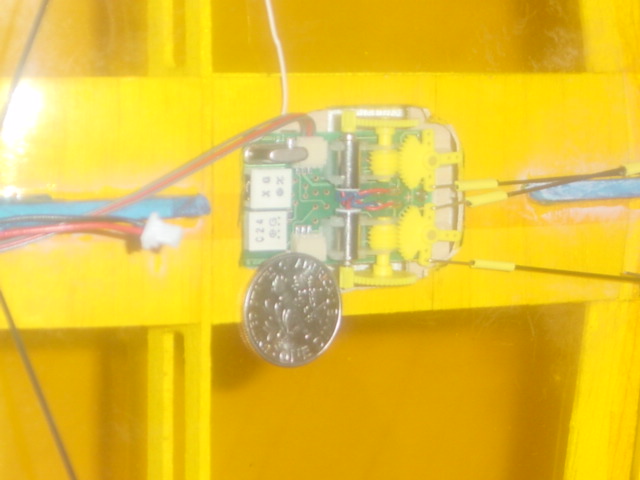

i have all the electronics ready for the stuka to place in, but i have no idea on how to make the ailerons move. a control rod cannot bend.

In spite of your tag-line, you may want to look at the thin teflon tubing (sold as CA applicator tips) for guides, and music wire (as in unwound guitar strings, available in sizes from .008" up) as pushrods. You can make 90 degree arcs that move smoothly was minimum slop. I used this on my 18" Stick and Tissue Albatros in the upper wing and drove both surfaces with 1 Micro Joule/Nuke servo.
Here are two pictures. The first shows the Micro Joule servo mounted in the wing. The servo arm engages a brass rod the is in turn heat-shrink wrapped to the piece of guitar string (I think this was ~/010" dia.). The string runs through the clear teflon tube that is attached to the front of the front spar; the tube was installed in one piece and the center section cut away. The bend can just be seen through the tissue in the other photo. The ends are still wild, but the ends of the wire will be attached to short 'Z' bends that engage the control horns; heat-shrink connections let you adjust the surfaces then a touch of CA at the HS locks it all in place.
