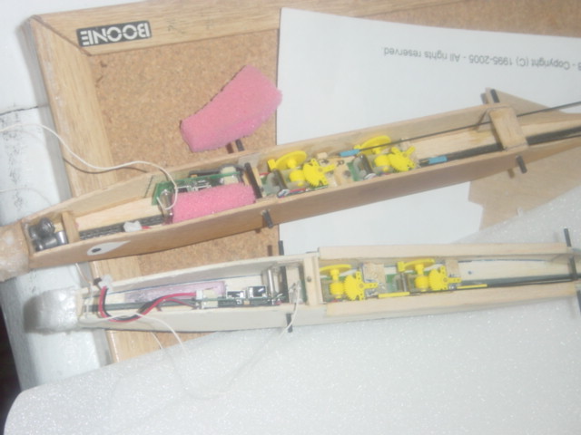

Since then Falcon (in the UK - http://www.falconmodels.uk.com/ ) has developed a much better system that is about half the weight of the MJ gear. Their line includes the 'Breeze' block which is a receiver and two integrated servos (4.8 grams with crystal and antenna), a descrete RX (1.8 grams) and incredibly simple and light 1.6 gram servos, a selection of 1 gram 1.5 amp ESC, brushless ESCs (<2 grams), and batteries that all have their 'IDC' connectors (about 1/3 the size of a mini-JST); all of their gear simply plug together.
Here is their photo of the 'Breeze', which measures 1" wide:
The servo is 1/2" x 1/2" x 5/8" long:
Here are two of my own poor photos, one showing the servo on a dime, the other shows two gliders that are 9/16" wide through the pod; the gliders use the descrete components. If you would like more info on these, just ask...
