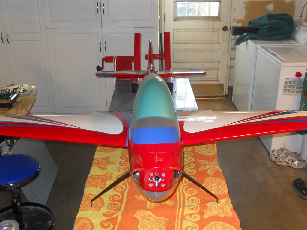

I made some progress on the Sickle over the weekend.
-Richard.

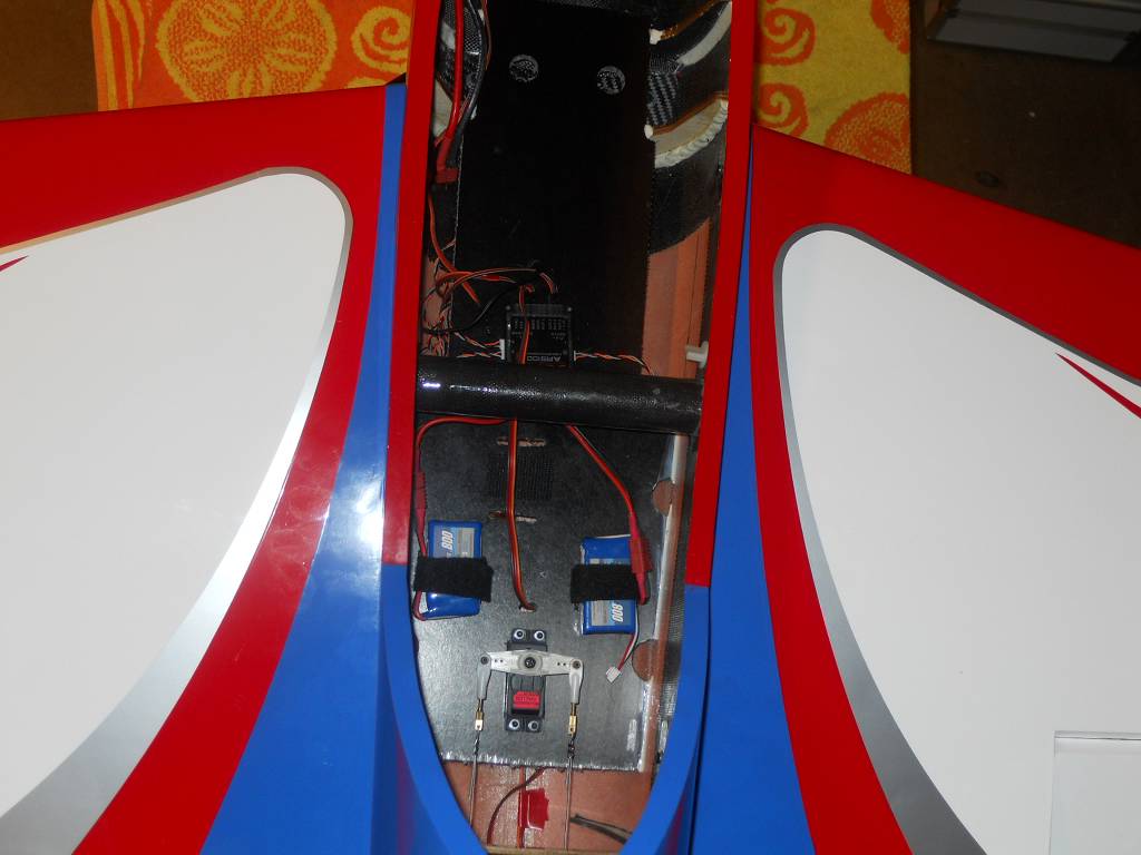

Some additional shots.
Lookin' good, Richard.
May need a couple more breathing vents for that Axi.
The front mounting certainly looks like a lot less trouble to install than the firewall needed for the Himax, Plettys, etc.

Bob,
I was going to square the pilot holes up at some point to get more air flow through the motor.
This is one of the few front mounts I have had the pleasure of setting up, and they are just a little easier.
-Richard.
