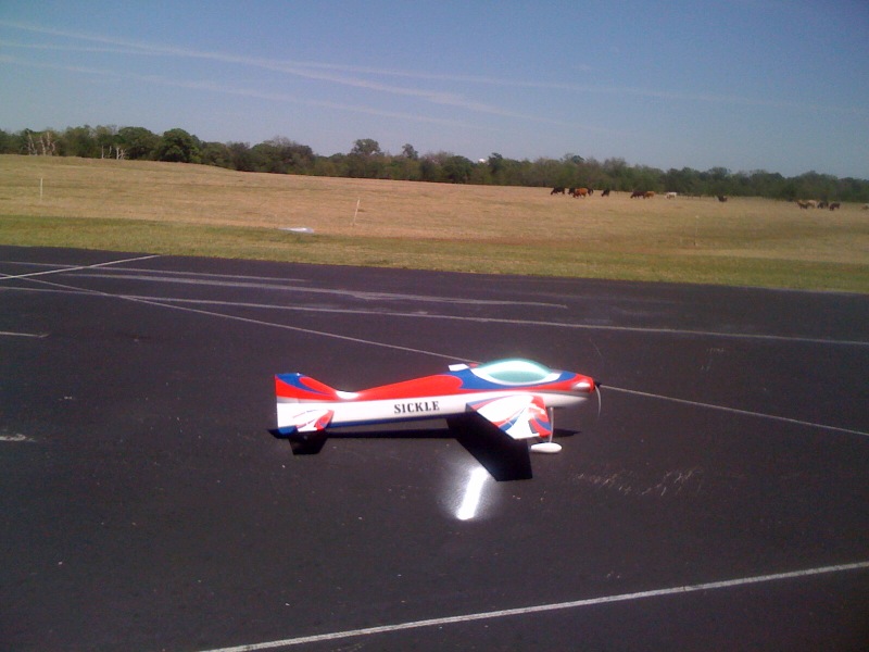

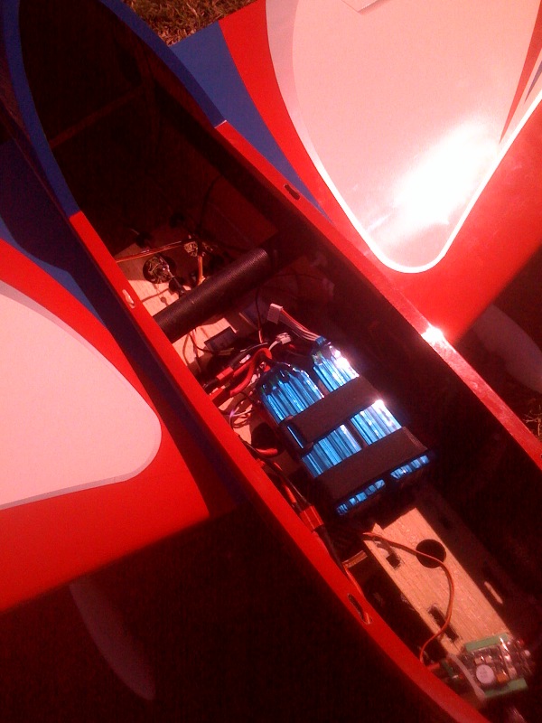

I'm heading out to the field now for the maiden.
My AUW with f3aunlimited packs is 4853g. The weight without packs is 3656g.
APC 20.5X14 prop
carbon fiber spinner
(2 )36" extension cables (I'm using all pwr & signal wires)
AeroTech dual battery reg with switch
Castle HV85
Panel mount arming plug (12AWG wire)
Series Battery Connection cable 12AWG (Ties (2) 5s in series, I need this because I use the Celpro PL8 charger)
(2) 480mah receiver packs
1/8" plywood nose ring motor mount
I chose not to use any carbon fiber sheets for servo tray, battery tray or nose ring motor mount.
Glen

By the way, as Bob mentioned there are hard points in the stab for a small screw to go into the stab tube. You have acces to the hard point from the top or the bottom. You just have to locate it through the covering.
OK now I'm off to the field for the maiden. Or... I could just sit hear and stall.... naww I'm outta here!
Glen
Glen

Too bad you can't charge the batts while leaving them in series. That might save you more than an ouce right there, depending on which harness you're using.
I decided to use the MPI power pole arming switch, but cut the ESC and battery connectors off and simply soldered it into one of the ESC leads. Total weight penalty after that was 14 grams vs the 32 grams without the mod.
Good luck on the maiden!

I got one 4 minute flight on the Sickle this afternoon. Before the flight I had one of my pattern buddies help me check the balance. It turned out to be way to nose heavy whith the batteries in the location I had them. We moved the batteries as far back as as the mounting plate would allow and still be secured but it was still nose heavy. I determined it was safe to fly it so I got the maiden out of the way. I've got to rework the battery placement to get them further back. Here are some photo's the last one is the location of the batteries when I flew.
Glen
Glen
