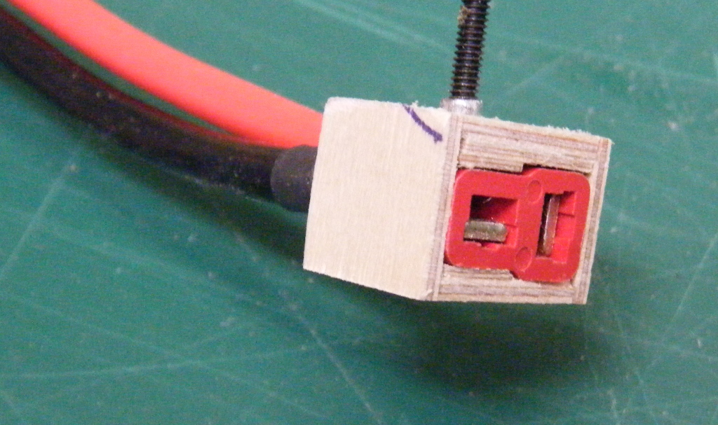

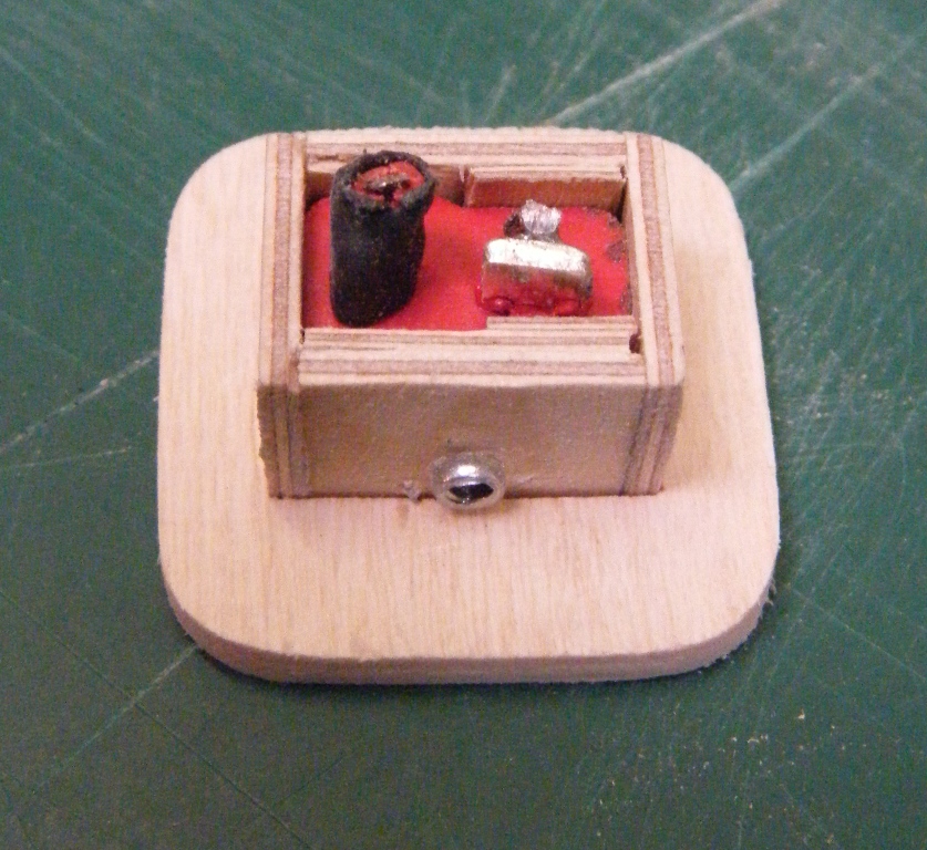

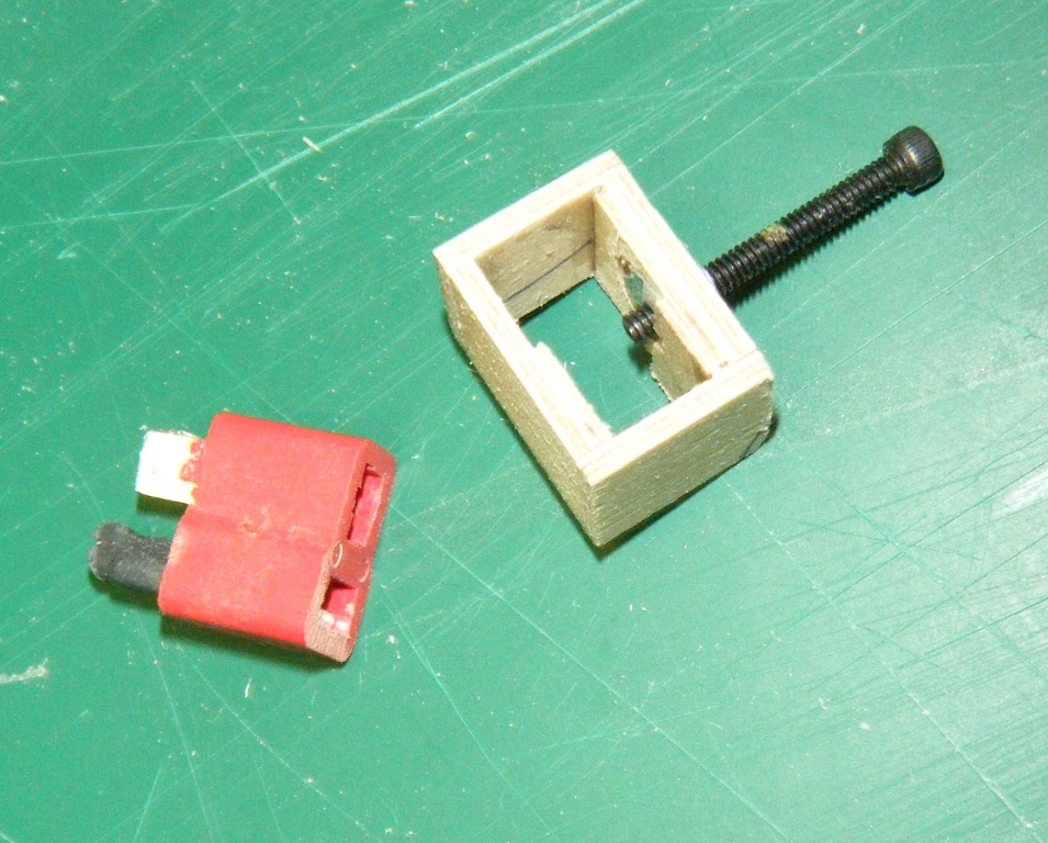

Odds and ends...
I use a Dean's Ultra connector as an external arming plug. I want a jack that I can remove the plug to take the speed control out of the airplane. I have not found any suitable jacks for this application and the one I have on my current airplane is marginal (it can be removed, but needs a little glue to stay in). Here is what I built out of some 1/16" ply, 1/8" lightply, and a 2-56 blind nut. I will use a shorter screw that the one pictured, that is just what I had on hand. This assembly is glued to the fuselage side, and then a hole is cut out of the side in the shape of the jack.

Please build a second one for me. We can install it tomorrow in the rain.

Hey nice work on that plug box! Maybe just a teeeeeny tiny wrap of carbon fiber around the box when your done? The fuse is seriously looking great too.

JR,
That was my thought going in, but once I put the box in the lightply, it was plenty strong. It binds the entire jack together.

ORIGINAL: Shimano
Fiberglass might be better... carbon is conductive....

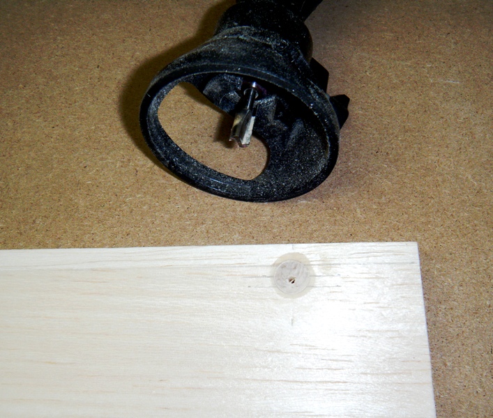

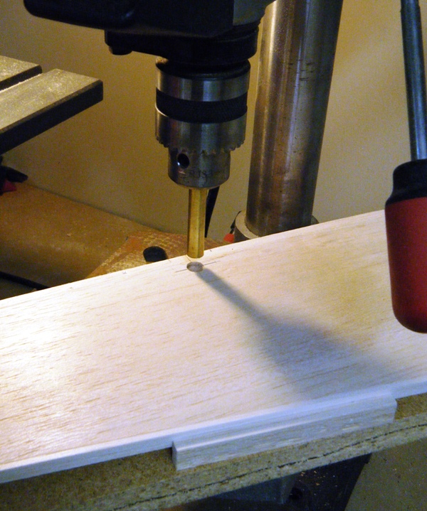

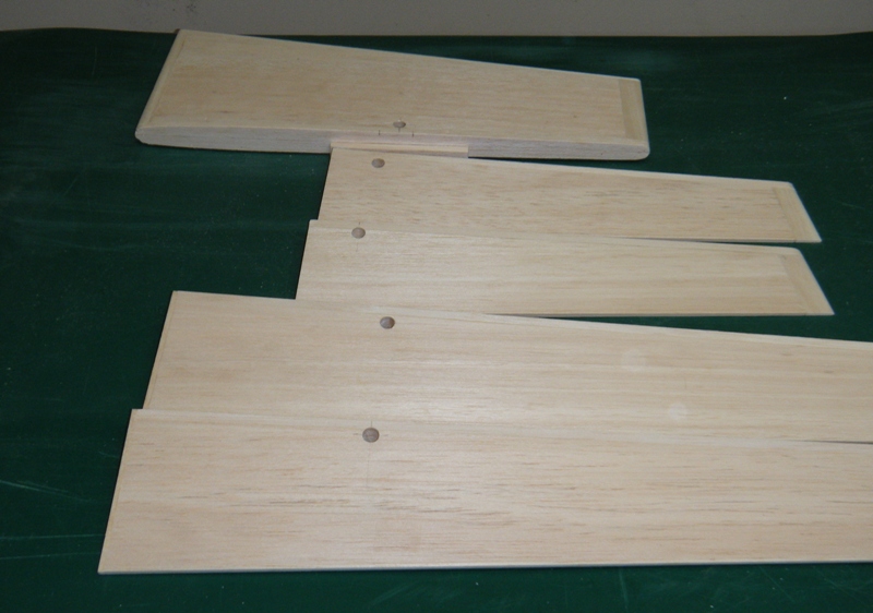

I use 3/8" dowel hard points for the control horns. To cut the holes, I use a sharpened piece of brass tube in my drill press. Once the holes are cut the dowels are epoxied in. After that cures, I use the Dremel router attachment, with the bit set flush, to shave off the excess dowel. Once that is complete, I use the drill press to drill the hole in the hard point for the control horn.
It is getting close to time to put away the 60 grit and get this thing fine sanded, glassed and painted/monokoted!

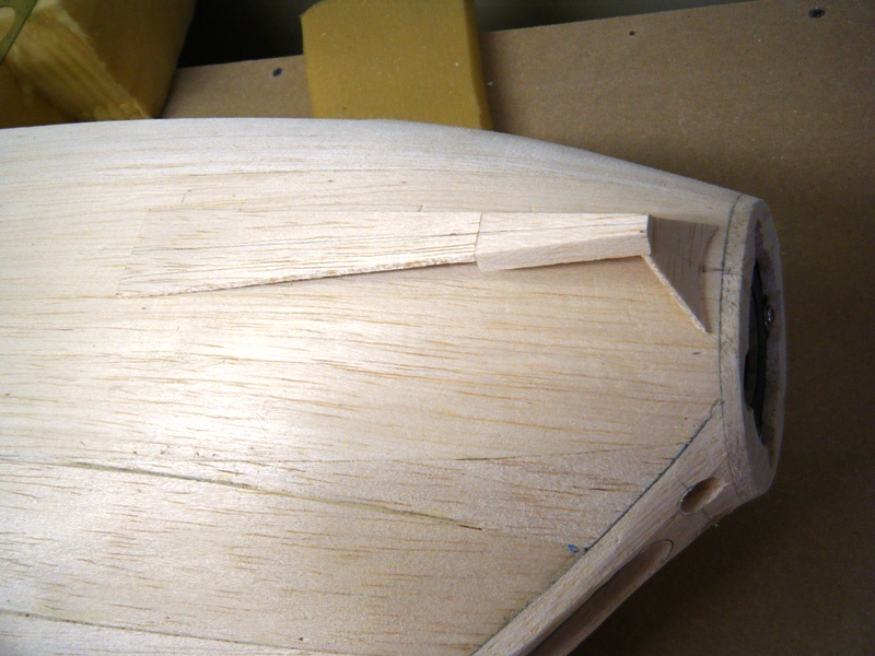

The check cowls are made from ¼” balsa; this leaves plenty of meat for sanding to the desired shape. There is quite a bit of shaping that goes into getting them to fit the contours of the fuselage. The pictures show them squared off, but they will be rounded off during final sanding.

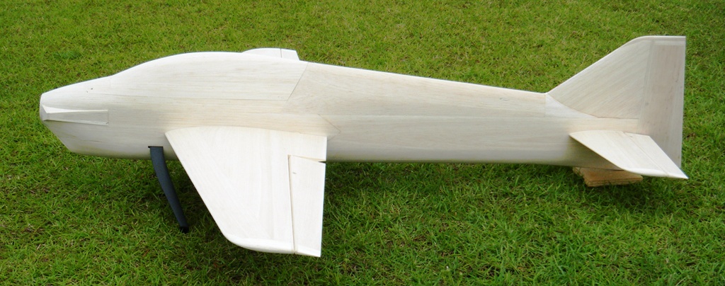

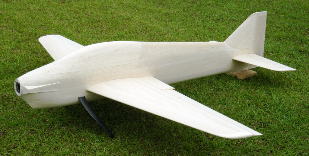

The Lightning fully assembled for the first time:

Final weight projection?

Based on comparisons with the prototype at the same stage, I am estimating 10 lb 10 oz. Weight has been under the curve for the entire build, but I can't get lazy now. That "I have plenty of weight to spare" starts to creep in. I have a fairly detailed spreadsheet with weights for almost every piece that has gone into this airplane, although I admit to gluing a few in prior to weighing.
