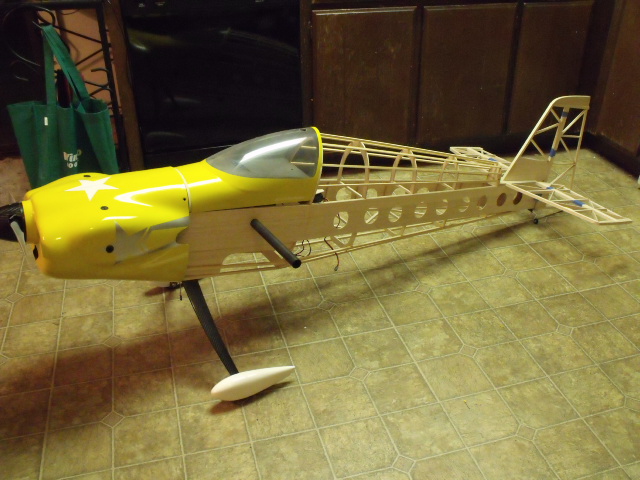

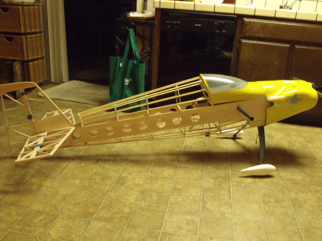

I caught the last pattern contest at my local club last year and decided to build a 2X2M Laser for pattern competition in 2011. With all the rain we have been having I have been able to make some decent progress. The fuse is all but done and I spent most of this morning on a motor mount. The gear I ordered is too long so I am going to move the gear mount up a few inches. At this point with everything pictured including two 5S 5000 MAH batteries it weighs 6.8 lbs. Getting concerned about the weight.

Maybe is because your plane is sooo.. (cough cough).... "unusual" since the actual trend in F3A.
I suggest you to riconsider totally your way of mounting the engine. I think it's a litte under designed for the massive torque of these motors. Try to take advantage of the full width of the firewall.

Keep posting the build photo's, it was not that long ago when we first went to the two metre rules that there were quite a few stand off scale types getting around.
It may not fly as well as a purpose designed F3A, but if you enjoy it, and it gets through the sequence, well that's what it is all about.
I would have a good look at the mounting as Roberto suggested though, it could undo all of your good work if it is not strong enough.

ORIGINAL: Roberto B.
Yes it is a bit unusual but my hopes are that it will fly well enough to be competitive up to Advanced class in my region. I do still fly IMAC and wanted a pattern airplane that flies simular. I will investigate the mount a bit more however it is much mose sturdy then the mount the motor came with. My biggest concern right now is the weight.

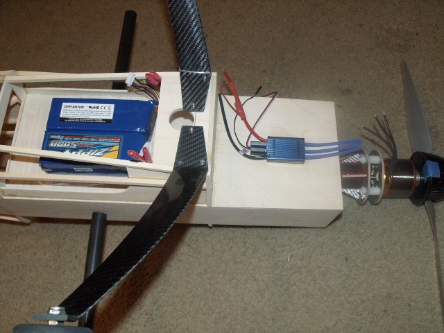

Are those nylon bolts with nylon standoffs and nylon locknuts for the motor mount?

ORIGINAL: Ryan Smith
yes that is nylon hardware. I am a little surprised about the responses I have been getting about the motor mount. If this were a gasser, I would never have attempted a mount like this but being electric I think it will work without being over built. I work in a composites shop that builds military hardware and the techniques in that mount are utilized inthose productsquite often. All the glue joints are a high grade epoxy with milled fiber added and heat cured at 180 degrees. Themating surfaces were abraded well and cleaned with acetone. I will however be doing some stress testing before the motor spins just to be on the safe side. As just a little side noetpeople have been mounting 150-170cc engines with 1/4X20 stainless hardware for years without problems.

1/4 - 20 stainless and 1/4 - 20 nylon are totally different. The sheer numbers aren't in the same world. I would not use nylon for this purpose, regardless of the size.

ORIGINAL: speedracerntrixie
...I am a little surprised about the responses I have been getting about the motor mount. If this were a gasser, I would never have attempted a mount like this but being electric I think it will work without being over built.
Ask and ye shall receive. The only reason I mounted YSs and Hyde mounts with 6-32 screws was because the mounting holes were too big for 4-40. I don't ever use nylon in any shear application, and that's what you'll be getting with the torque of the motor.
I know I don't doubt the construction integrity of your motor mount, and it's doubtful that others on here do as well. The the professional appearance of the construction of the mount is a testament to your composites background. I just think the thing is too damn complicated. It's neat, appears to be built well, and is definitely outside of the box thinking. However, I think most would agree with me that you would have been better served to extend your motor box sides a couple more inches further forward and bolted the motor directly to the firewall using standard (4-40, 6-32) hardware.
My only other comment regarding the airplane is the batteries appearing to be mounted in the bottom of the airplane. From what I've seen, this is not the optimal arrangement. Primarily for a lazy person, like myself, I don't like flipping my airplanes over. To have to do that every flight stinks. Secondarily, and probably more relevant to the discussion, I've never been crazy about the way pattern planes fly with the batteries so far off of the fuse centerline by being bottom mounted. I've seen several Japanese pattern planes that were retrofitted to electric with batteries in the belly pan, and I did not like the way that any of them presented. The airplanes all appeared to fly with the nose down and did not track straight. My thoughts are that this is a function of vertical CG. The same aiframes that were either glow powered, like they were originally intended, or that were modified to have the batteries sit closer to the fuselage centerline appeared to track much better and the fuselages sat at a better angle in straight and level flight.
This commentary is worth what you paid for it. I am very impressed with your work, as you appear to be a heck of a craftsman. Kudos to you for taking the path less traveled, as well as utilizing a design that has fallen out of favor due solely to its lack of being flavor of the week, on top of adapting that to a 2M airframe.
Good luck with your project, and I for one look forward to seeing its progression.

You probably can save some weight by not sheeting the fuse all the way to the tail, to avoid secifically the "tail weight". Some weight can be saved also if the turtle back is constructed by some lighter/thinner wood or foam.
There is a 2m wood pattern construction article on AMA a while back. It is for gas power but should give some idea on how to save weight.

I hear you about having to flip the airplane over to install batteries. I was going to make a stand to ease this. The biggest reason I went to the belly was it seemed that I would be able to get the most airflow across the batteries and controller. Obviously I did not consider the vertical CG. It may be difficult to to tell from the pictures but the batteries are actually 4.25" below the wing tube ( Center of battery to center of tube ) it you feel this is too far off the cernter line then I will take your advice and move them to under the canopy and work on getting better airflow to them. I am also going to construct a couple more plates with the nylon hardware and see just what kind of shear force it takes to make it fail. starting over again I would extend the firewall. I originally intended to use an OS 160 . After seeing and talking with a few of the pattern gurus in my district I made the jump to electric.
Nonstop, The fuse is actually quite light. Without the motor mount landing gear it is 1.9 lbs. The fuse is not really sheeted, the 3/32 balsa sides are structural, The fuse is built with these sides as a box if you will with cross bracing to eliminate flex then the formers and stringers are added top and bottom. The turtledeck us 3/16 square spruce stringers with the formers being 1/8 med balsa. I did consider a balsa sheeted foam unit because it would look much nicer but in the end the stringers were chosen because it it lighter.

Vertical CG would have nothing to do with what angle the fuse is in level flight. In fact, lengthwise CG has very little to do with that. The only thing that will control the angle the fuse flies at will be the angle of incidence the wing is mounted on the fuse. But Vertical CG has a lot to do with what the model will do in a vertical upline. Most models that have been originally designed for IC engines need the batteries in the belly in order to have the vertical CG in the designed location. Think about the IC engine cylinder sticking down, then the exhaust system on the bottom. If the packs are located too high, the model will pull to the canopy in an upline, requiring more downthrust.

Where did you mount the batteries for your Partners?

I suppose the final resting place for the batteries will be determined to where they are located in some of the current F3A airplanes in relationship to the wing tube. The good news is depending on where the batteries sit to get proper CG may allow me to try both locations. I have been flying a 50cc Laser for a little over a year with the engine inverted. Initially on an upline it did tuck to the gear. A tad of up thrust cured that but I do wonder everything else being equal if the CG was closer to the thrustline would it have tucked? Of course airplane trimming is a whole very long topic in it's self.

Hi Ryan,
I first mounted them up near the wing tube. The model pulled to the canopy in an upline. I moved them to as low as I could get them, which with the way the gear mounts in a Partner is pretty low, and the pull went away. No other negative things felt when I made the change.
