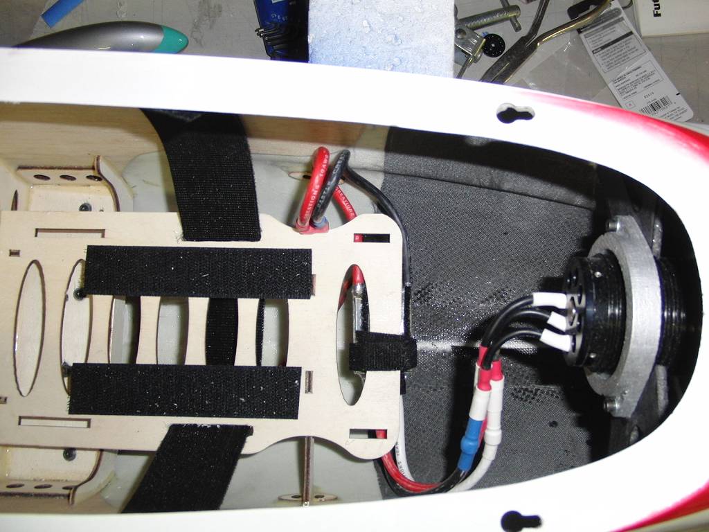

Dick,
Here are the pics you asked for..
nonstoprc,
I use the same as pattratt the SmartFly 6 volt pattern reg and a FlightPower 800 I dont use dual regs and batteries but I do know some guys do

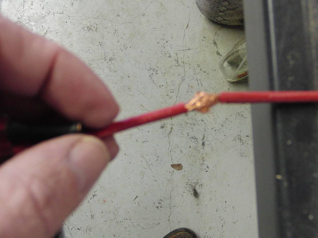

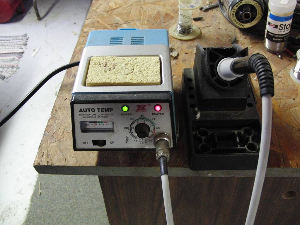

I like the way these wires are soldered together. Can you describe the way it is done? I used 4mm bullet connectors for the purpose. Thanks.

Todd
Thanks for the Pic's. I like how you mounted the speed controller. Any issue with cooling in that the heat sink is not parallel to the flow of air from the cowl? I am guessing my natural C/G is slightly more nose heavey than yours as I have two less servos in the tail due to no split rudder.
I will have mine finished this week and will post final weights and Pic's.

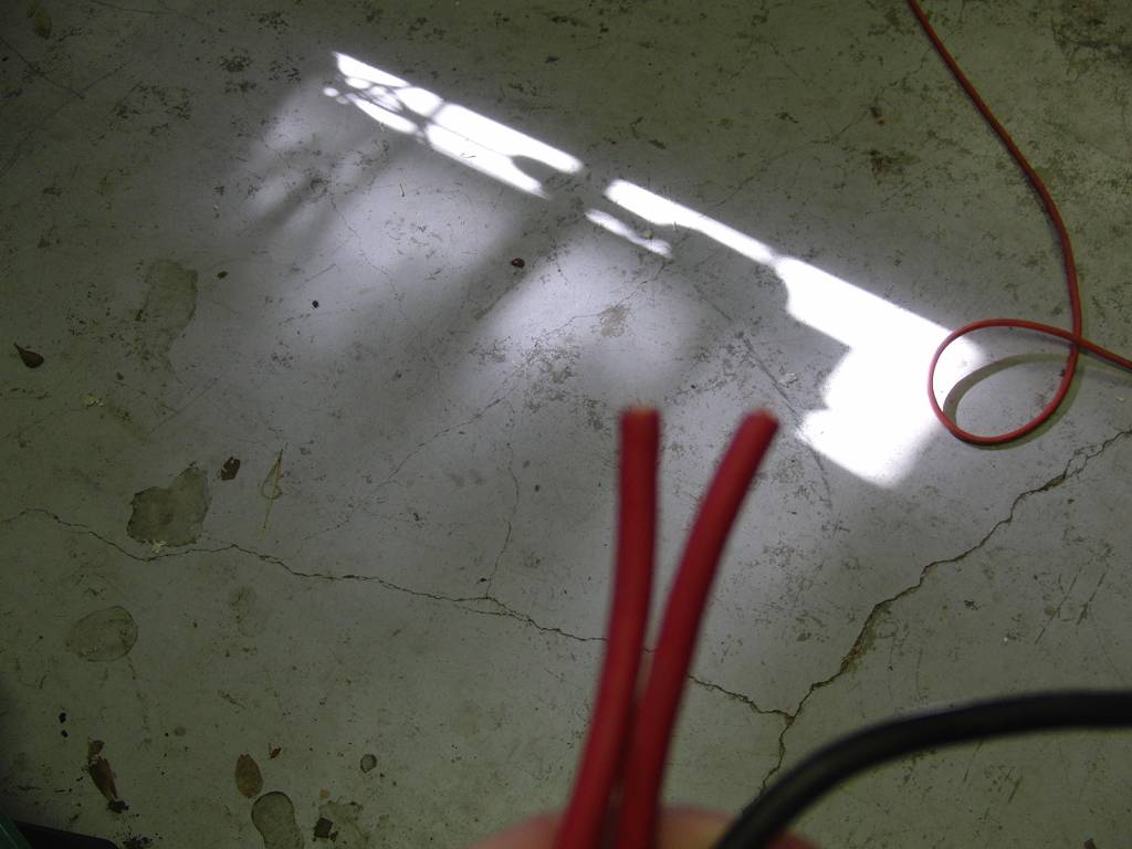

I used the 4mm bullet on this setup.. You can save some weight if you just solder the wires. The way I do it is cut the wires to the length needed to reach
then strip the wire on both the motor and ESC then take the ends (be sure and get the heat shrink on first) and push them into each other working the wire
together then solder. I will try and get some pic's to better understand
Todd

Thanks Dick.. No test flights today, looks like next Sunday for both planes. As for the ESC I have not had any problems with cooling and I am also
running the ICE HV 80 Light so I don't have the heat sink.. As for the CG since you do not have the 2 extra servos in the back you might need to
add on to the back of your tray so you can move the battery back. You can do that after you fly it but I believe your going to be nose heavy.
nonstop, here are pic's of soldering the wires. It is also very important to have a good soldering iron this makes it easier.

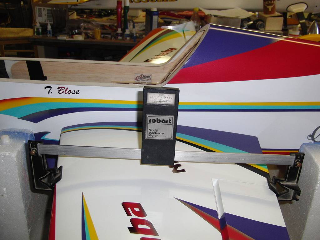

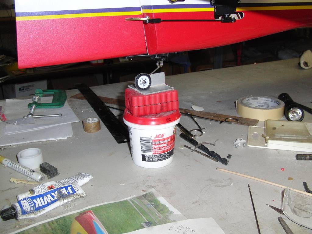

Ok so I have already seen one very important thing I missed..
Its called setup
Since the Da-Ja-Vu has the canopy base at zero we can use that as a starting point. First I will block up the tail wheel to get the canopy base to 0. Then I will double check the stab to make sure it is still at 0 same as the base, then I will set both wings to +0.5 and double check and recheck to make sure they are right. This has been the best starting point that we have found. After the first test flights most of the time you will adjust the stab only to take out the elevator trim that was added on the test flight.

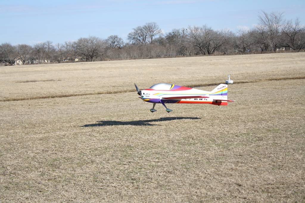

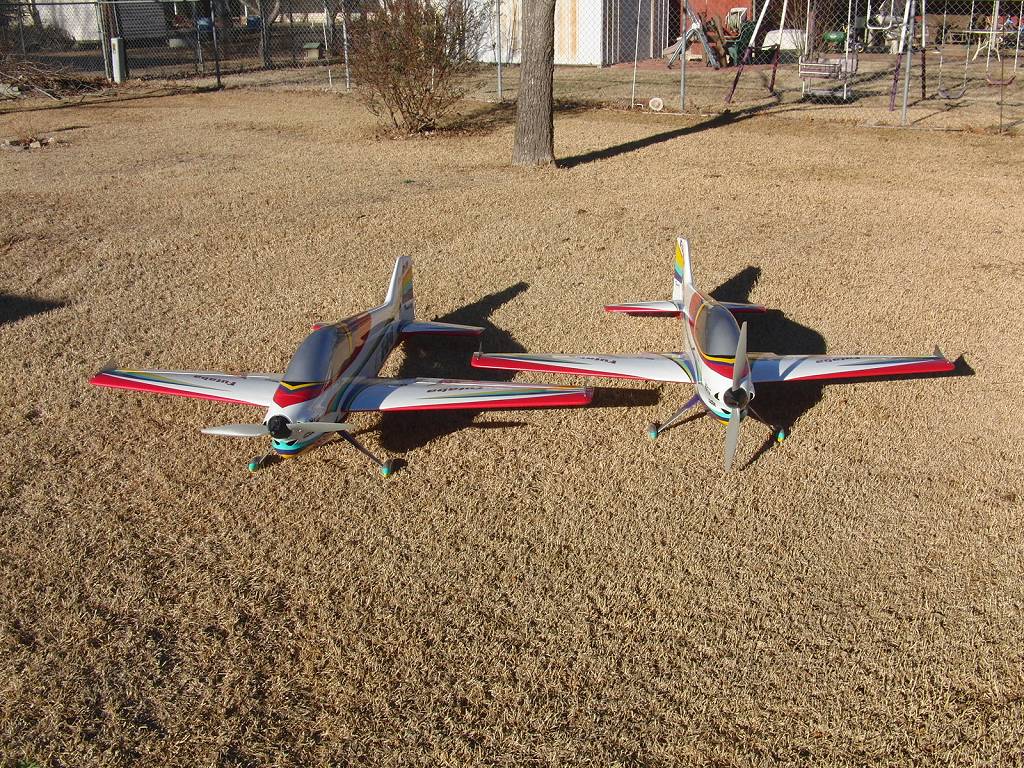

Well I was able to get out and put 1 flight on the plane before the next cold front comes in. The wind was 20mph out of the North and the plane had not problems
and flew well. Need some tweaking but not much, using the same program is the only way to go (if you have the same plane) it just make the test
flight so much easier. CA has done a great job on replicating each plane that they put together

Ok sorry Sedge,
you should have anti hedril in your stabs here is a pic not a great shot but you can see the stabs
