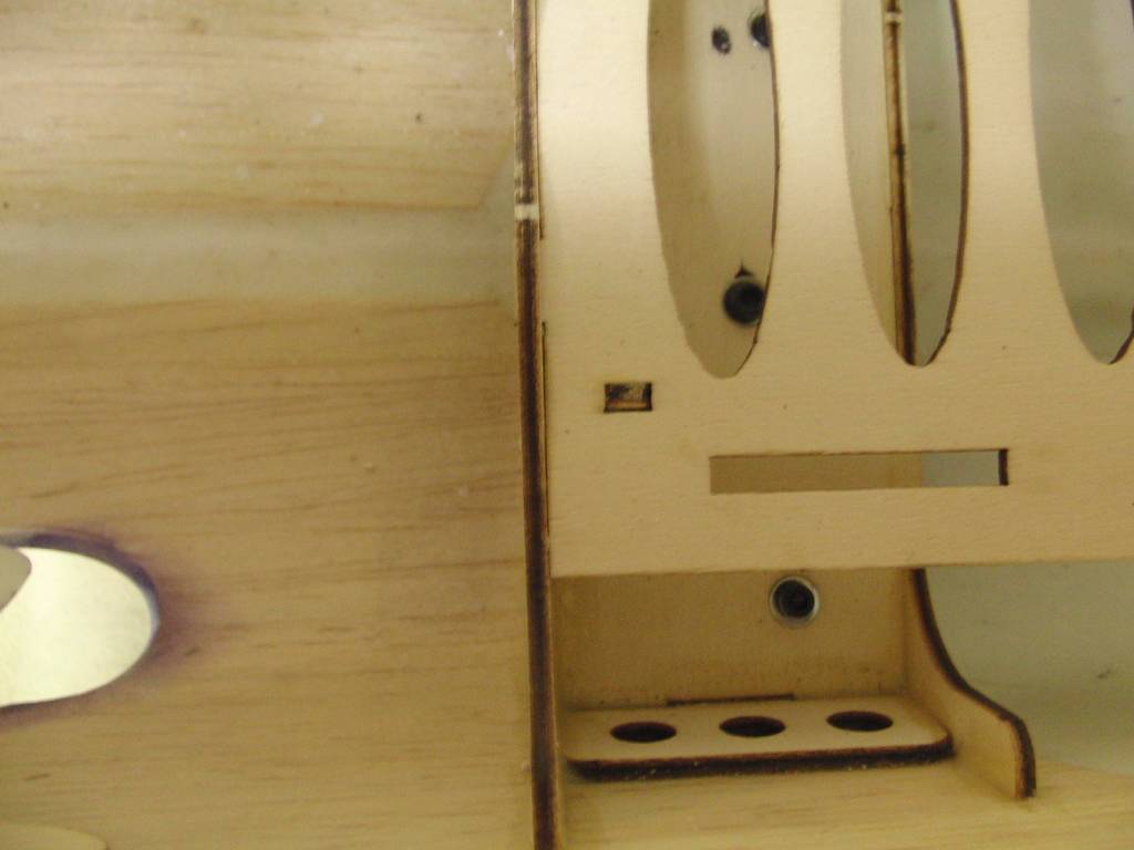

Most builds I would start on the motor install at this time but I am waiting on the Hyde mount so I will move on the the stab. Since the servos are mounted in the fuse and the stabs cover the servos it is very important to set the stabs at 0. The way I do this on the Da-Ja-Vu is to start at the canopy base. The canopy base on this plane can be used to set the stab. First I will set the base at 0 then put the stab on and set it to 0 ( I also replace the carbon tube with an 1/8in aluminum solid rod) After this is done I will use a marker
and mark where the bottom of the stab is. This will give me a reference where the servo will nee to be.

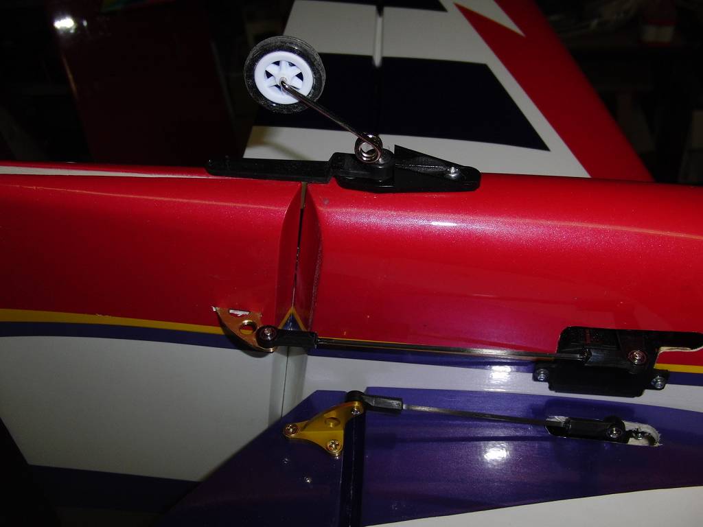

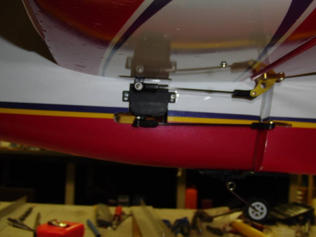

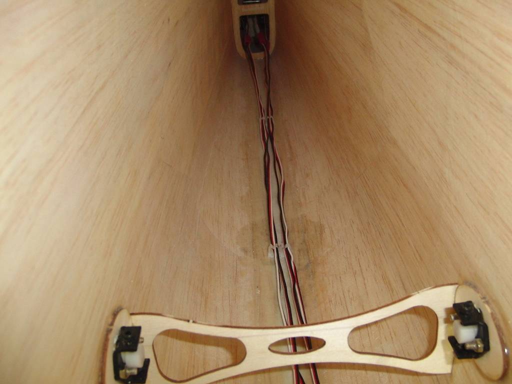

There are 2 ways to mount the servos. I mount them in the fuse and have just the horn coming out if the stab for a cleaner look, you can also mount them in the stab if you choose too. After the stab is set then I will cut out the fuse for the servo. Then you will need to hollow out the stab and cut a slot for the servo arm to come through. I will then put the stab in place the mark where the rudder servos will need to go ( if you are running the standard rudder then the servo will mount in the tray under the canopy and pull pull to the rudder) this is only done with the split rudder. I then add light ply for a backup plate to ensure the screws have something to hold on to.This does not effect the CG ( I just move the 10S pack forward)Once the servos are mounted you can hinge the Elevators and the rudder and hook up the controls. I use the Central Hobbies BB rod ends and .70 Solid Carbon rod and CA in place.
Servo Arms DUB673 (the horn with 5 holes used on all serfaces)
Screws CHMSMS100 from Central Hobbies

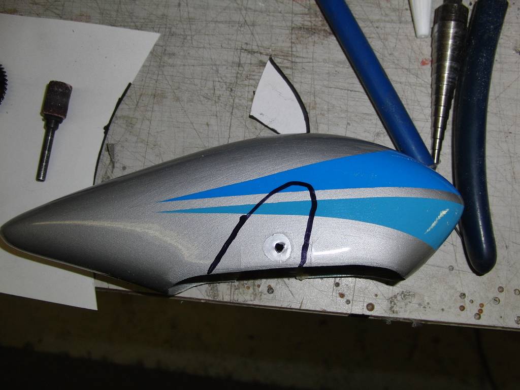

Motor is next now that I have the Hyde mounts. To make sure I have the firewall in the right place I will take the motor and place it in the mount. I then take and measure from the thrust washer to the back of the mount with a set of calipers, this will give me the depth of the fire wall andI use the calipers to set the firewall to the nose ring. ( this has been the easiest way for me I use to mount everything to the firewall and try to set in place). Since the Hyde mount goes through the front of the plane you will need to cut out the nose ring of the plane to get the mount in. After I have the firewall where I want it I will use Foam Safe CA and tack it in place.( this way I can remove and start over if needed) Then I will put the motor and mount in the plane use the spinner back plate to line everything up and drill the holes. After the motor is mounted I will add the tail ring and support then glue into place using Hysol epoxie.
Here is what I used for the Firewall and tail mounts

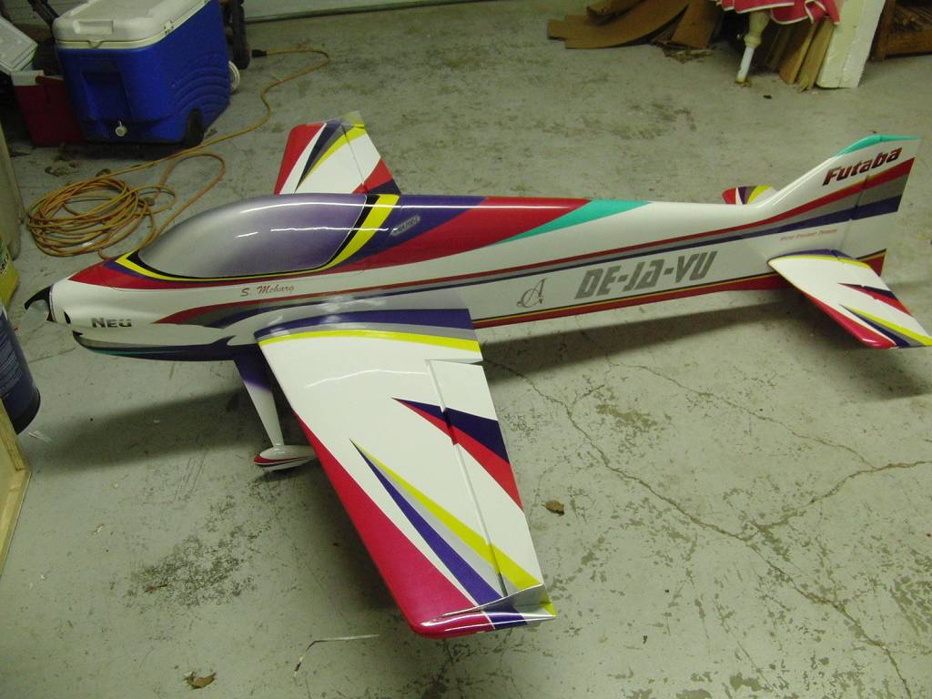

Almost done with both planes. I still have some stuff to add but wanted to put these pic's up.

I now have both planes done and ready to fly. I am still going to add some stuff to the thread but wanted to get the weights of both planes on the thread.
My setup (Painted wings and stabs ultracote bottom wings only)
Futaba 14MZ 2.4
Futaba 6008 HS rx 2.4
Motor Neu F3a
ESC Castel ICE HV 80 Lite
Servos 4- 9650 Rudder and Elevator
Aileron 2- BLS 551
Spinner CA
Prop APC 20 x 15
RX battery FlightPower 800
Motor batteries F3A Unlimited 5S x2
SmartFly 6v pattern reg.
Futaba Switch
Maxxs arming switch
Weight 4920
Scotts (Ultracote wing and stabs)
Futaba 10 C 2.4
Futaba 6008 HS rx 2.4 rx
Motor Neu F3a
ESC Castel ICE HV 80 with heatsink
Aileron 2- 9151
Spinner CA
Prop APC 20 x 15
Tech Aero "FlexReg" and switch
Maxxs arming switch
Weight 4850

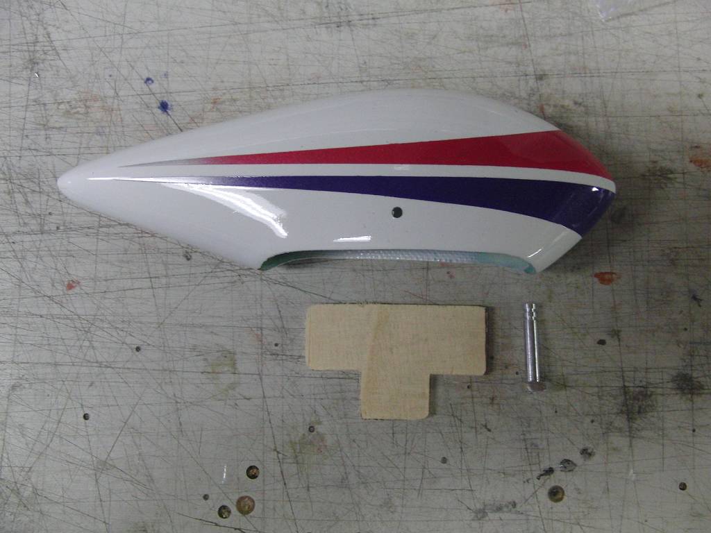

Here are some inside pic's of Scotts
I also posted a pic of the BB rod end. It is very important to have the screw go through the side where you see most
of the BB if not the rod end can slip off of the bearing causing big problems

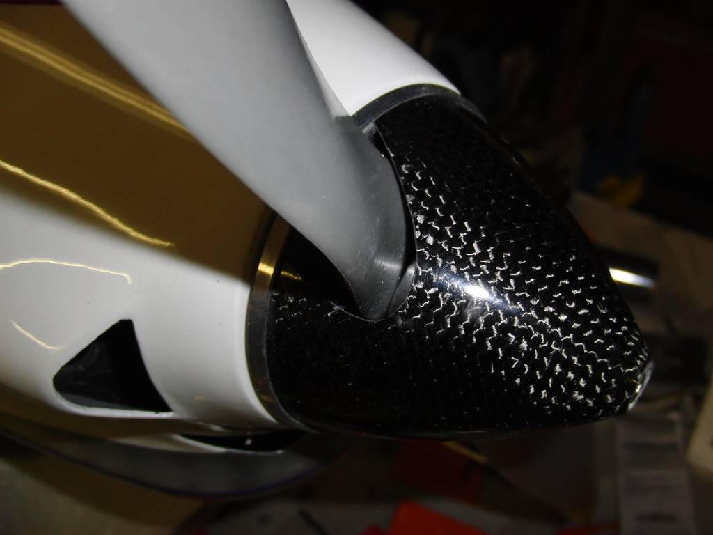

I have been asked to show how I cut the spinners so I will get that on tomorrow. The carbon spinners can be cut using a Dremel with the saw blade and the small
sanding drum also I will explain how the split rudder is installed.

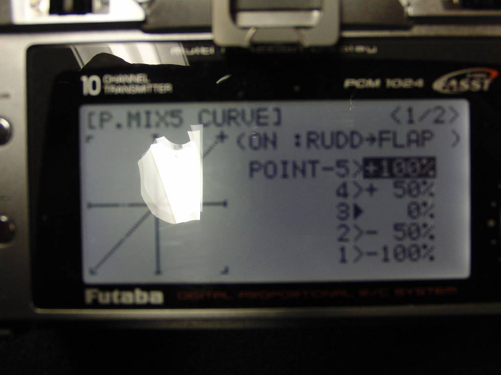

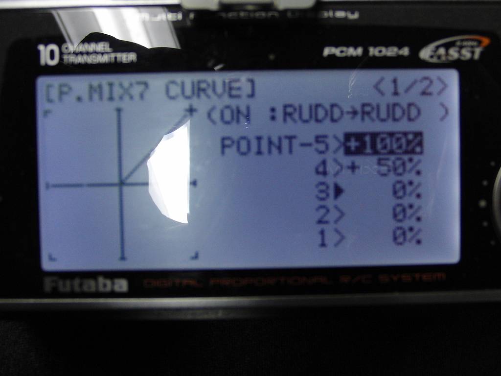

I have had some people asking how I did the split rudder on the Futaba 10C and also how Scotts plane is setup.
So this is how I did the split rudder with the 10C.. I am attaching pic's of the TX in the program screen. The first 4
program mixes are used for rud to elev. rud to ail. rud to thr. and thro. to rud.. Mixes 5, 6, and 7 are used for the split rudder
I use the ailvator mix for the elevators that uses channels 2 and 8. The rudder uses 4 and 6 and the ail diff uses 1 and 7.
Not sure If the other mixes will be used so the are set to 0 and I will adjust during the first flights if needed.
Just let me know if you have any questions and view the pic's in order to get the split rudder to work.

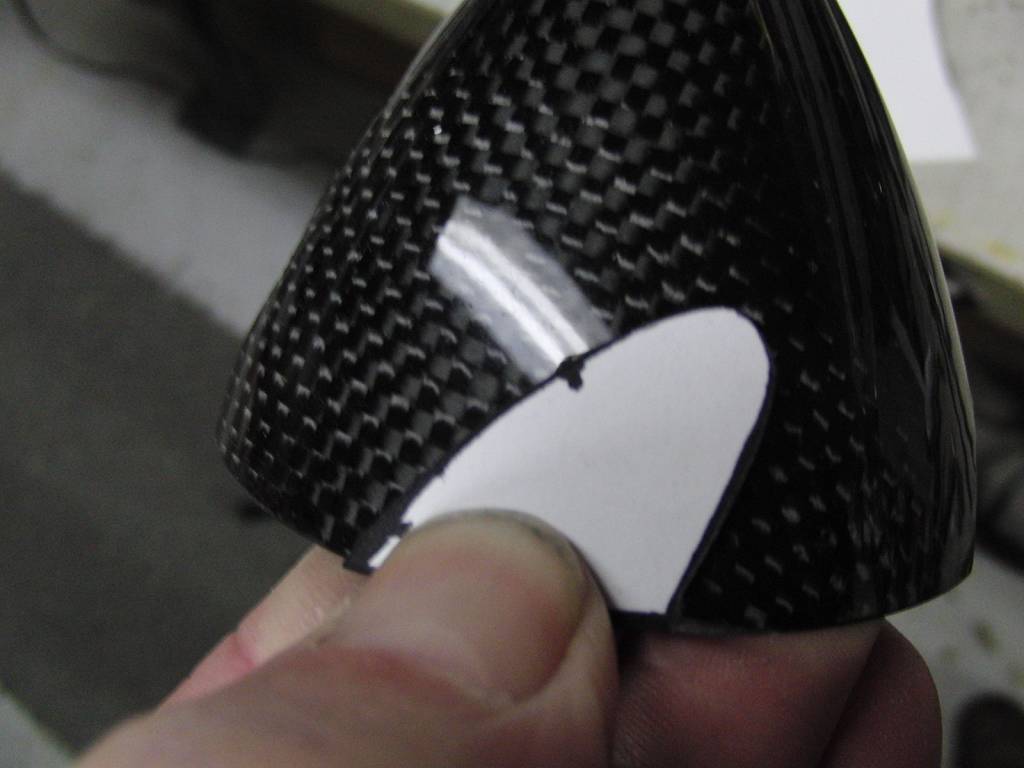

Cutting out the Spinner.
First I will take some paper and draw the base of the spinner, this will give me a line to base the cut on. Next I will take and draw the shape of the prop then cut it off and this is what I use to draw on the spinner. Be sure not to make the cut on the seam of the spinner. The I will set the template on the spinner and trace the cut out. I make a cut with with a Dremel saw wheel and then finish with the small sanding drum. I have already finished the spinners so I used a wheel paint to show the steps..

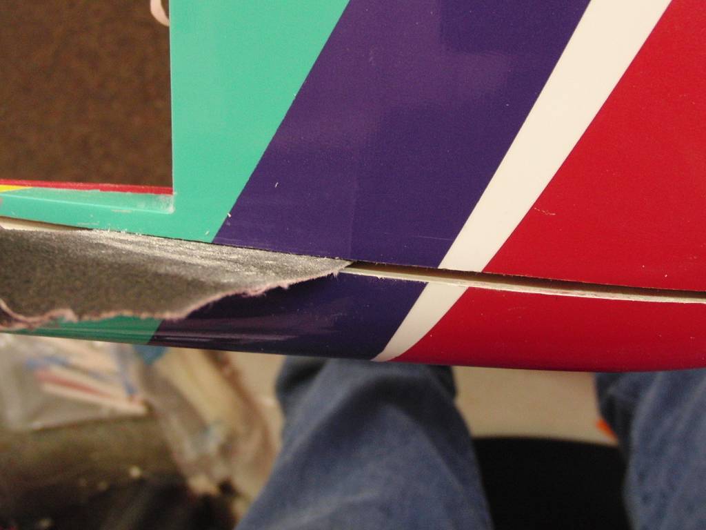

Looks like no test flights this weekend...
