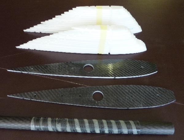

Hello,
Here are some pictures of my new project. It's the version 2 of the Anti-Graviton http://www.rcuniverse.com/forum/m_9749764/tm.htm

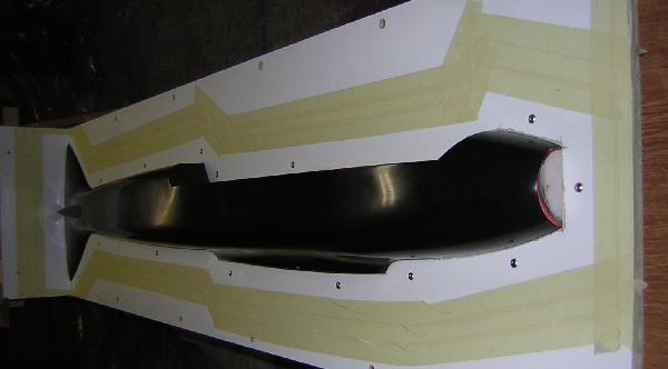

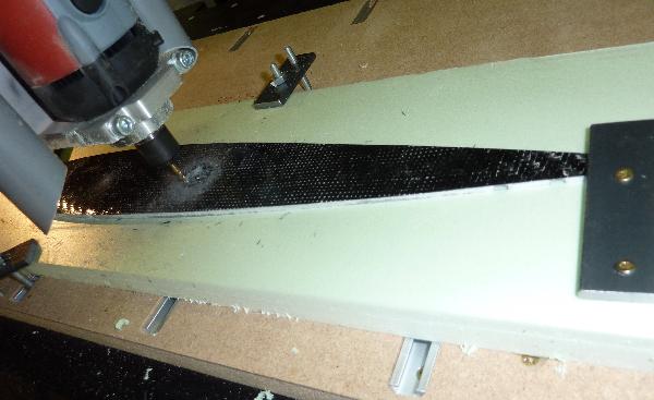

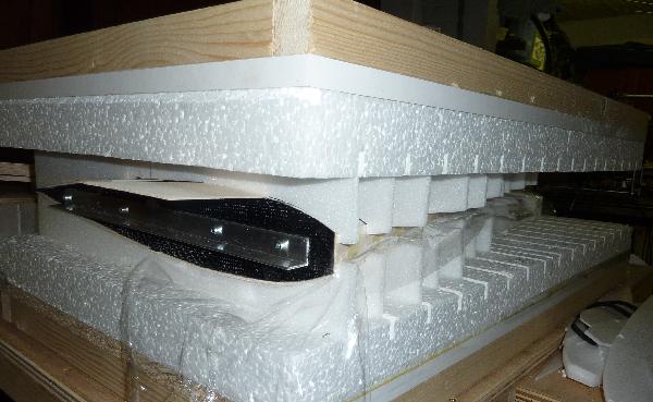

Construction of the fuse master
Want to see more?

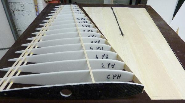

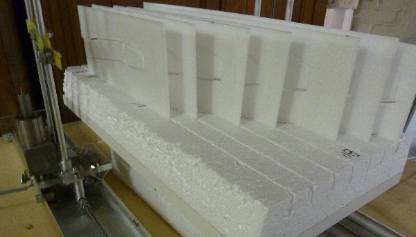

This plane is not finished. It's for the next season. Now, I'm flying with the version 1 of the AntiGraviton and I'm satisfied of his characteristics. http://www.rcuniverse.com/forum/m_9749764/tm.htm With the version 2, I hope to make a better design and to solve some minor problems.
The projet is at this level:

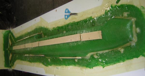

Some news about my project:

Thanks for your positive remarks!
Volkert, I do not have any experience with contra-rotative propellers. But, it's clear that the principle of contra systems fit with the principle of symmetry used for the conception of this plane. I will start with a simple AXI motor. According to my experience with the previous version, the rotation of the propeller do not induces many undesirable effects on the flight, even if the motor is mounted without any down or lateral angle. This is probably due to the symmetry of the fuselage and also to the knife edge wings which guide the airflux.
One other advantage of this plane is that I do not have to use any complex mixing to obtain neutral flight characteristics.

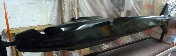

Old 06-13-2012 | 08:27 AM
Joined: Dec 2008
Posts: 52
From: LiegeLiege, BELGIUM
Default RE: Anti-Graviton v2
First contest with this plane on sunday!
