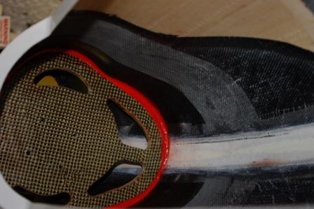

Does anyone by chance have a template for a firewall for the Wistmodel / Lorenz Bravo.
What method are you guys using to get the shape of the firewall and what material and glue are you using
Hi Chris, this is the way I do it, to mount the rear of an out runner to a firewall:
1/ Attach the spinner backplate to the motor’s prop driver.
2/With 1/161/8th spacers between the backplate and the fus.nose, tape the backplate and motor securely in place.
3/ Cut a small square of liteply, just big enough to carry whatever fixings (eg bolts) you will be using to fix the motor to the firewall, and fix it to the back of the motor.
4/ cyano multiple 1/8 or so balsa sticks to the liteply square, with each stick radiating out to touch the fus sides.
You’ll end up with something like this:
Uploaded with ImageShack.us
5/Remove the porcupine,draw round the edge,and produce a liteply firewall template., to check the fit to the fus, fixing points, &c.
For the actual firewall, I use two layers of 1/8 liteply, with the outer ply grains at 90 degrees to each other, skinned with 200 gram/sq.metre carbon or glass cloth front and back, all fixed under pressure(I use g-clamps, melamine-faced chipboard, with black polythene bin-liner separating film),using wing-skinning epoxy.
I glue the firewall in,bolted up to the back of the motor, with 24-hour araldite, reinforced with beads of 30-minute epoxy/micro balloons around the margins,front and back faces.
Here(shades of Blue Peter) is one I made earlier:

Thank you Alan,
The motor will be the Himax which will as far as I can see only mount via a firewall
Really pleased with the Bravo quality so far

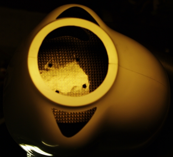

As requested sir
Not yet spun the Himax but the fus now fully fretted out where needed and carbon horns on order
I have also ordered more carbon kevlar for the battery tray. Peally got the laminating bug now

Hi Shahid,
It is never going to be easy to remove the firewall backwards with the motor on an get it past the undercarriage mount ( which is by the way beautiful engineering) The Himax is 63mm diameter and with the nose fretted out there is plenty of room to remove the motor from the 83mm nose.
Nose fretted out with diamond burr to about 65mm
C
