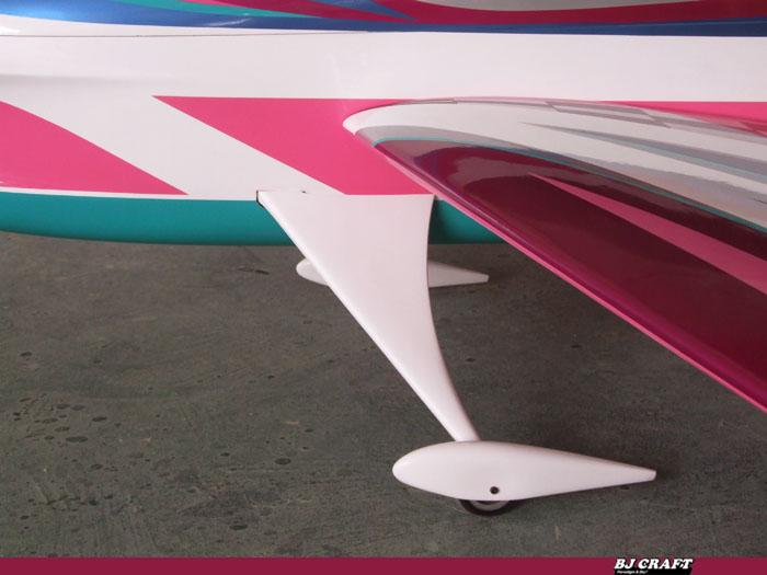

Old 01-13-2012 | 08:03 PM
Joined: Oct 2010
Posts: 44
From: Valencia, CA
Default RE: Prolog
Hi. Robert
it is Cannard landing Gear for Prolog model.
see photo image below;</p>

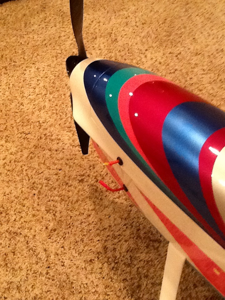

Well, I wanted to add a quick update about the Prolog. It is finally finished and ready to go and i will be taking it out tomorrow afternoon. Weather is looking really nice so it should be a non event. I made a few changes on mine from the stock set up. The stock set up used blind nut in the wing and i believe three or 4 mm bolts to hold the wing on. I decided to use plastic 1/4 20 bolts, glued in the wing and wing nut to secure it in the fuz. I also made a cut out in the rear to support the rudder servo, thought this way was a little easier than the other method proposed in the instructions; other than that everything else uses the stock set up. The plane weighs 4512 grams with a Himax 210 and Rhino batts, so if you wanted to make it lighter you certainly could.
I just bought 8 new 5S Rhino batts from Hobby King. and could not believe the weight. Each weighed less than 608 grams. I did a few tricks that i was showed by Joe Dunnaway and Bill Ahrens to get the weight down, and now these packs weigh the same and in some cases lighter than my TP 5000 25C packs. Not sure what they are doing to get the weight down, but the new packs are significantly lighter than packs in the past; no, i am not sponsored by Hobby King, but though i would let you all know, as I am a big fan of the Rhino packs. I bought 4 packs in late 2009, and they are still going strong!!
Pics are below of the finished model, and it also shows how i can kill the power to the motor from outside the plane. I was showed this installation by Rusty Dose back in 2008, and since then every electric plane that i have worked on has this external arming and disarming switch.
Will give an update once i fly her tomorrow

Good job! What did you do to the batteries to put them on a diet? I just got some Rhinos and should do the same to them.
I plan to use a similar method for the external disconnect. Where did you get the grommets?

Old 03-15-2012 | 05:12 PM
Joined: May 2011
Posts: 62
From: SalemOR
Default RE: Prolog
Go to a auto parts store for through wall gromets

Hey Tom, there is the positive red wire that runs all the way toward the top of the pack. What i did was put a small hole toward the rear of the pack and pulled the red wire all the way out, the cut it to the length i need to make the 10 cell pack work.
Now in order for you to make this set up work one of the batteries needs to be turned the other direction, so you will have the balance connectors at opposing ends of the pack. Let me know if you want pics

Thanks, Robert. A followup question - Is the red wire you're pulling and cutting the one that would connect to the black wire of the other pack to put the two packs in series? That is a good idea it will leave several inches of un-necesssary wire on the ground. I'm guessing the different lengths of wire and locations of balance connnectors can be accomodated in the plane setup and the charging set up as well.
Your external connection do you prefer the more vertical orientation of the wires as compared to a more horizontal arrangement? You probably could count the number of times I have even touched wires of that function on one hand. I know I have disconnected them for a few people when calling for them but have never connected them hot. I would guess that the orientation could make a difference in how easy it is to work with. Comments?
Thanks, Tom

Hey Tom, that is correct, on,the first part of your question. One you pull out the wire cut it to the length you need to match the negative coming from the other pack, pretty simple to do and save a lot 12 - 20 grams per pack.
Concerning the orientation of the arming plug, not sure if it matters, Rust Dose, I beleive had his orientation that way so I just followed suit, figure if it ain't broke
