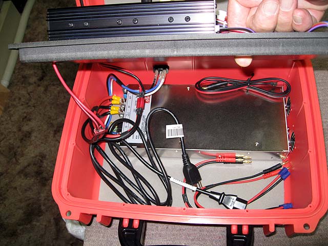

This is where it gets trickier or should I say spendier????? Is that a word???? lol
The 10XP is a 600 watt charger IF you can feed it with 32 volts which most people cannot, however it's pretty happy with 24 volts and that voltage is becoming much more common with various power supply manufacturers. I elected to go with a system from Progressive RC which uses two CellPro 10XP chargers fed by a 24 volt Meanwell Power supply and that's fed by a Honda generator.
So as I've said, what you might do is really affected by how much you can spend and how big a priority certain options might be for you but recharging the batteries these 2 meter size models use is no small consideration.
Here are a few pics of what I set up with the components from Progress RC which is where the case came from as well. You can see the power supply in the bottom of the case and there is room there to store several different boards and you can see the power cord for the station which is setup on the outside like a computer so the cord can be removed.
