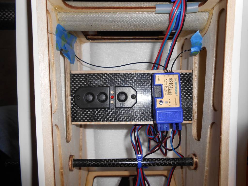

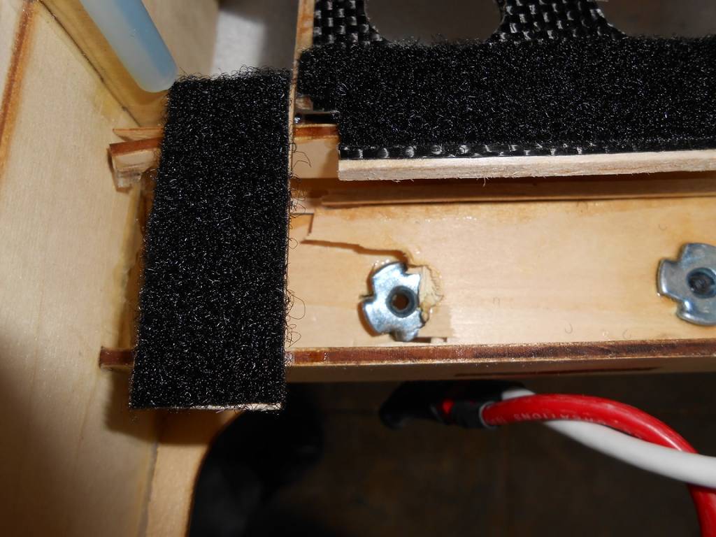

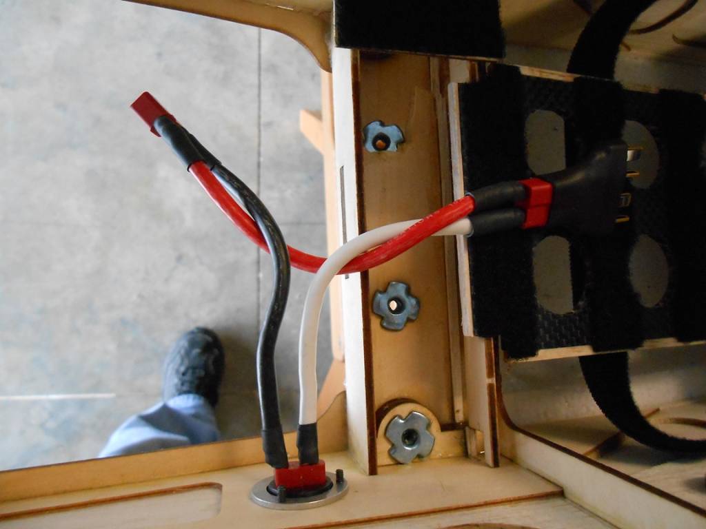

Here is a front picture of the Battery Tray and Receiver/Switch Tray... Again, using 30 minute epoxy. I velcro'd the Rx in place. The Rx is an Airtronics 10ch FHSS-3 for the SD-10G. It has slots for two receiver packs which make this setup very easy. The switch is the Power Box Sensor from Aircraft International...
http://www.aircraftinternational.com...r_12/index.htm
Here are the pics...
Note on the Battery Tray is only showing the front of it. I changed phones and in the process the ATT Rep formatted my SD card for the new phone despite saying I wanted to make sure I save all the pics with the phone...LOL
The Main Battery tray was mounted as stated in the instructions. The rear part is glued in so it is resting on the brace and the former at the wing tube. I will bring up the damage in the next part of this thread on how I repaired the block.
I'm just a novice at this, so feel free to tell me I'm not making a good decision. RVP did and probably saved me from doing a second repair...
I forgot to mention the Armsafe switch. I had to reconfigure a Castle 2 into 1 battery harness for using two 5s packs. I removed a male T-Connector and soldered in another Female. I used a modified 2 into 1 T-Connector (I had to take it apart and put a gap between the two connectors) to connect the batteries to the Armsafe Harness.

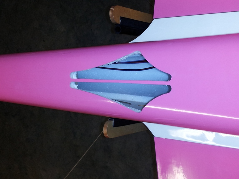

The last steps for me where to cut the cooling inlet and exhaust. I used a dremel on the cowl. I put painters tape on the cowl and penciled in the shape I wanted then opened up using a dremel.
For the exhaust cutout I used the template supplied in the kit. I taped in place using painters tape and once I was happy with the location I used a sharp exacto knife #11 blade to rough cut it out. Then I used a dremel with a small sanding drum to finish while the template was still in place to prevent me from taking too much material.

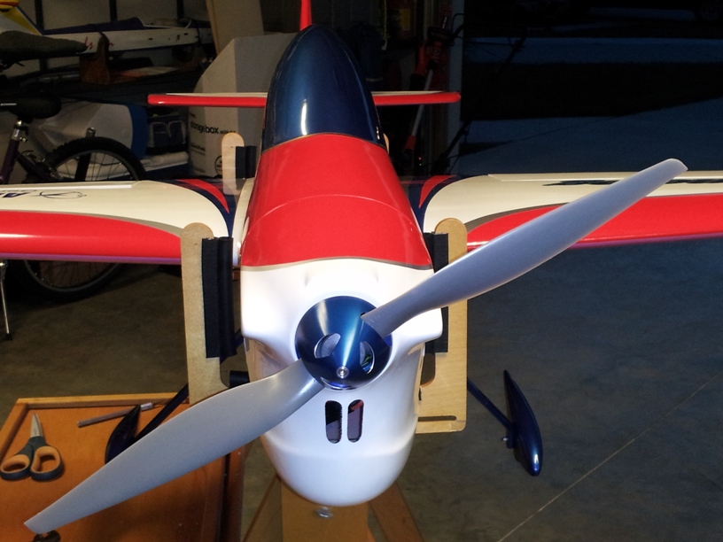

I had the best practice flight yesterday which made me feel like I could actually fly the Intermediate Sequence with justice... ;-)
Nobody was at the field when I got there. After getting the plane set up, an older gentleman drove up to pick up an umbrella he forgot.
He saw my 2M Monolog and had a big grin on his face. He had never seen a Pattern Plane let alone see one fly. He said he was willing to stick around and watch if I was going to.
With a big smile on my face at this point, I asked for his assistance. I explained I needed somebody to call for me because I don't have the sequence memorized. He was initially nervous and quickly calmed down when I explained how he could call for me and what he needed to do, and if he messed up it was no problem and no worries.
Needless to say he was amazed watching the Monolog fly. I was amazed as I was thinking this is the flight that should be judged at a contest as it might be awhile before I repeat it. I flew slower to help give him time and for me some practice on a slower flight. Bang, it helped. He did a great job calling !!!!!
I finally landed and thanked him for his assistance and looking forward to meeting up with him again this weekend at the field.
He left and I set to pack the plane up. I took off the Canopy and removed the batteries. One by one I removed the wings next, placing each one in it's appropriate wing bag. What a great day !!!!!
Then I was overwhelmed with an adrenaline rush... What just happened...? What did I do...? OMG, I didn't just do that...!!!!!!!
I suddenly realized I didn't remove the rubber-bands that held the 2M Monolog wings on... Why you ask? Because I never put them on before the flight... I flew it with out the wings being secured.
Note to self... "Make some kind of "Remove Before Flight" red ribbon flag to remind me to put the rubber-bands on the wing restraints..?
