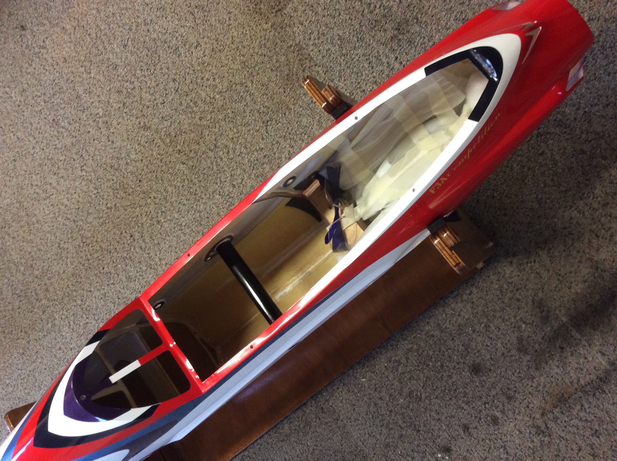

Hi guys,
Both twins seem to have been delivered without complications. The packaging is excellent!
Here are some more pictures. The fuse is cavernous!
Tonights task will be to get the U/C and tail wheel assembly fitted.

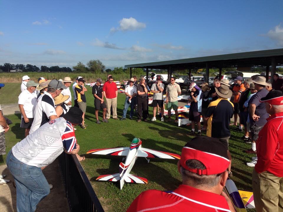

What a great photo! Allure the centre of attention at the Australian Master pilots briefing.
Glenn Orchard was the photographer.

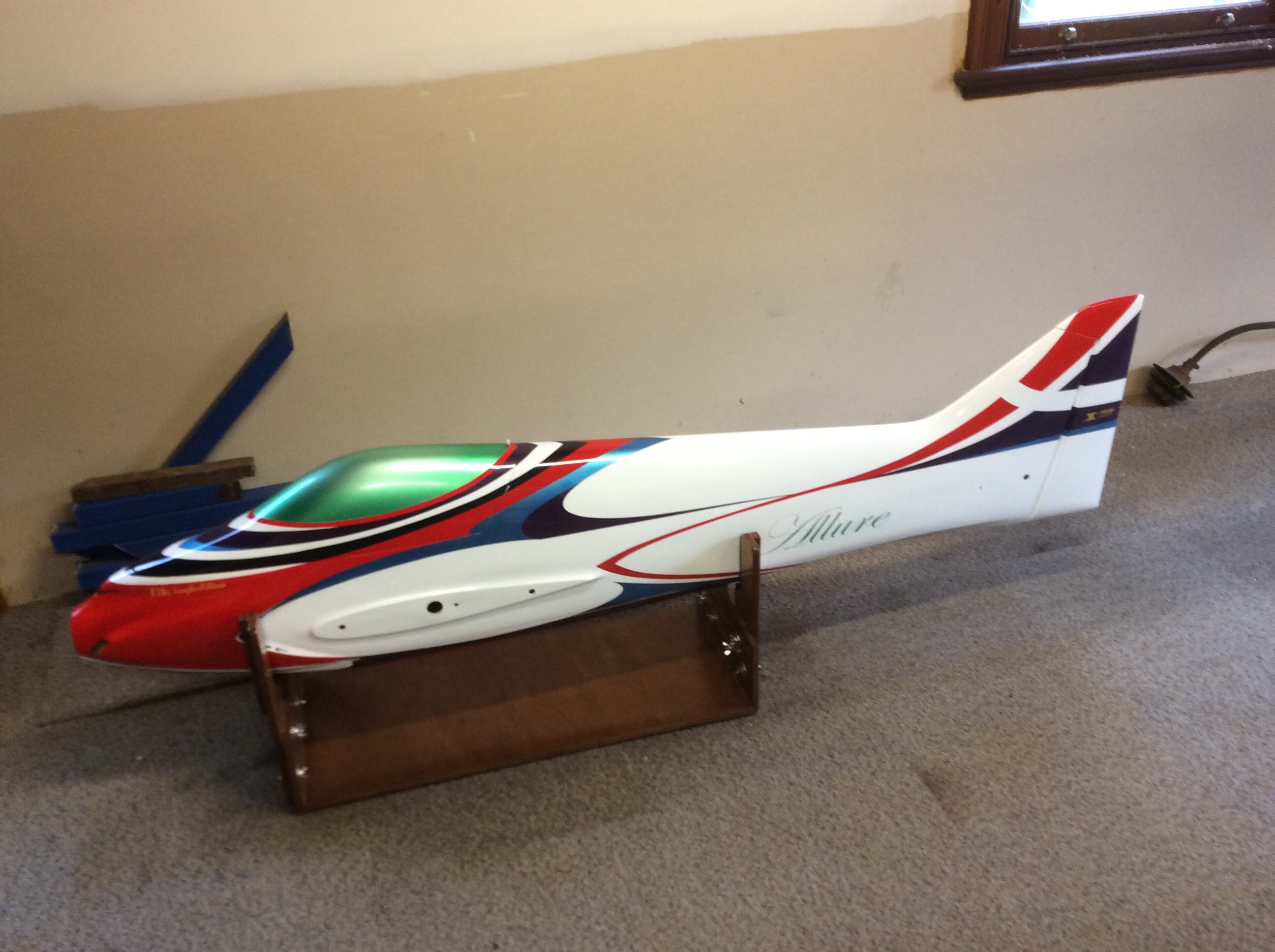

Allure vs Escence... Which is bigger?

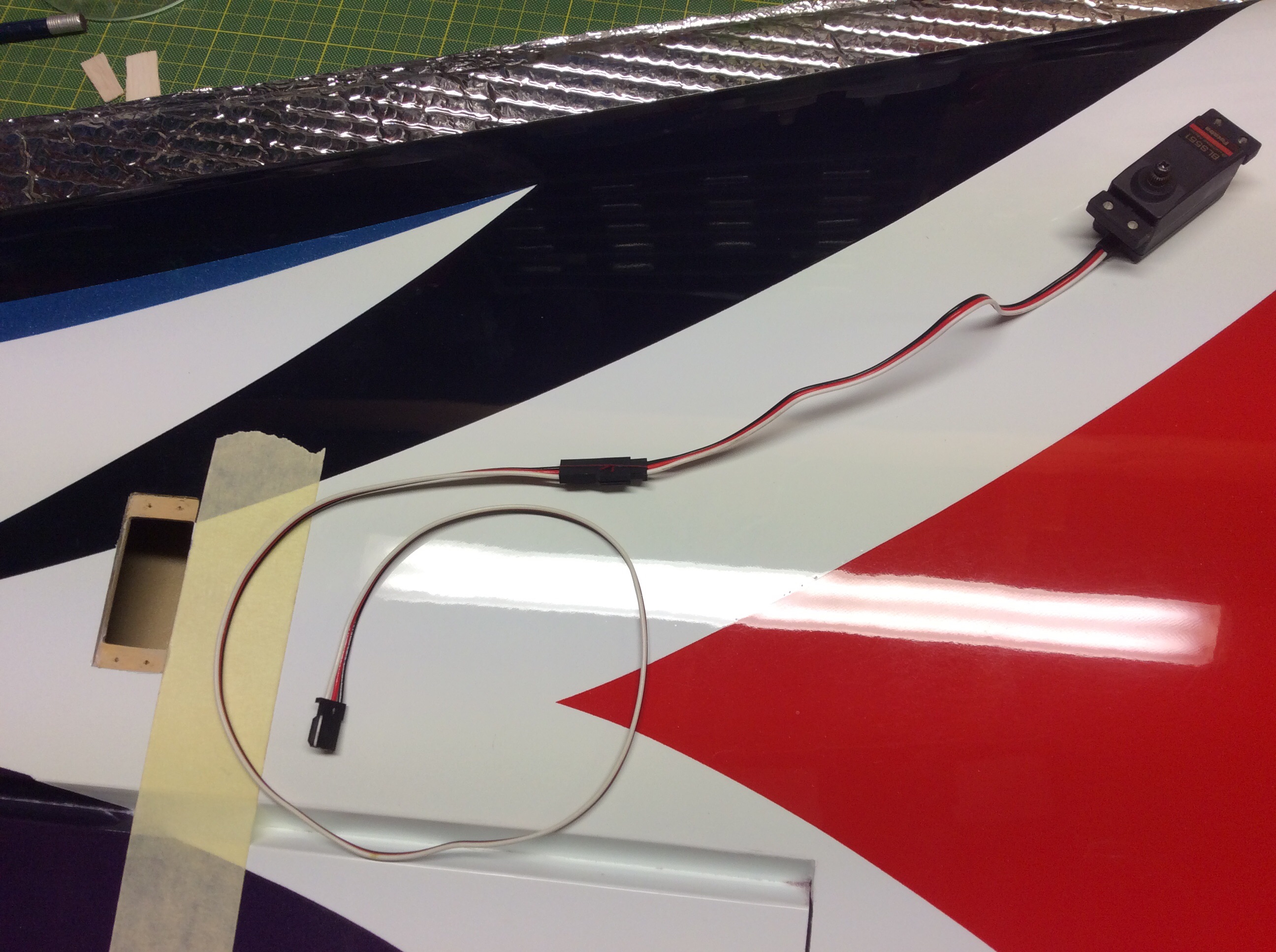

Started on the wing servos last night. Had to open out the servo hole a little to suit the Futaba servos. Not much required perhaps 0.5 to 1mm.
A couple of pieces of 1/16" balsa either side helps to centre the servo so holes cab marked and drilled.
I just used a pin vice with a 1/16" drill bit to make the screw holes by hand.
Then fit the screws and you're almost done. On these servos I have fitted 40cm HD extensions. A small piece of fishing rod binding string is used to tie the plugs together. Light and strong!
Within the wing is a paper tube to carry the servo wire and extension. Neat!
At this time I have also marked the hinge line centre on the masking tape in preparation for mounting the control horn.
I now discover that the servo horn should be on the other side of the servo. The Secraft horns are very tight and a puller is needed to get them off. Im reliably informed that these arms should NOT be used on servos with a plastic output shaft/spline.

Gday Jason,
Couldn't help noticing that your servo arm is about the same as your control horn which I think you will need to adjust your ATV on your FUTABA TX a fair way down
Are you not concern about the reduction in resolution
regards
Mavros

Hey Marvos,
It's lucky I don't use a Futaba Tx then. Actually, I fly a Multiplex Profi TX with Futaba servos.
The servo horns are 20mm and the CK Aero control horn is the 20mm length version. Not sure how much throw this is going to give me yet but am aiming for 25+ degrees for snaps. May need longer horns! In any case, as long as my Tx travel settings are above 80% i'm happy with the resolution. A flight phase (mode) will be used to reduce the throw down to around 12 degrees for normal flying.
When are we going to see you at a NSWPF comp?
