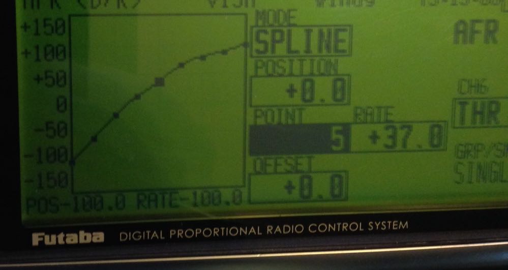

Old 11-23-2014 | 08:05 AM
nonstoprc's Avatar
My Feedback: (90)
Joined: Sep 2003
Posts: 2,466
From: Central, TX
My throttle setup uses a curve that allows more power in the low and middle range. Motor is Neu F3a and ESC is Mezon 95 opt.
