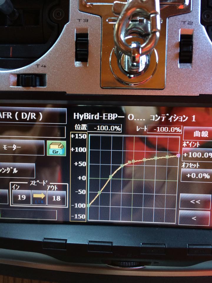

Just a quick question on the OS motor. What throttle curve are you using with the OS Motor and OS esc?

The first 1/3rd to 1/2 of the throttle curve is very steep and then levels off after about half throttle. With this curve it is very linear and not jumpy at higher throttle settings.
