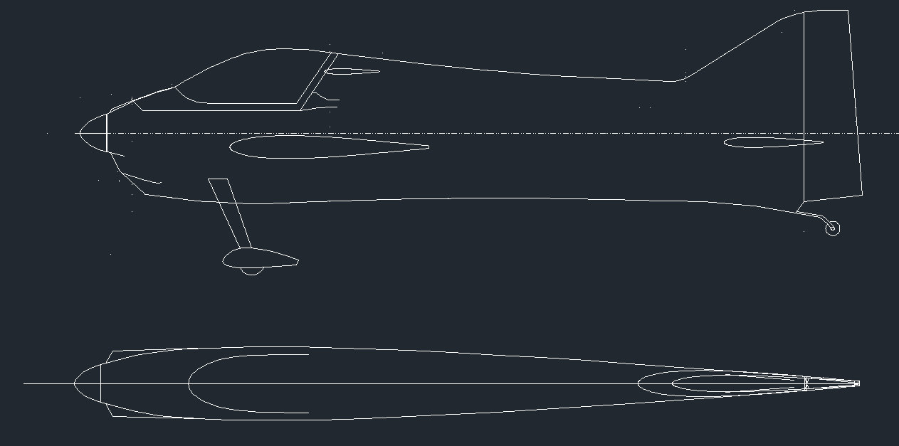

Time for a new F3a model. Electric this time. Working name is Amadeus. The fuselage will be molded and the wings balsa on foam. I will cover the molding process, which is something not seen here much.

Here are some dimensions.

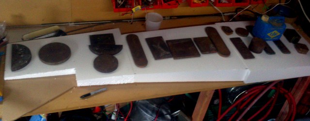

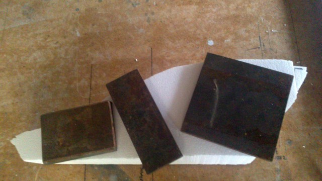

From this point I will use different methods to build the fuselage shape. My first plan was to cut 100mm long cross sections derived from the Solidworks model. However I wasn't entirely happy with the shaping in solidworks so I am going to do the shaping free hand using profile gauges to get symmetry. I did use the CNC foam cutter to do the top view though.
ID:	2106221   Click image for larger version

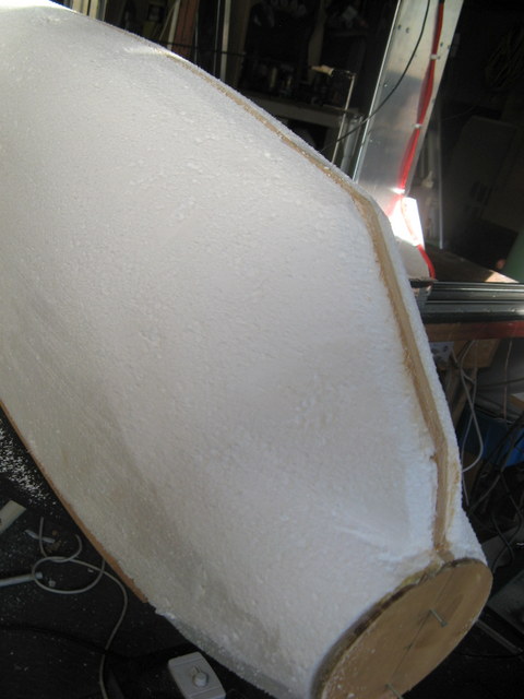

The canopy/hatch got cut out of the profile and foam glued to it.

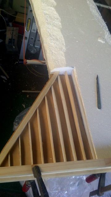

The fin is built up for accuracy. I use Profilli pro for my airfoil work. The airfoil is SD 8020 with the trailing edge thickened to a blunt 6mm and the root high point moved back to blend into the fuselage. The solidworks model helped to visualise the fit. Once the design was sorted out I printed out the ribs and used a glue stick to attach the printouts to the balsa. Lots of ribs for stiffness. Also made some leading edge templates for accuracy.

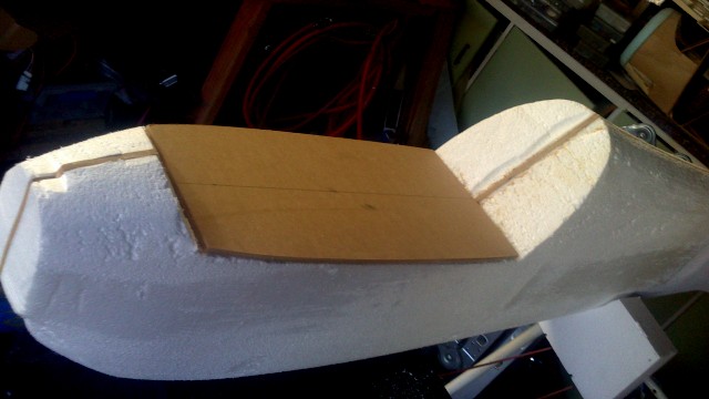

Old 06-28-2015 | 03:41 PM
RodneyFord's Avatar
Joined: Apr 2015
Posts: 424
From: Lower Hutt New zealand

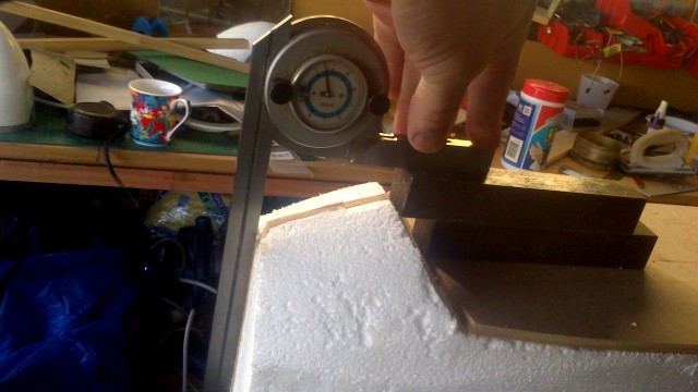

Used the canopy base to set the nose angle at 1/2 degree. There will be no right thrust as the model will have a contra drive or use throttle to rudder mixing if only one prop.

Did some rough shaping on the lower nose area. Actually nothing complex here, just want it fairly low drag and smooth here to get the air moving down the fuselage easily. Not worried about taking off too much foam as it is easy to build up later with bondo after it gets glassed. Much harder to take glass away and redo it.

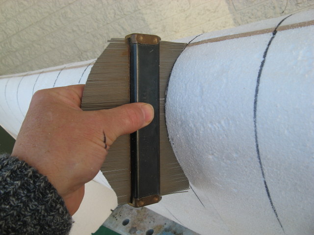

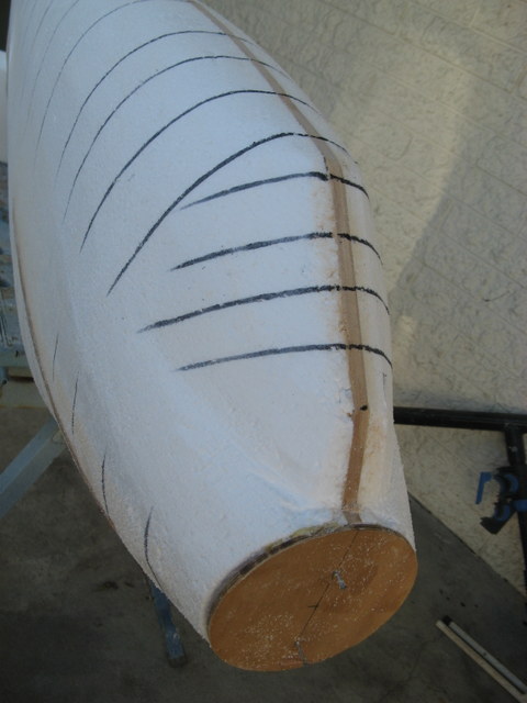

Got some section lines on so I could see the curves more easily and to check symmetry with the profile gauge.

The interesting bits for me are the things that are done differently or in a new way.
These are:
The free form shaping using the profile gauge for symmetry (I got pretty close by eye)
