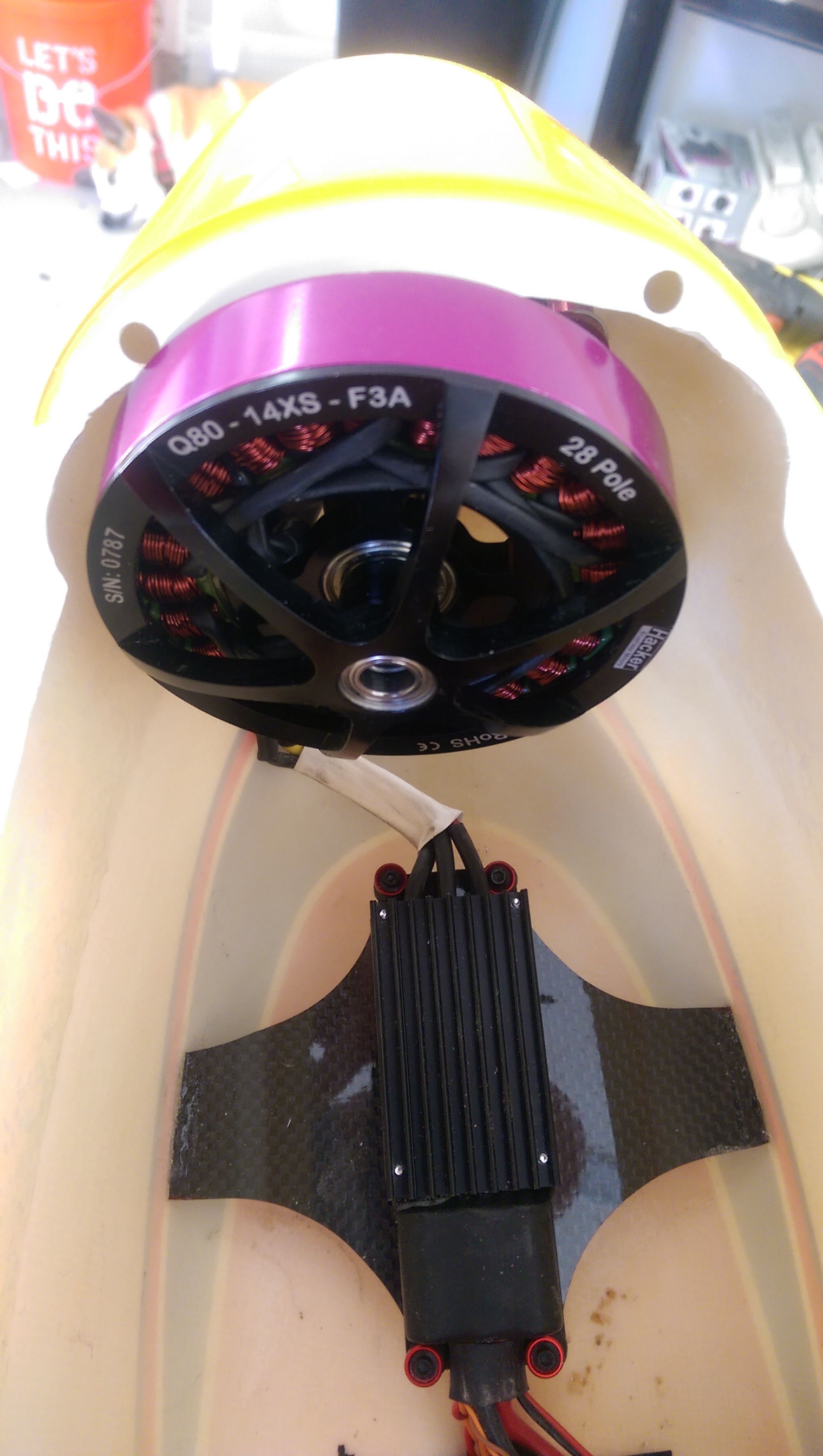

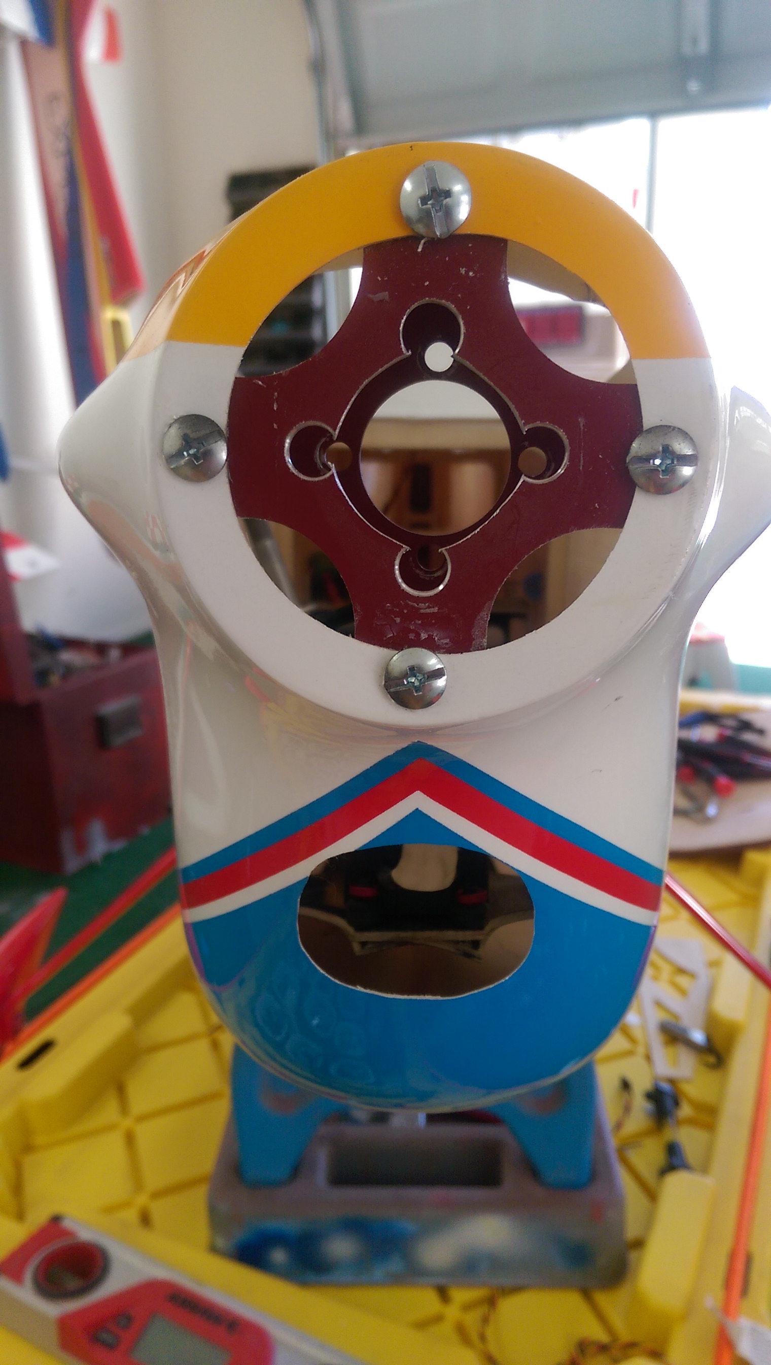

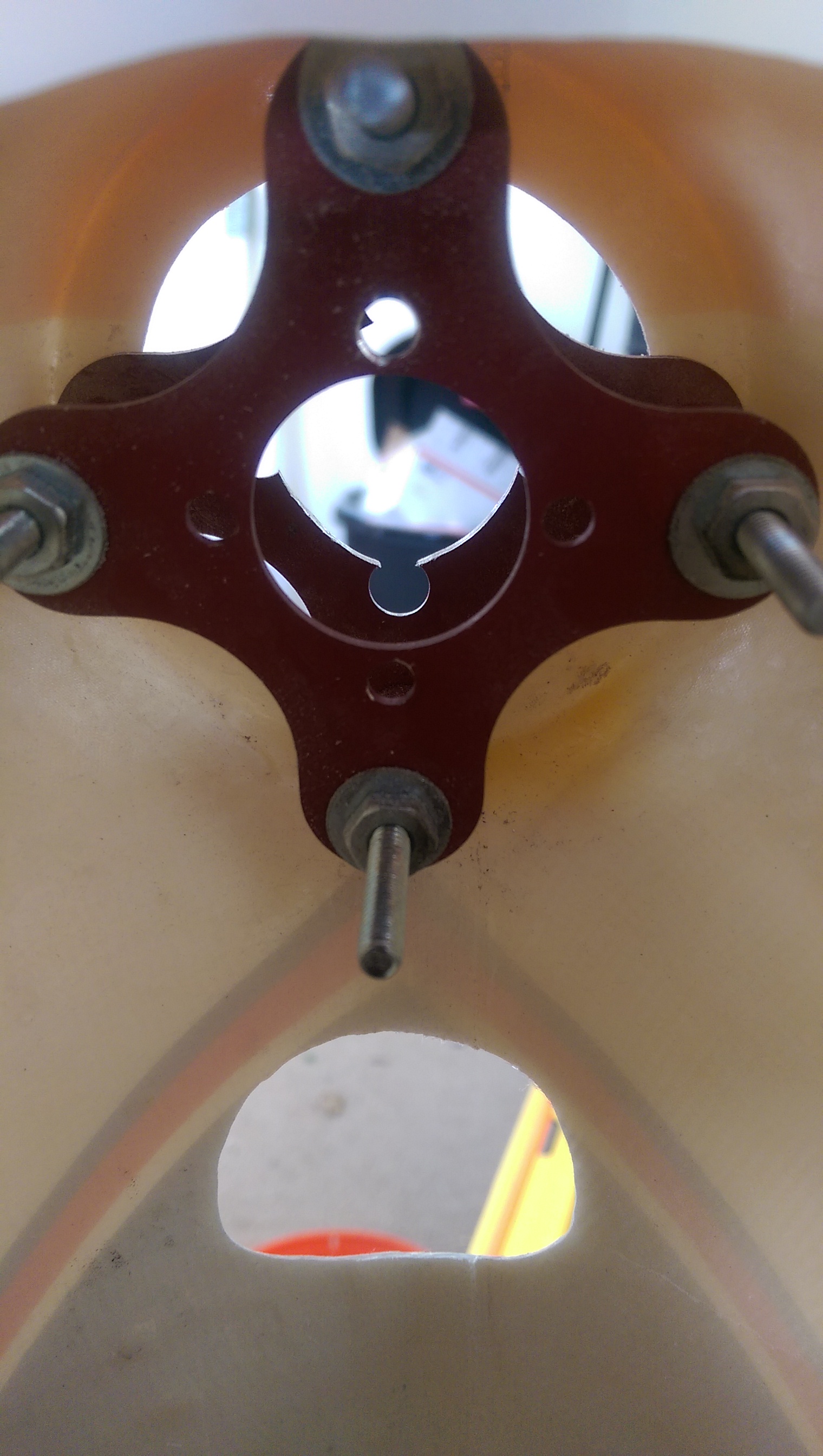

the fist thing that I found that the hole is way to small for the q80. so I had to apace it back 1.5 inches. the way I did this is I used a 2.5 mm end grain carbon balsa cut out a circle to reinforces the nose. then a f3a q80 mount. I ran a 2 in 6/32 bolt from the front through the mount ans a 1/2 secraft spacer with nut and washer then another q80 mount to for the motor/ with all if this I was able to clear he nose

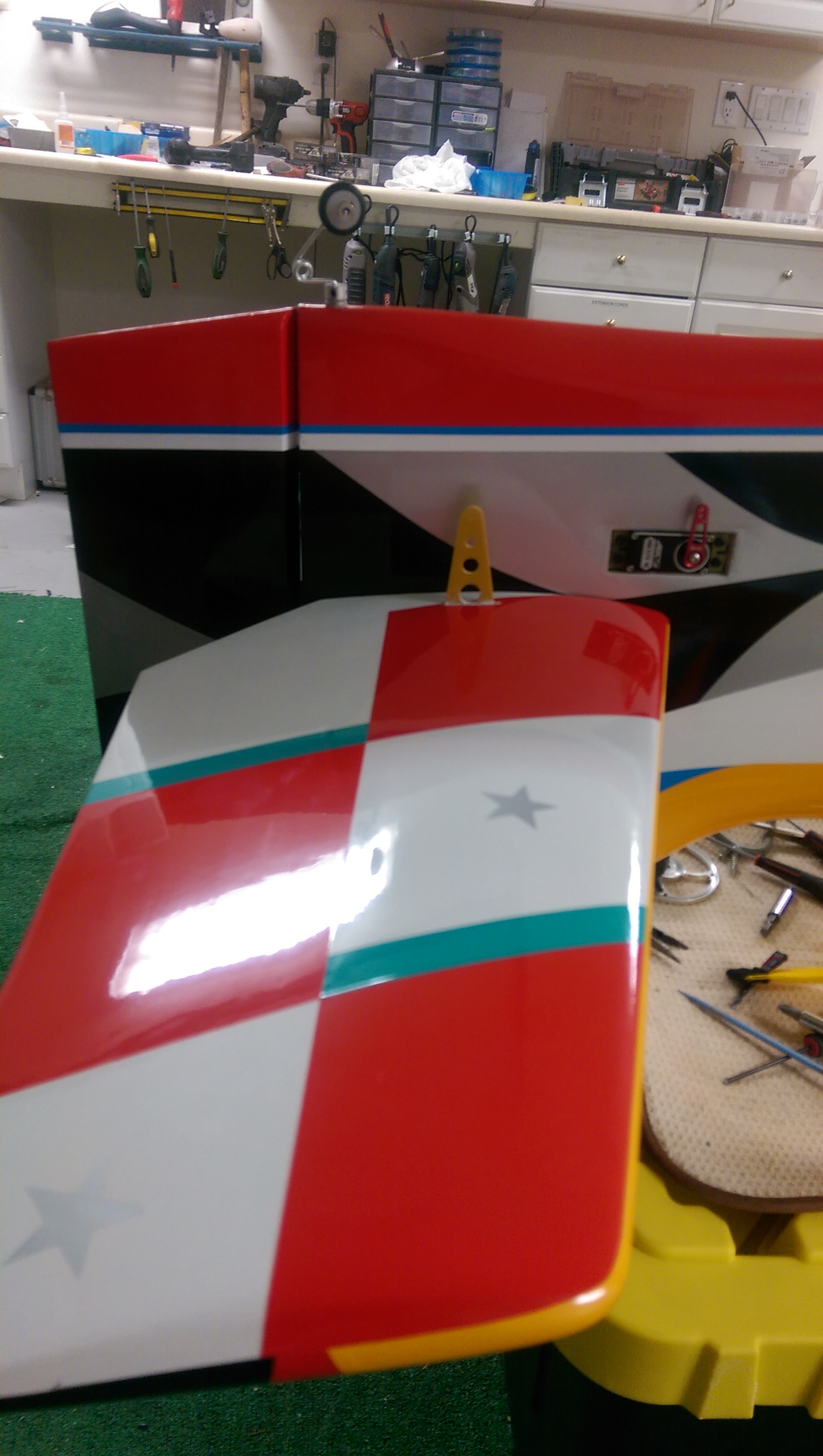

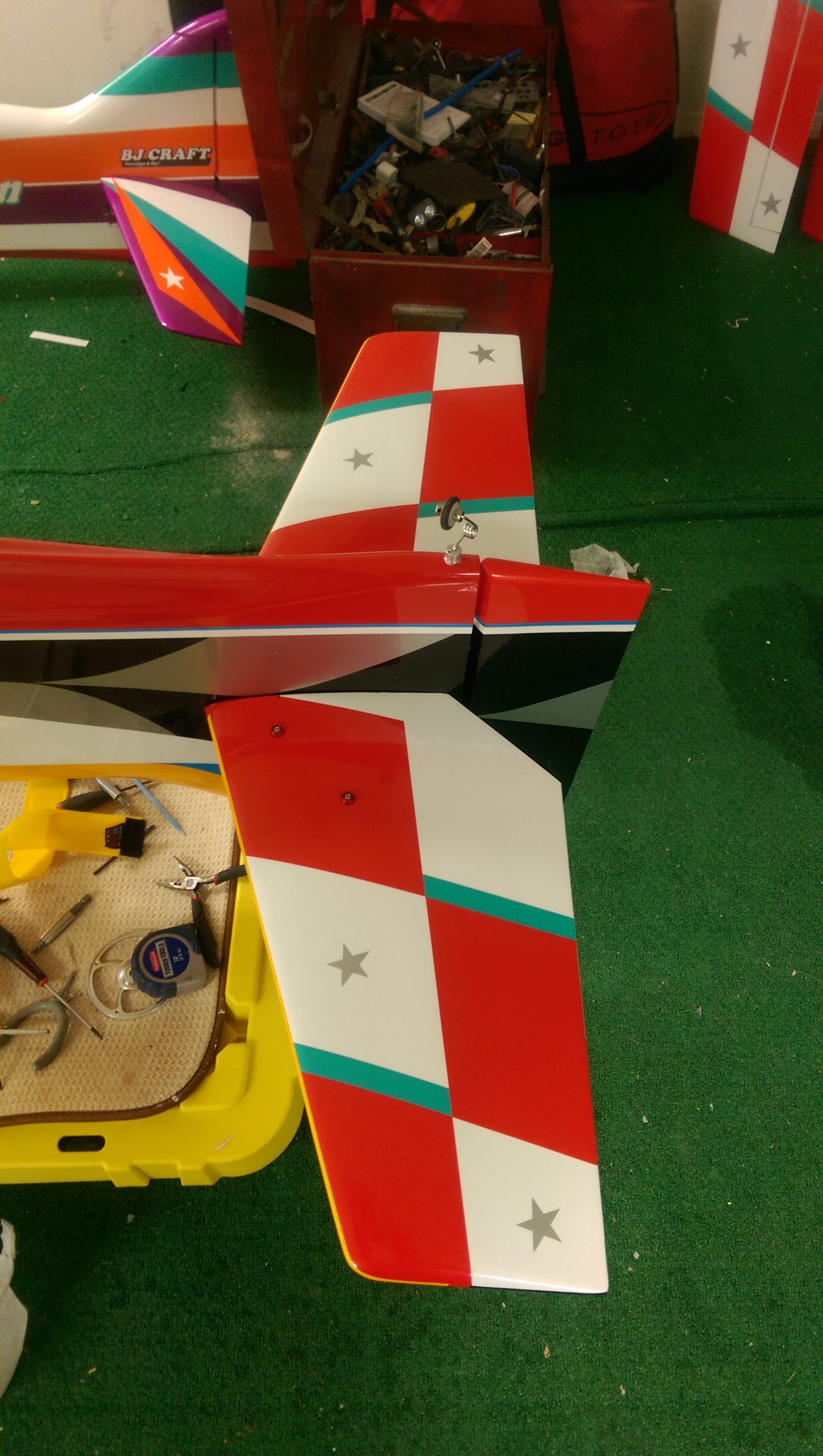

then I worked on the flying stab servo and construction of the the flying stab,. I stated earlier that I was using the new X6 servo by Mks
the specs are located at: http://www.mksservosusa.com/product....&cat=27&page=1

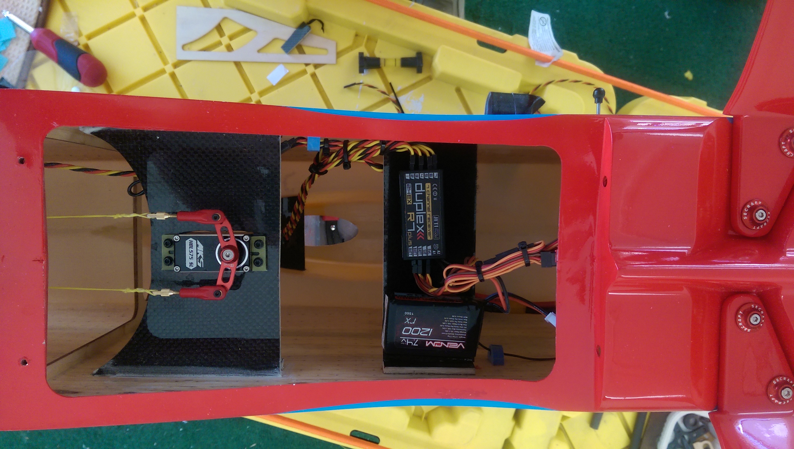

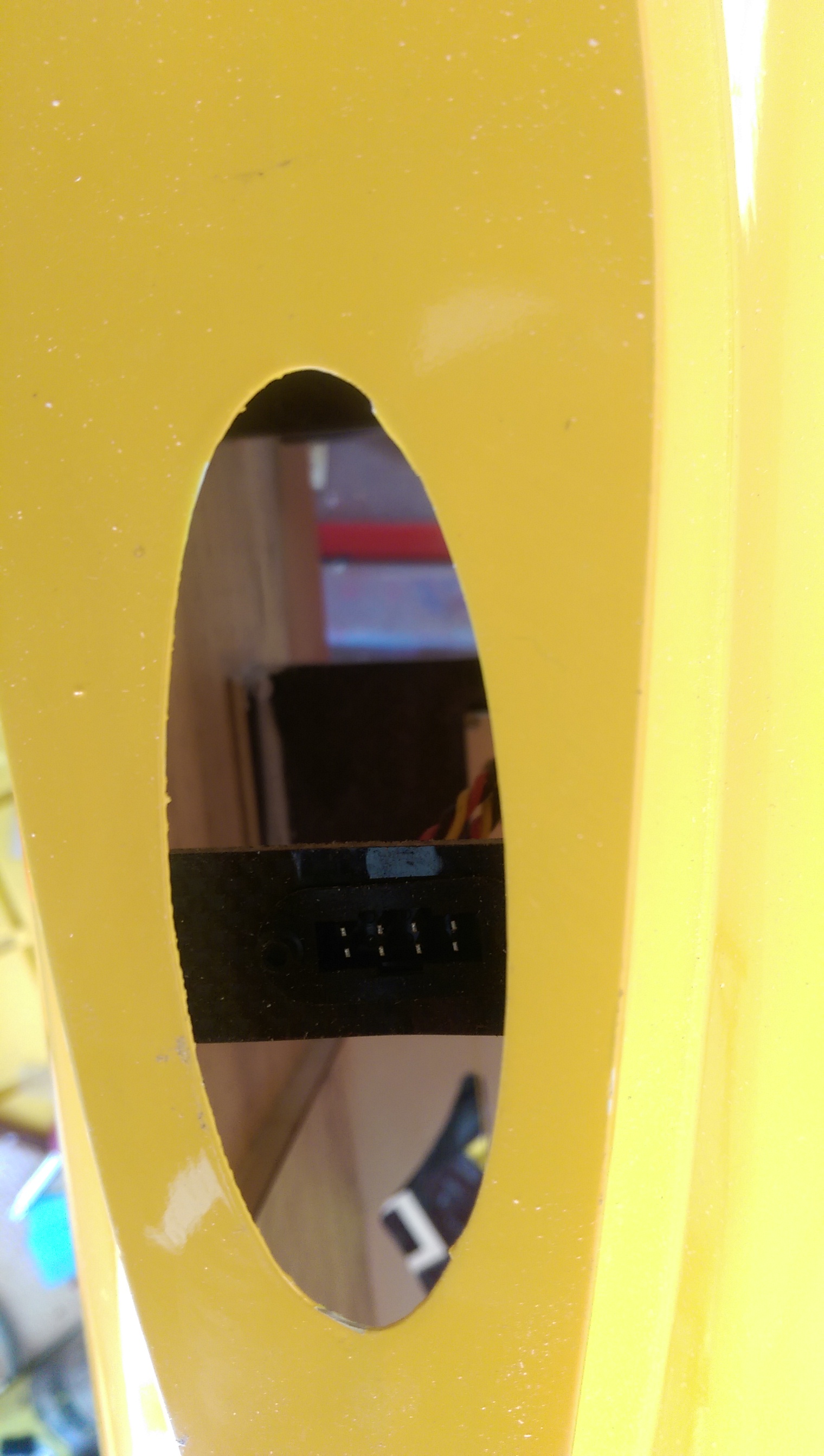

After finishing the flying stab I worked on the rudder . this a pull pull rudder .For the cable I like to use 85lbs Kevlar braided fishing line. I use double pull. so I loop it around the rudder side and pull the two leads per side to the arm and pull tight and tie. after this I use thin CA and soak the knot . once you do this its there.. I find this system and very effective and I have not had any failures.
Also in this picture you can see that I have cut a the plate that holds the servo and battery I used 1/8 carbon sandwich ply , The parts that are supplied are fine I choose to do this for the extra strength. I mounted the 8 wire plug for the lower wing servos.. I cut another piece and glued it under the opening on top below the upper wing for the servos .
