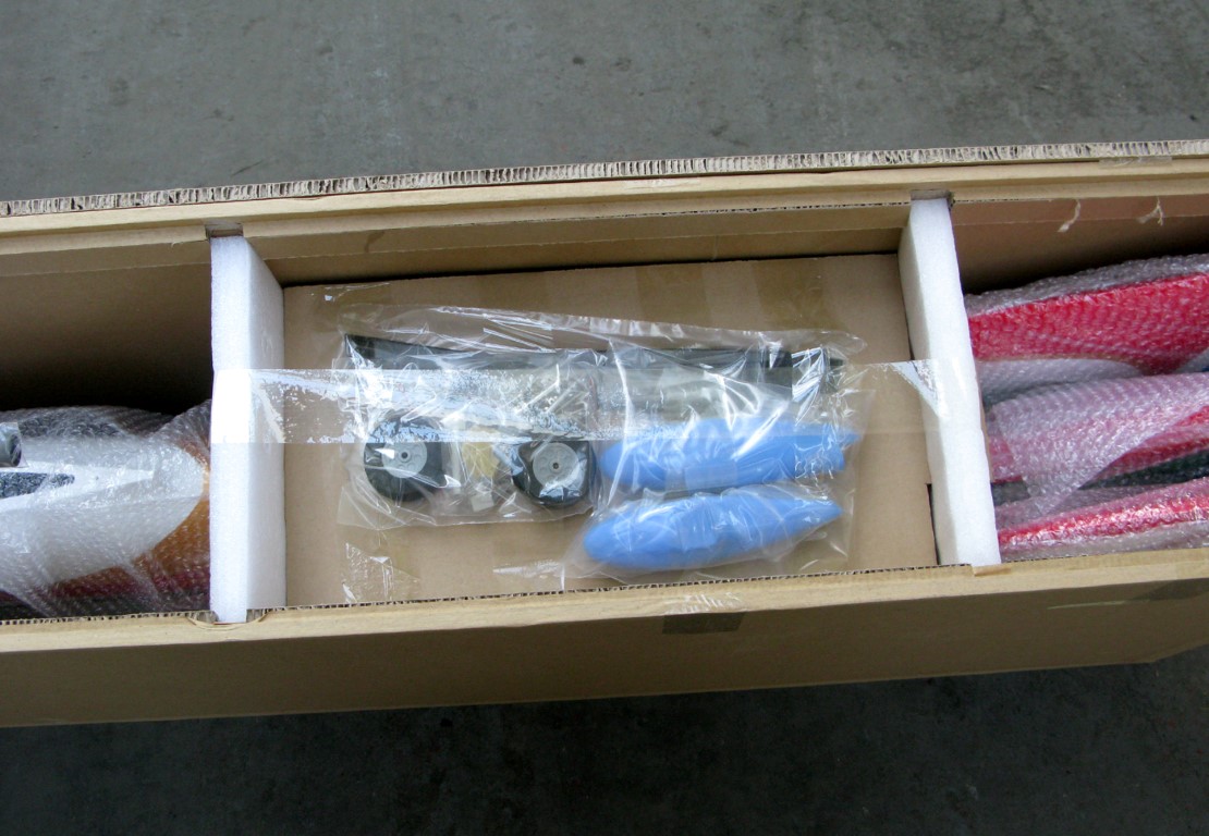

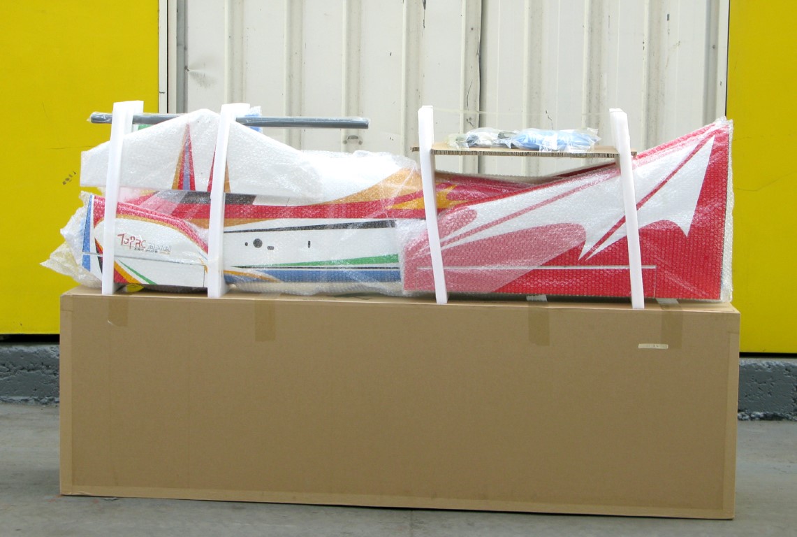

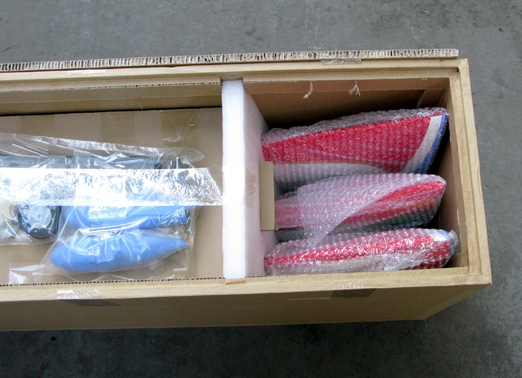

Bad news, could not get the box in the car despite having a massive boot the Mazda 6 was not having it. So the box got left behind.
The packaging is superb this should defeat just about any deliveryman.

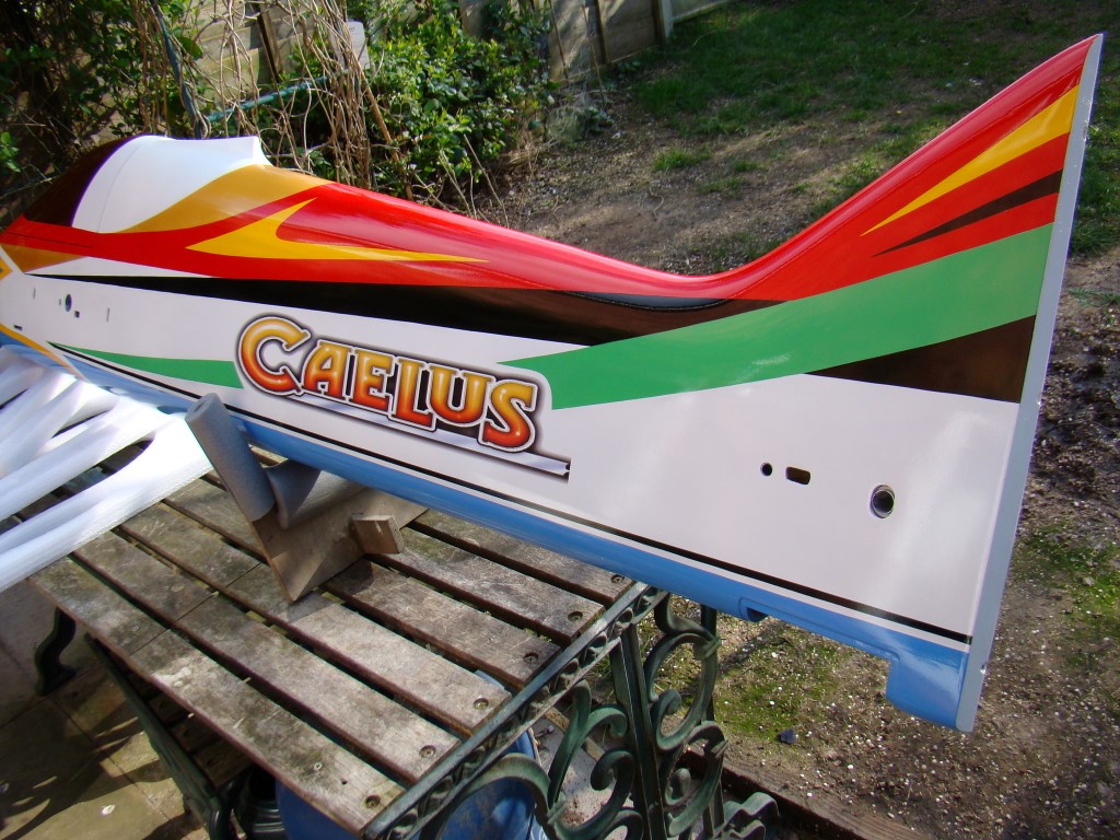

It is difficult to get the photos to do the model justice, the quality is superb. 99% of the work is already done for you, the holes for the pin hinges are pre-drilled. It just a matter of checking the fit and gluing the hinges horns etc in place and absolute doddle.
The motor arrived today from Kingslyn Models, decided to order the matching speed controller, that will be here tomorrow, spinner ordered from Dumfries Model Flying.

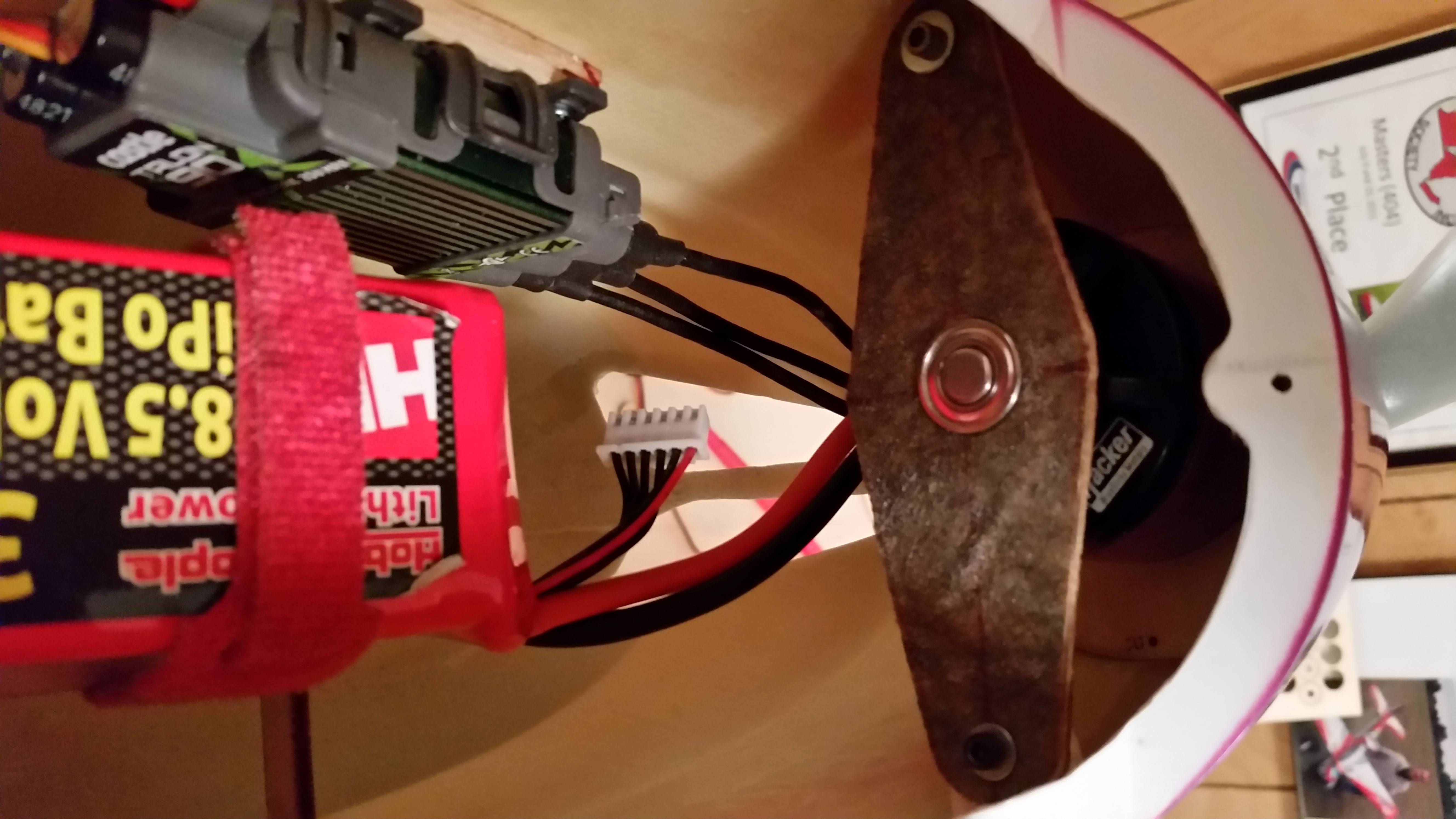

I wont be using the stand off's it was more the bearing support I was interested in. The advantage with that mount is will keep everything concentric, as soon as it arrives I will see how much weight it will add.

The rear support is pretty easy to do as well. Found a flange bearing at Mcmaster Carr that was a good fit. Tabs were a little small and I did a poor job cleaning and prepping the glass but I think this will give you an idea.

That is very similar to what I had in mind, then I came across the Dualsky and for the money it is worth a try. I will extend the rear frame (in carbon) work to the sides of the fus, not happy about hanging everything off a very thin firewall.

The mount has arrived and installed will post some pic's asap. The advantage as I see it with the Dualsky mount with its rear bearing it keeps everything aligned and my rear mount attached the motor to fuselage sides just bolts on to the ali frame.

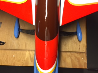

The left gear leg looks twisted to me. It bolted in OK, but the L wheel is toe'd out badly.
Having trouble getting it to balance at the specified 190mm from LE. Using Himax motor, APC prob, and light elevator servos.
Thoughts?
Thanks, Dan

I have my batterys slightly over the back of the battery tray. Both my gear had sever toe in. I slotted the holes in the CFgear. It's better but not as good as I would like.

Twin elevator servos are about 80 grams too heavy in the tail compared to a pull pull setup. That much extra tail weight needs a corresponding amount of nose weight to balance right, or about 8 ounces. If you have about that much live nose weight you can play with, consider yourself lucky. But don't just add dead weight unless it's a last resort.
the left gear leg looks like it has mounting holes drilled incorrectly. It shouldn't be that hard a fix.

Thanks guys,
I found the answers on the other Caelus thread:
Some gear legs do have twist in them: they can be fixed by heating in an oven and untwisting them.
Nobody was running their CG as specified in the instructions. I conclude the instructions are wrong.
