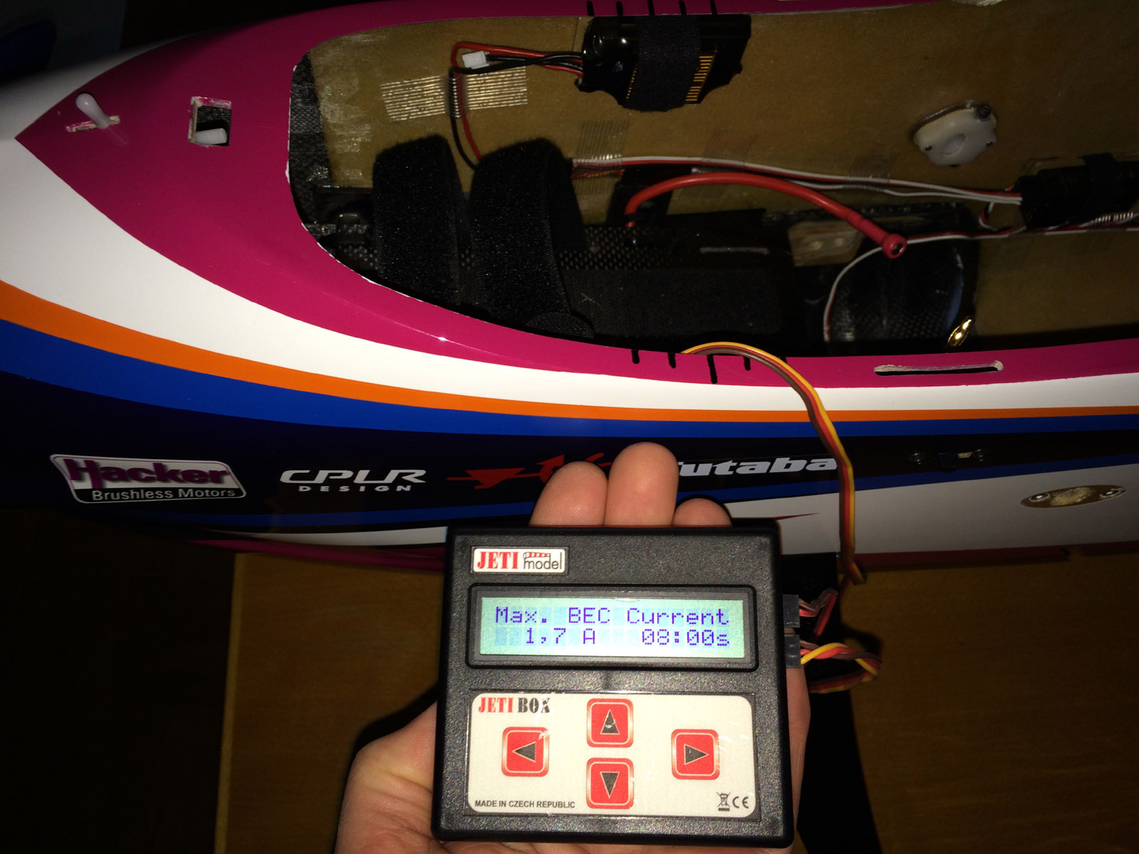

I recently ordered a Powerbox electronc switch (dual lipo running at 7.4 volt version). This unit will be used to power up (5) high voltage servos with a total capacity of 524 ounces of torque, according to Spektrum.
What size lipo battery do you recommend and it is advisable to use the same capacity for both batteries or one larger as the primary and a smaller (lighter) as a secondary.

It depends how much current Your servos will draw, and how large margin You want to have if one of the LiPo packs fail in flight. And You probably do not want unnecessary weight so not too large LiPo packs.
Example:
ThunderPower ProLite+ 25C 2 Cell LiPo 480 mAh weight 30 grams, same but 730 mAh weight 39 grams. In Your case x 2.
I checked max amp draw from log (with help of Jeti Box) of my ESC Jeti/Hacker Master Mezon 90 with BEC and max amp was 1.7 amp. But that is max amp value, the avarage amp should be slightly less but to be on safe side one could use max amp draw when calculating how large LiPo packs one want to use (but I do not use separate LiPo packs for servos+receiver like You will have, I use instead Scorpion Backup Guard that is a 2 cell 500 mAh Lipo connected to receiver with special function to jump in if voltage is 5 volt or below like if BEC fail or similar). I have my BEC set to 7.4 volt so servos and receiver get that voltage.

That's very helpful, it reaffirms my original research in deciding the course of action. I did take your advice and purchase (2) Thunder Power, 2S, 25C, 730 mAh lipos as the power source. The difference in weight between the 480 and 730 is negligible at 9 grams per lipo.
