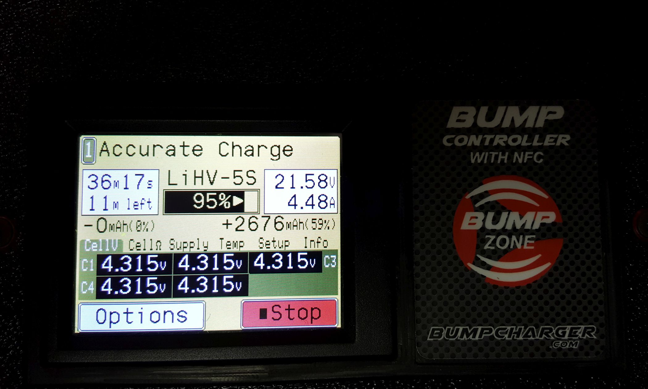

I need help in deciding what brand of charger to purchase. I have decided to charge my packs now as two 5 cell packs in lieu of 10s packs. I have a Thunder Power 1430c and a icharger 3010B and several power supplies. The Thunder power, according to TP Service says I need to recalibrate the 1430C. Now, I don't want to make this complicated, but I would like to charge at least 4 (5s) at a time, does not have to be really fast but an hour should be long enough. Help?

Revolectrix/FMA Powerlab 6 or Powerlab 8 with their MPA parallel adapter would do what you want
For extra credit, you could add their new Bump controller (RFID tag on battery, reader on charger, makes setup foolproof and also keeps track of battery)
Very good suppport out of MD, accurate and safe.

I agree 100 percent. I've been using one for the past 18 months and can't find anything more I would want in a charger.

I have used the Powerlab 8 with MPA board. I have tried 6, 4 and 2 5s packs in parallel. Sometimes the packs would charge and balance well while at other times the packs would be badly out of balance. I even got a second MPA but that made no difference. I have tried Zippy and Dualsky packs and both produce the same random unbalanced result. I would get packs coming off the charger at 99% with others at say 86%. The low pack would have one low cell and it would take several hours to rebalance the pack. I have parallel charged 6s packs with no problem so I'm not sure why I had problems with the 5s. Maybe it is just a matter of averages. One cell of a 5s is 20% while it is 16.6% for a 6 cell. So the 6s packs may not have been that well balance either but a low cell is not contributing as much the overall final voltage and I have probably willing to accept a pack at 96% of the charger. While in theory parallel charging should work in practice it doesn't seem to. I now have a iCharger 4010 Duo and a 3010B. Both are great chargers and I can charge three 10s packs at once without having to worry about unbalanced packs. I would stay away from parallel charging and stick to series charging.

I use the 3 FMA 10XP and charge either as 2 5S or one 10S on each one and Love it. It take 30-45 min from 20% to 100% charge. And in 2-3 hours I can charge enough batteries to fly most the day at the field
I tried a parallel board and I could do more batteries at one time, however I have had cells go bad on me in flight and so now I am anal about getting the IR for each cell, so I can monitor battery performance and check for cells going bad.

You both make good points on the pros and cons of each option. The beauty of the parallel board is just that, it's an option. When I'm under the gun I charge 2-3 at a time, when not I normally charge individually and read the data as it uploads to the tablet at the conclusion of the charge.
