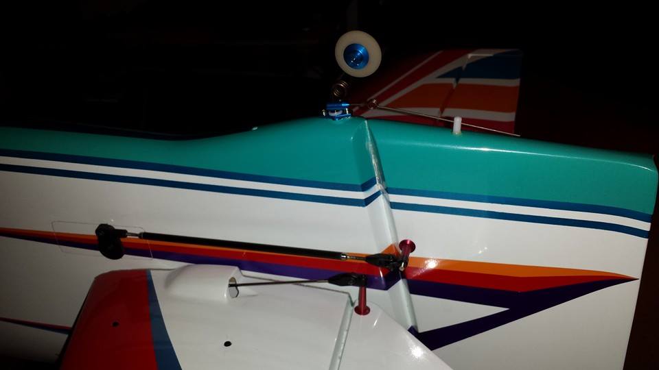

Anyone know if you can mount the rudder servo in the aft of the fuse for push pull, instead of pull pull?
You mean like this? It's been done for a few years now.

Obviously Adrian, I've been fly FAI/F3A pattern since 2007, like yourself. My question was directed at the Acuity specifically, does the Acuity have a servo bay to support a rear servo installation similar to others, like BJ Craft has for example.
That's all I was asking....

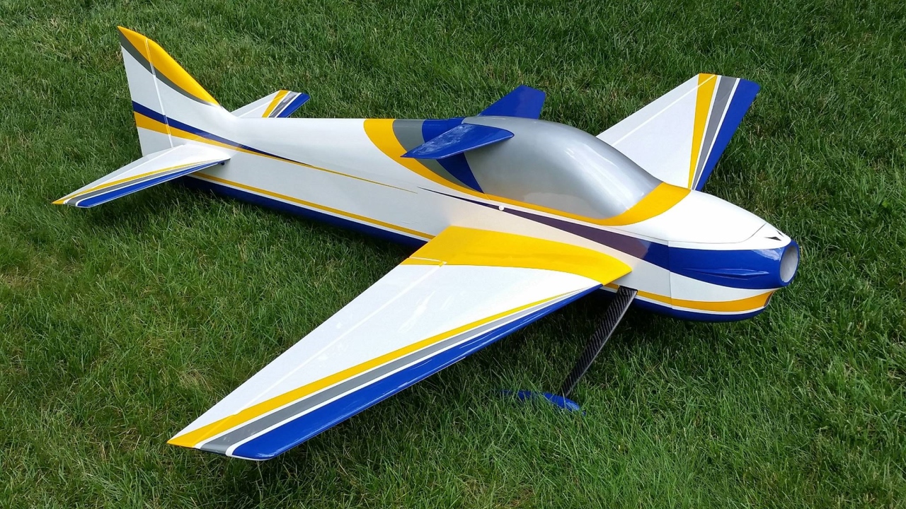

Hello
Nice color

I like that as well!

You can mount the rudder servo in the tail along the fuse side of it can be mounted up front and use pull pull. Jason had his setup as pull pull at the Nats.

The rudder servo can be mounted either in the tail with push pull or up front using Pull Pull.
