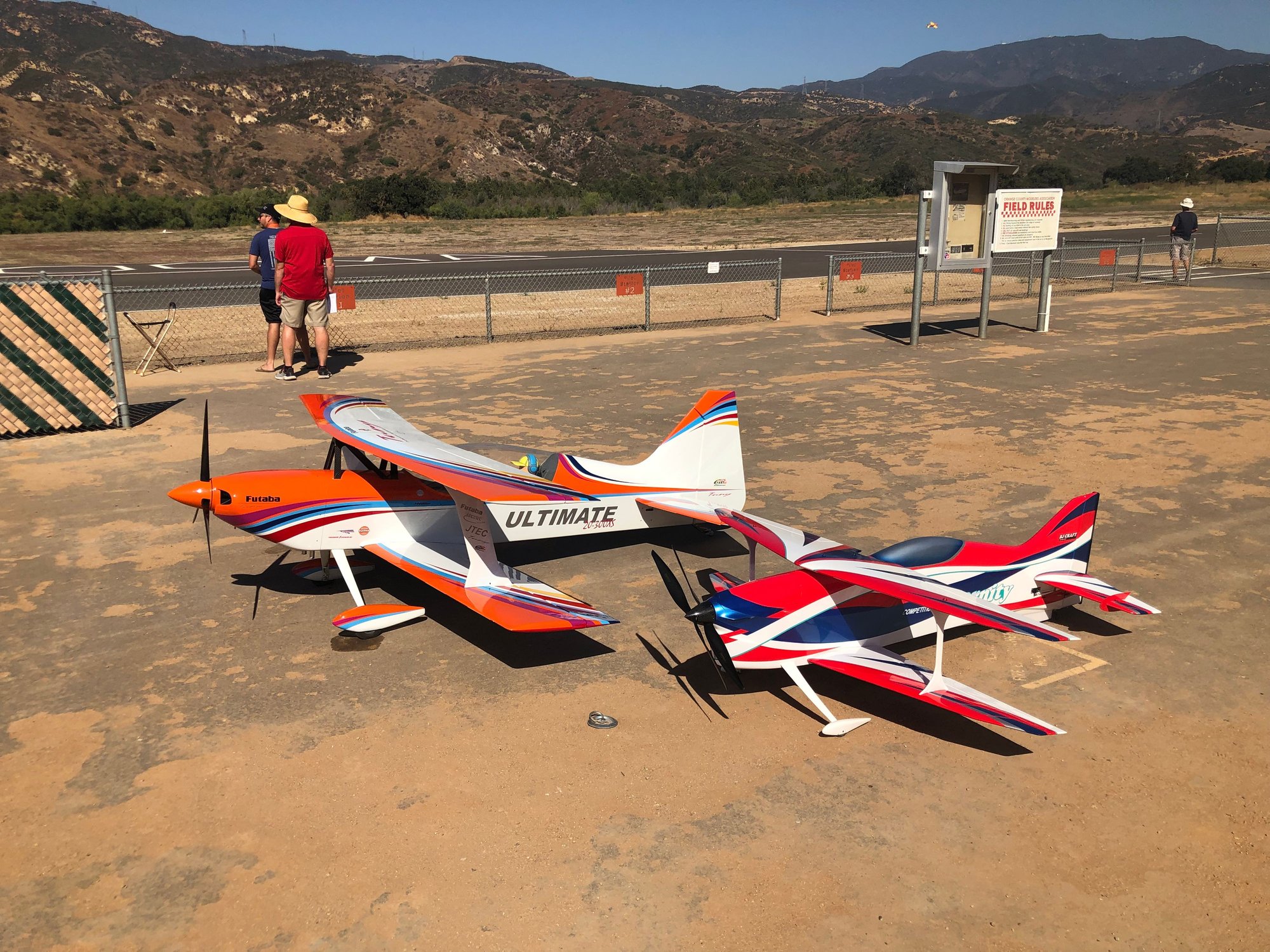

It’s been a while since I posted an update. I have the Eternity flying very well. I added the stab fences and the Ventral fin similar to what you see others using. It tracks nicely and feels very locked in.
I added more brake on the XDrive and slowed down my overall flight envelope. The slower speed and brake really helped the presentation and tracking. The plane is very different when you keep it fairly slow and constant airspeed.
The XDrive has been doing great since the changes BJ sent. I also hard mounted the rear and that helped a lot with tracking thru corners. I’m really liking this setup. Here’s a couple pics from today next to Jim Woodwards Tuny Built Ultimate

That ventral fin looks like it might be a problem when flying off grass?

Possibly, I am fortunate to have only hard surfaces/pavement to fly off so it isn't an issue for me.

Steve - Beautiful pics! Thanks for all your help and letting me fly the Eternity. It is an amazing plane for sure on your setup!

Looks like a stick plane next to the Ultimate!!

That Ultimate is a beauty for sure.
