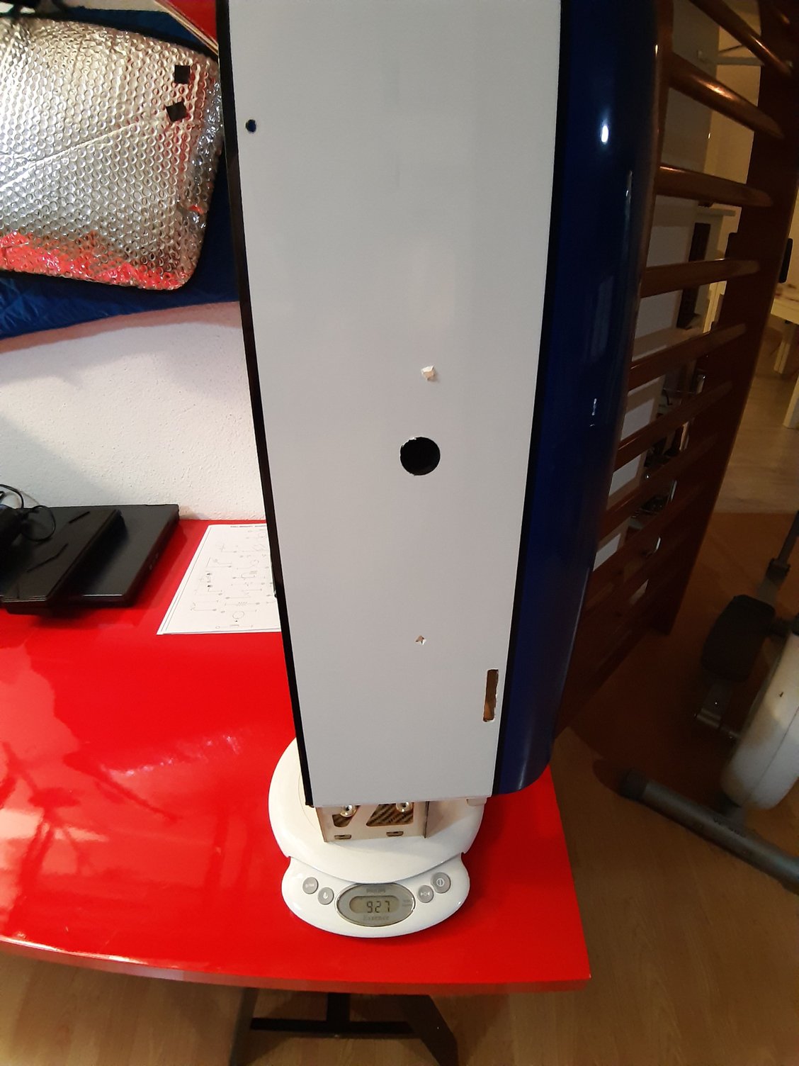

Default Some weights:

Old 03-11-2020 | 12:10 AM
Joined: Dec 2019
Posts: 109
Received 5 Likes on 4 Posts
From: SAINT GERMAIN EN LAYE
Hi
Do you have a difference of 100 grams on the wings ?
Fred
Old 03-11-2020 | 02:38 AM
lc_eiras's Avatar
Joined: Sep 2004
Posts: 51
Received 8 Likes on 6 Posts
From: Lisboa, PORTUGAL
Originally Posted by Frédéric Garnier
Hi
Fred
Hi Fred,
Yesterday, it seemed strange to me, too. But this morning I confirmed it and it's okay.
Right Wing - 283g
Left Wing - 286g
//Luis

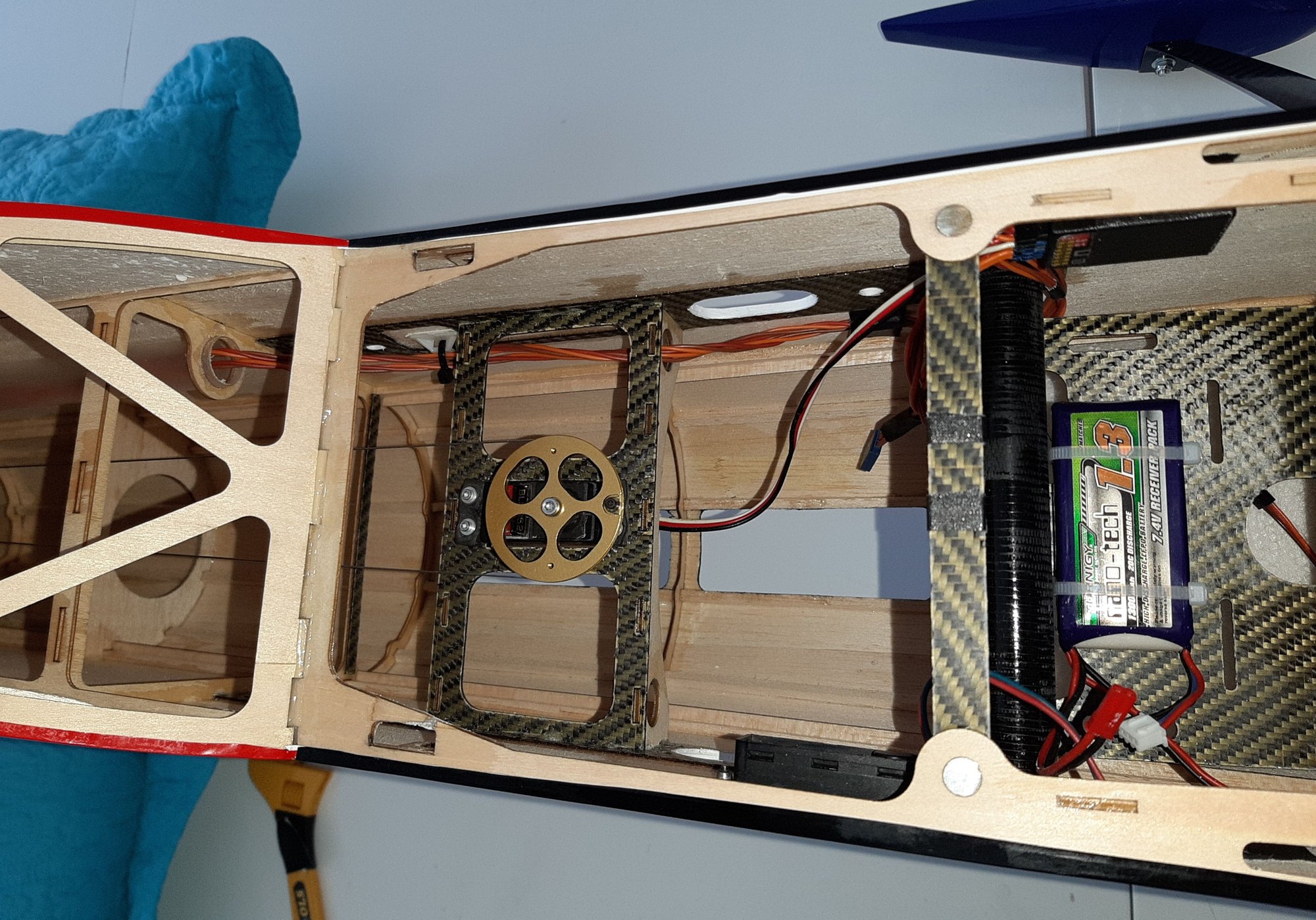

Rudder Servo Installation

I’ve never seen a rudder servo wheel like that used on a pull pull
How does it work and who makes it?
Old 03-13-2020 | 02:55 AM
lc_eiras's Avatar
Joined: Sep 2004
Posts: 51
Hi Itc
The advantages of this type of installation are:
  1. If installed correctly you get an equal tension on both sides of the installation (works with a single cable opposite one to the left and the other to the right).
  2. More linear rudder movement with benefits in centering.
  3. Less servo force (resulting from distributed tension).
But with a normal servo arm it still works!!!!!!
You can find it in here:
https://www.probuild-uk.co.uk/index....roduct_id=4147
https://www.ebay.co.uk/c/1052995784
https://www.gravesrc.com/hangar-9-pu...air-large.html
Old 03-14-2020 | 07:49 AM
papaone's Avatar
Joined: Mar 2005
Posts: 1,414
Received 137 Likes on 74 Posts
From: Salon, FRANCE
Hello lc
You must have the same wheel in the rudder (as shown on pictures) to get the advantages of this type of installation.
lc_eiras (03-14-2020)
