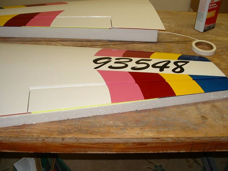

Steve,
It appears that after you sanded the primer (gel coat) down you didn't lay a base white coat down and then paint your colors over it. In fact, it appears that you're not painting any colors over colors but rather tape right up to a pre-painted line and shoot the next color. Is this correct? (Was that question even coherent?)
The reason I ask is that I normally paint one color and overlap it slightly into where the next color will be then tape over the previous color to paint the next one. This clearly adds additional weight but I’ve always been worried that trying to tape EXACTLY to the seam of the last color wouldn’t work well as I may have small gaps. Can you describe what you do, I’d like to save the weight penalty of overlapping, but I’m not sure how to go about it.
BTW, what type of PPG paint are you using DCC ?
Keith B
Keith B
#31
My Feedback: (76)
Keith,
Yep, you got it right. I only rough up the white gel coat with 400 to 600 grit sand paper. Then I spray a very light primer. Only enough to look for areas needing filler or touch up. Then I sam much of it off with 600 grit. I use the 3M blue fine line vinyl tape. Yes I butt some of the colors up to each other (red to white and canopy pink to metallic silver. When you lift the tape when the paint is tacking, you get a blended paint line. If you wait until the paint is dry, then you get a sharp line. If you minimize paint over paint, you can keep the weight down. Tomorrow morning, I'll weigh everything for paint and monokote weight. Only my small yellow, metallic blue and maroon was painted over the white. Here I use the 1/8" tape to make sure the color lines are parallel to each other as these colors do not butt up to each other. On the bottom side of the paint, I use the 1/4" tape. This serves as my paint distance guide. This way my side stripes end with 1/8" spacing and exactly 1/4" wide trim colors. Hope I didn't confuse you.
The PPG paint is the same that Tony Stillman sells at Radio South. I believe it is the DCC.

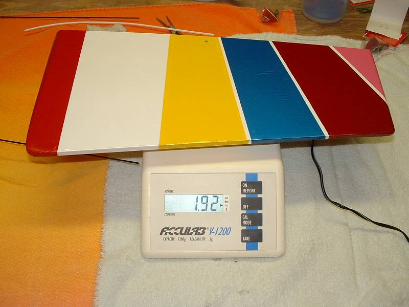

Paint and Monokote weights
Here are the final paint and Monokote weights [b](bold underline)[/b] before radio installation.
Fuse 21.71oz (29.25) (32.0)
Canopy 4.37 (4.86) (5.35)
Cowl 3.11 (3.21) (3.53)
Total 29.2oz (37.32) (40.88)
Rudder .98oz (no LE installed) (1.56) (1.92)
R stab 1.39oz (no LE installed) (2.30) (2.71)
L stab 1.32 (2.23) (2.61)
R wing 7.82oz (no LE installed) (10.53) (12.26)
L wing 7.85 (10.53) (12.3)
wheel pants 1.3 (1.4) (1.55)
alum gear 4.8 (will use the Bolly CF gear)
PBG 7/8"x30" 2.6 (will use this CF wing tube instead of the aluminum)
PBG 7/16" 0.7oz approx. (will use the PBG CF tube instead of the aluminum)

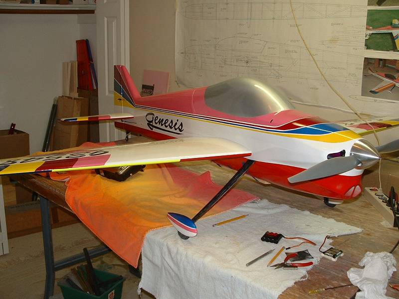

#38
My Feedback: (76)
Genesis is finally finished
We, it has been a interesting three week build project. I had some rework, but it's done. The final weight cam in at 10# - 11oz. This includes a Tru Turn aluminum spinner, a 1600ma NiCad battery. If I were to install the newer generation TP5300 5s4p batteries and a CF spinner, I could shave off another 4oz of weight. All in all, I'm pleased with the outcome. I hope to fly the plane in a few weeks. Next weekend is shot for me though.
This is a great building kit. Good quality.
Signing off.
Steve K
Signing off.
Steve K

Test flights successful
I had a chance to make four test flights today. I only needed three clicks of down elevator trim and one click of right aileron trim. The rudder was right on. I flew three complete masters patterns. I had no mix for the flights. On both right and left knife edge, the plane tracks straight. Roll couple is very slight. Probably needs less than 3% mix. I may leave it. Up and power off down lines are straight with no pull to canopy.
On the first flight, the CG was set at 1/16" in front of the front of the wing tube. It was too tail heavy for my liking. Rudder and elevator was too sensitive. For the second and third flight, I moved the batteries 3/4" forward. This probably changed the CG forward 1/4". I liked this arrangement much better.
The first, third and fourth flight was with the APC 20-13e prop. The second flight was with the APC 21-12We prop. The APC 20-13e prop only pulled 62 peak amps WOT with the Hacker C50-13XL motor set at 3 degrees timing and using the TP6000 gen II lite batteries. I may take the Hacker C50-14XL motor out of my Eclipse and compere the two. Overall, I had much straighter power on up lines with the 20-13e prop. The 21-12We prop had a lot of torque effect requiring a lot of rudder control.
The rolling characteristics are good. I have almost no differential. I did however increase elevator expo to 35% to soften up neutral. The aileron expo is set at 25% and rudder is set at 40%. Attached are some photos of the finished plane, control throws and the broken Chip Hyde Clevis.
I found out you are not supposed to pry open the Chip Hyde clevis. Just simply unscrew the pins when installing. My flying was cut short when I broke the elevator clevis. Fortunately I was able to reinstall the pin in a Hays 4-40 clevis. Central Hobbies does not have any replacement clevis. I am glad they told me what I was doing wrong.
