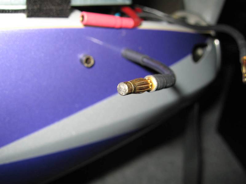

Hi Morten,
I decided to pull the Dean's connectors and use individual 5.5 mm connectors as you have done. I'm also considering the arming jumper. I'd like to make the two females in the fuselage a removable assembly and have one of them soldered directly to the ESC. The assembly has to withstand a fairly high insertion force so the load needs to be spread out on the side of the fuse. I was wondering if you had any tricks in your mounting method.
Jim O
Jim O

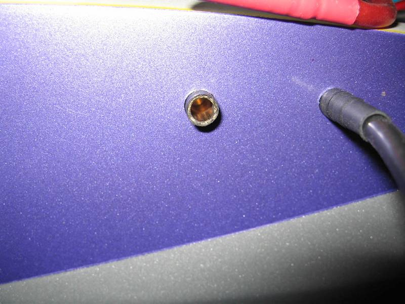

Posts: 242
From: Henne, DENMARK

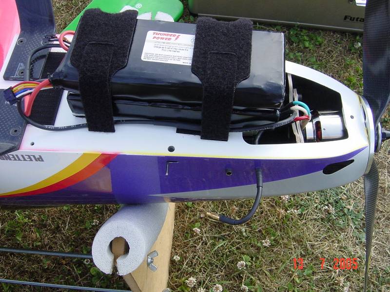

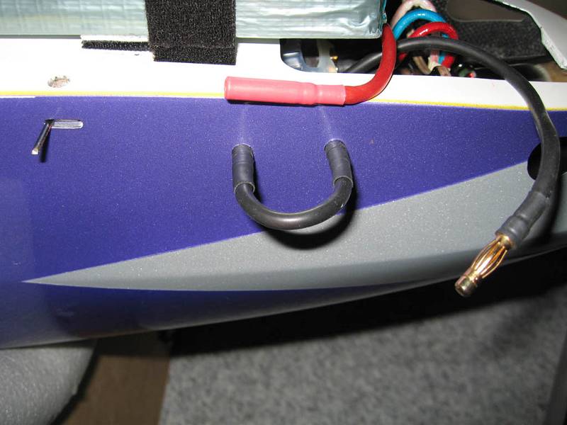

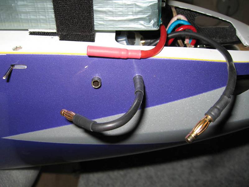

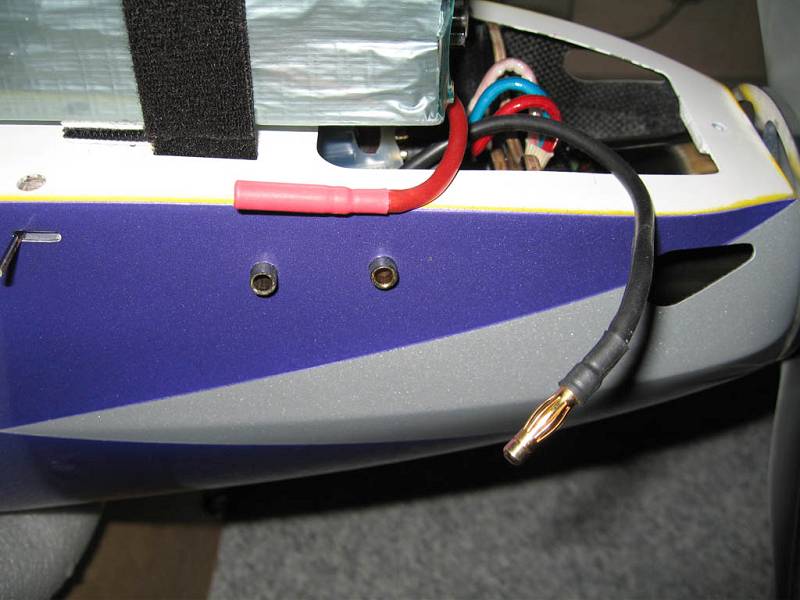

Hi Jim,
I made a support plate for the two sockets and glued it to the inside of the fuselage. If the fuse is carbon fiber like my Synergy make sure the sockets are insulated using heat shrink tubing, since carbon fiber is a good conductor!
As you can see the support plate is made up by a piece of fiberglass plate (fiberglass insulates) and a piece of balsa wood. The gold 4mm sockets were glued directly to the fiberglass plate and afterwords the sockets were covered with the heat shrink tubing. Then the balsa block was glued to this assembly and lastly the complete assembly was glued to the inside of the fuselage. It has worked well, and the fuse does not flex the slightest when it is being "armed".
I actually only fit one socket into the fuz side, the negative female from the ESC. I have another hole alongside which is finished off with an old MK fuel dot bezel. The negative battery lead is passed through this bezel when installing the battery and left dangling. When you want to arm you push it into the socket.
Advantage - no extra plug and socket electrical resistance. Disadvantage - you cant fit an anti sparking resistor across the two sockets.
Malcolm
Malcolm
