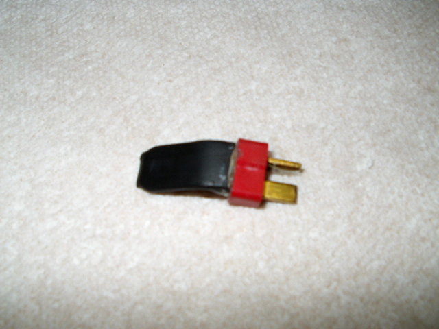

Here's another approach to an arming "key" system. A Deans socket Aeropoxied to the LG plate and wired in series with a batt / ESC lead. The key is a Deans plug to which a handle / jumper is attached. The handle is a piece of SS Hatori pipe mount material soldered to the Deans and shrink wrapped for insulation. The handle is bent to match the LG strut angle so as to be less obvious.

Old 03-29-2006 | 02:28 PM
  #32
Joined: Mar 2004
Posts: 498
From: Moss, NORWAY
Default RE: Connectors and connecting
Earl.
That is very similar to the solution I am using.
I have made a small 1/4" plywood plate that is glued to the inside of the fuselage.
There is a set screw in the plywood plate that holds the female Deans socket in place. I only need to loosen the screw a couple of turns, and the plug can be removed.
I actually wanted my connector to be as visible as possible, for safety reasons. I see it as a kind of emergency switch, so I don't want to hide it.
