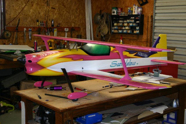

The Scandalous ARF is avaliable at Chip Hyde.com along with the Genesis ARF
I am going to try and do a build thread as soon as I can
Here are a couple of pic's for now

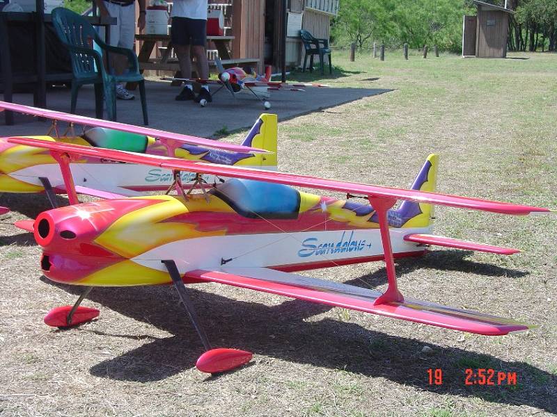

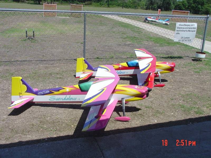

First Flights on My Scandalous show Outstanding Performance with a Hacker C50xl14 and 5300mah TP. First Trim Flights this weekend in 15-25 mph wind! Not Good For a Clear evaluation... of course it's Dead Calm today and I'm at Work D@** #%& !!! I will Say that this plane handles the wind better than I expected with all the wing area..Snaps are Clean and on a line..Rolls are very Axial and present Very Well..later

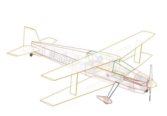

What pattern bipe are you building? I've had a soft spot for bipes for a long time. My attempt on turning a Dr. Jekyl into a bipe was not too successful due to serious coupling with rudder. Finally gave up and sold it.

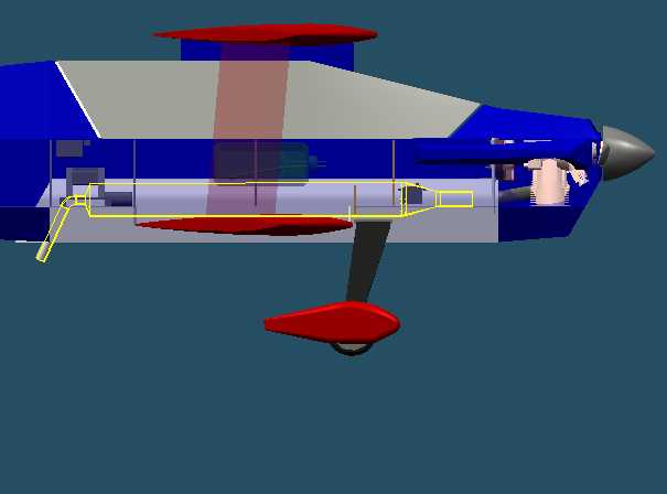

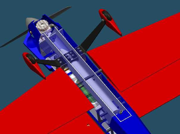

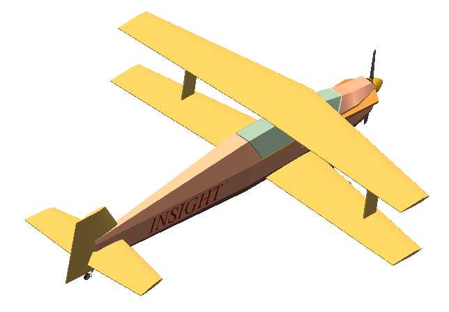

Chuck,
Here is your permission to share....wish I had time to build it myself....maybe this Winter....
I hope you can build light......like Japanese light.... The cores for the prototype are cut, but it will likely be after the Nats before I can sheet everything.
Good luck...

BTW, my big hangup with diving into this can of worms....besides building light, hoping for very little coupling, etc., etc.....is the logistics of having a pipe go through or over a lower wing tube.....yuk. Maybe a short hatori on a DZ or electric is the way to go....
p.s. Sorry to hijack the thread.....seeing those beauties fly at Jetero was an honest treat.

I assume the roll couplling was due to the top wing being joined to the body. I could mix it out pretty well at one speed, but faster or slower and it showed up again. And not just minor, it would be almost uncontrolable if you used rudder at high speed (roll and dive). Also caused problems at low speeds on things like stall turns and landings. Oh well, I guess that is why I don't make a living designing airplanes!
I have a Runaround kit that I was thinking of mating to a set of Ultimate Wings, but now I'll hold out till yours is finished.

thanks Mark.. i will begin a seperate thread in the other forum soon and i plan on using dz power, mainly for weight. I prefer the os 160 at this time cause that is what i know, but things could change.
Jeff... keep in touch, i would love to hear some of your ideas or comments.
