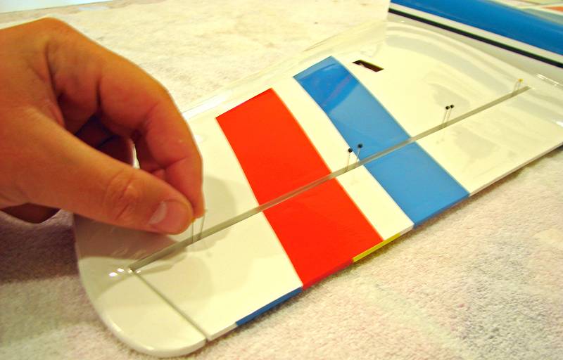

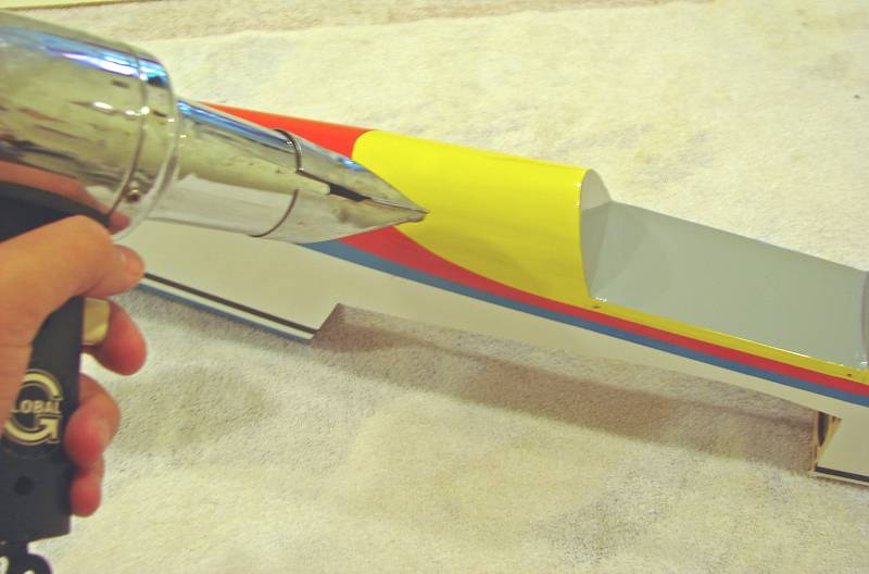

The first thing I do on any ARF is to remove all of the wrinkles in the covering using a T-pin if necessary to remove stubborn wrinkles from the covering. I do recommend removing the pre-installed canopy, so that you do not get it to hot a warping it while removing other wrinkles, It also allows you to remove the wrinkles under the canopy itself.

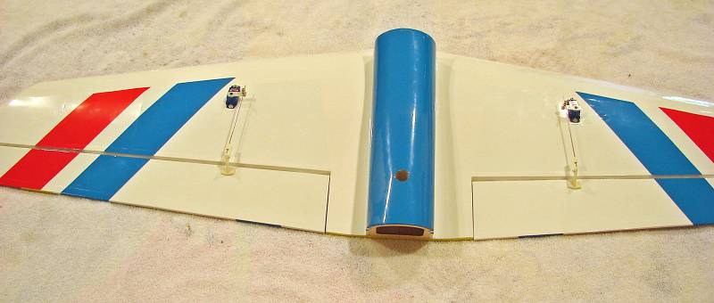

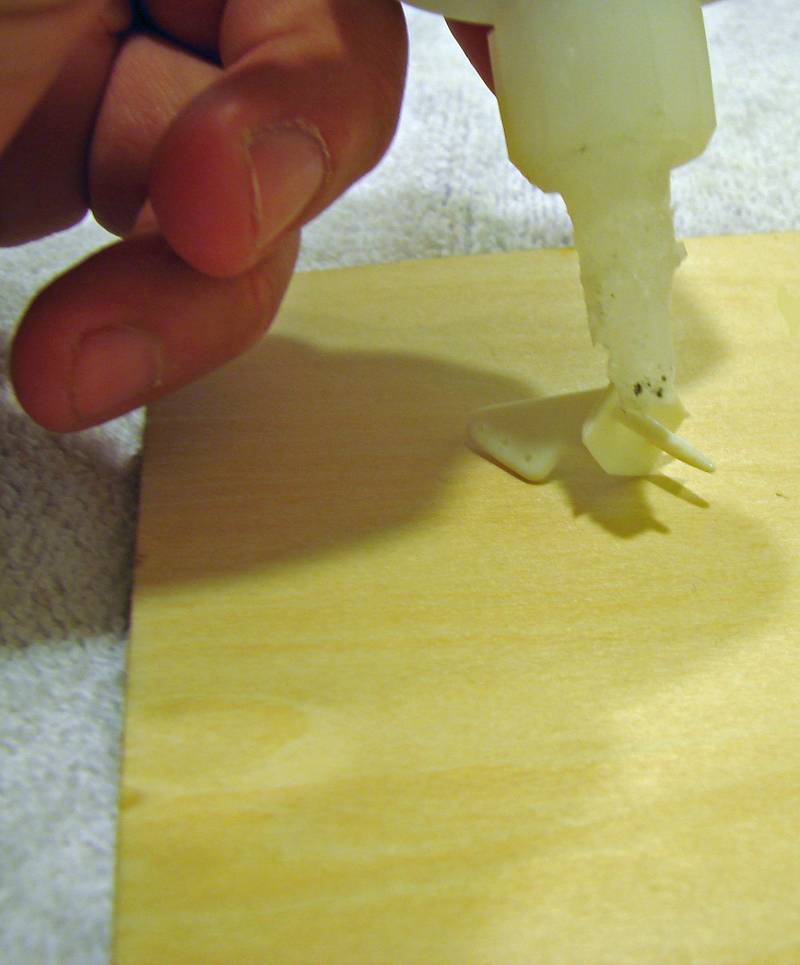

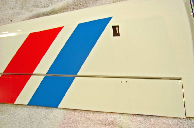

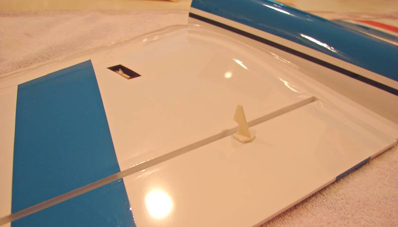

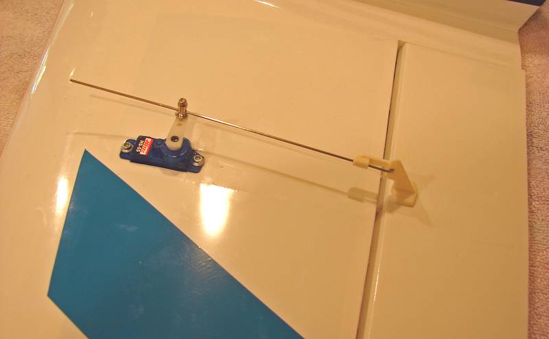

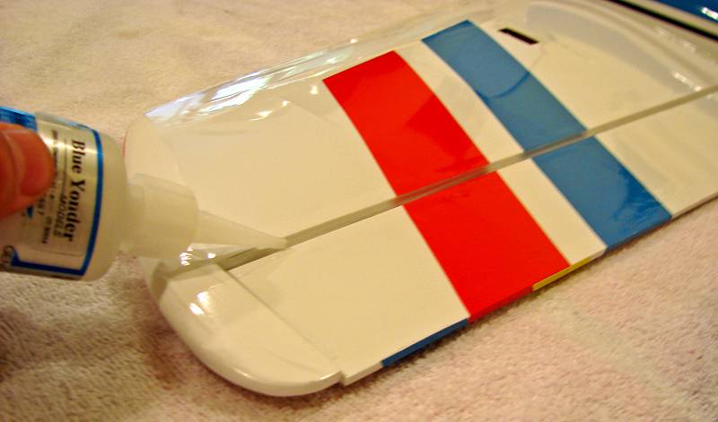

After removing all of the wrinkles I started on the wing.
The first step is to hinge both ailerons I used the supplied CA hinges which were already installed but not glued in the wing. Remember to use two pins per hinge to keep the hing centered and from twisting in the slot. I like to use a new bottle of thin Ca when hinging as it seems to wick in better than older CA. Remove the pins and glue your hinges.
Next comes installing the control horn. The holes are predrilled for you so all that is needed is to test fit the horn and then remove, add some thick CA and reinstall.
Repeat both steps on the other side of the wing and your hinging/horn install is complete.

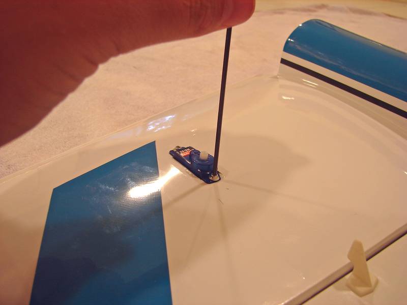

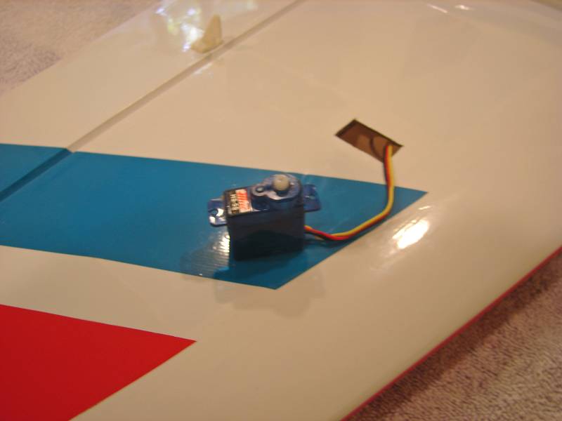

Next is to install your servos.
I like to secure all of my servos using hex head screws as it helps down the road when you need to remove them. The HS-55 servo lead is long enough to be used without an extension.
After that install you arm and the supplied push rod and keeper as shown. Remember to trim of the extra push rod in order to save weight.
Use the same method on the other side and your wing is complete. I recommend that you do tape down the servo leads so they cannot slip back into the wing.

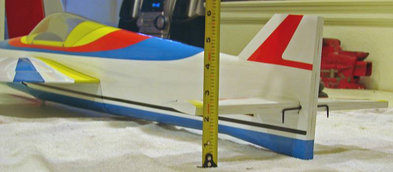

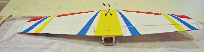

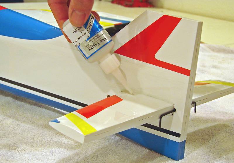

The next step is to install your horizontal stab.
It is very important that this be done with great care and is alighned straight in every angle.
Once your are satisfied with its alighment remove the covering from the gluing area reinstall onto the fuse also inserting the elevator jioner (do not forget to do this as it will be imposible to insert later). Apply thin CA to all side of the stab inseringthat it wicks in and creats a strong bond.

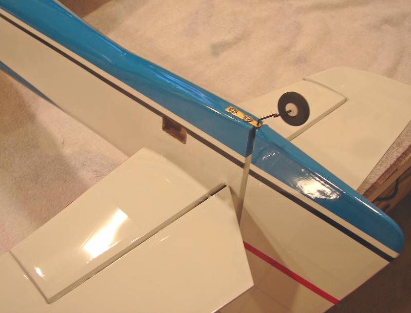

The rudder was hinged using the supplied hinges and thin CA. Notice the supplied tailwheel it is very high quality and offers great ground handling.
