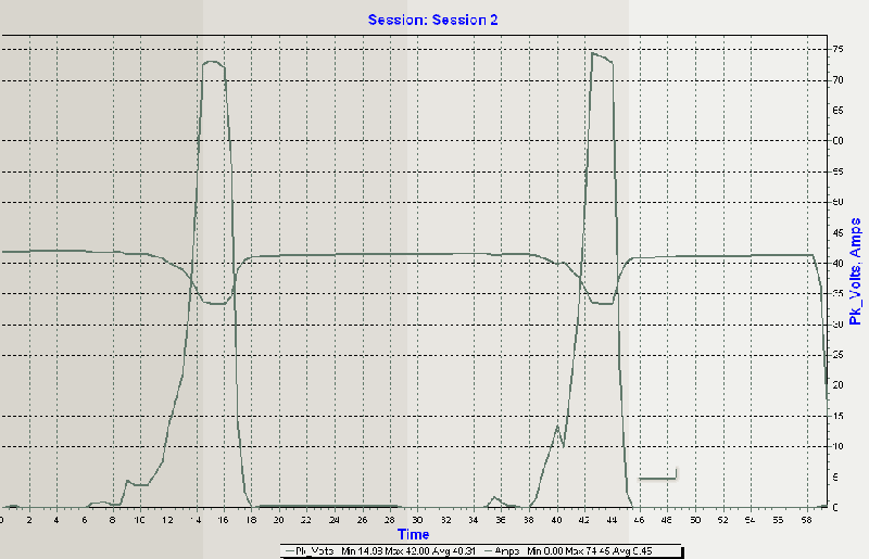

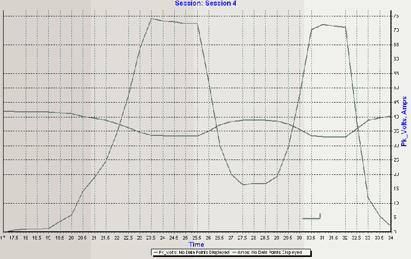

Here's data from four P07 flights.
Ambient:
25degC
1800'ASL
35% humidity
101.3k Pa
FDR data files:
http://homepage.usask.ca/ajg360/July1%2DAG_FDR.zip
The current spike near the end of session four is very interesting to me. I was flying a horizontal at cruise throttle, backed off the throttle a bit and did one positive snap, did _something_ with the throttle (maybe slammed it upwards?), started another snap opposite direction (i.e. two positive snaps, opposite). As I was starting the second snap I heard a hellish noise. I stopped the snap while inverted and went to idle, and headed straight for the runway thinking the motor was falling out or prop was loose. I landed and all seemed OK, so I thought maybe it was an overcurrent shutdown by the Schulze. I get home and check the FDR file, and sure enough the current spiked, no doubt causing the Schulze to cut.

I didn't realize when I posted the data that the Eagle Tree software can only be installed if you have a micrpower logger. So, here are images of the graphs.
