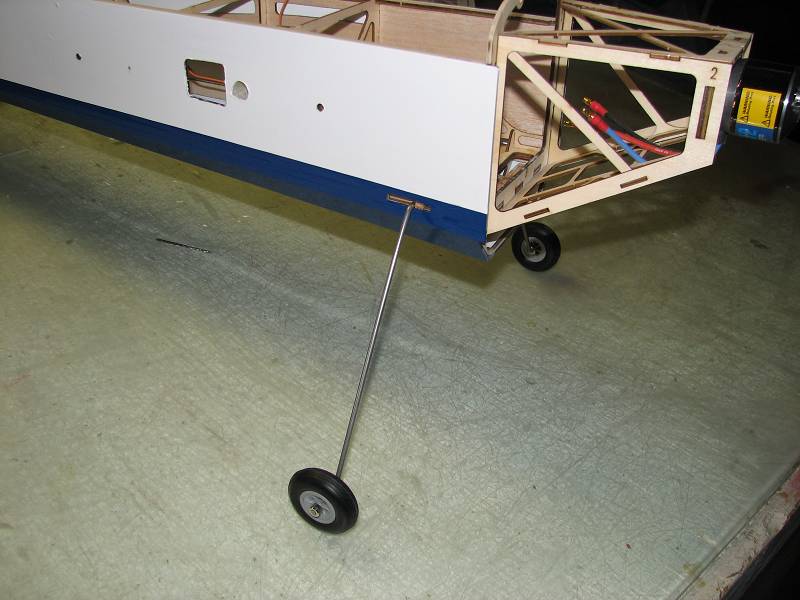

The wire gear -- this is an old art form and likely someone you know has a wire bender ( ask a granpa)
The best setup simply duplicates the setup on old trainer mains such as the Sig kits used. across the bottom of the fuselage --then up the inside . in a channel made from two ply wood or spruce sticks .
the screws on the bottom now simply attach nylon straps - to hold wire in position----all available in any hobby store.
two pieces of wire are used -- 1/8" dia is right for this model and even smaller if you have a really smooth field
also FOX made some wire gear wheel pant attachment devices which slide on and align as you like by tightening a set screw clamp .
It isn't hard to do and it all is faaaaaar more forgiving than rigid al or carbon fibre gear .

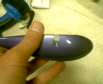

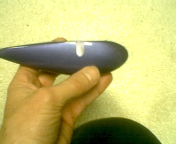

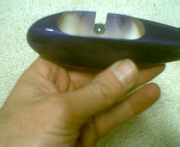

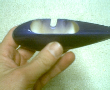

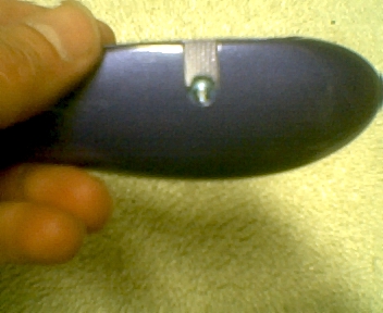

I'm putting together one- my son has taken an acute interest.
Three minute wheel pant mounting. See pictures for detail.
Three steps in three minutes. Push the blind nut up against the top of the cutout, use pliers to push it in, and then put 3 or 4 drops of thick CA to secure it in place. The blind nut matches perfectly with the landing gear 4/40 screw hole and wheels have ample clearance around the wheels wells when mounted.
Don
Don

Nice! There's not much stress on the pants so it should be OK. Let us know after a few landings if they hold well.
Just a personal choice but I would have use Epoxy instead of CA.

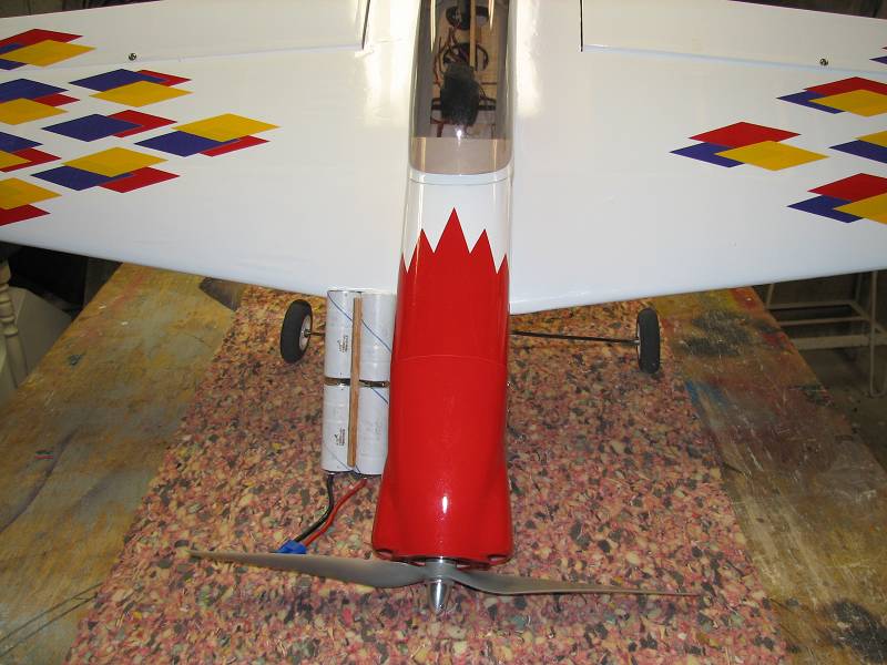

HERE'S AN EASY LDG STRUCTURE FIX. I'm just starting to build my Diamante 25e and having read a lot about the weak support structure, here's what I did. I screwed the LDG bolts in flush with the top of the blind nuts. Then I went in with a swab full of vasoline and coated the top of the screw and nut and moved the swab to the side and screwed the bolts in all the way while coating them with vasoline. Next I mixed up an ounce of 30 min. Epoxy and pored in in from one of the top holes. I tilted the fuse from side to side coating the wedge shaped stringers and above from front to rear and then set the fuse level and angled down a little to let the epoxy settle into a solid piece from just over the LDG screws all the way to the front. I ended up about 1/8" below the wing mount holes and is solit as a rock. After a couple of hours it was hard and I was able to back the bolts out with just a little twist from my wrench. I'm sure it's heavier than other fix's but it sure is easy, and doesn't disturb the outer finish.
Dave
Dave

I simply used a crossed fuselage wire gear just like used on old trainers made from 1/8" piano wire - -much lighter and absolutely foolproof -I have boinked a few landings -being sloppy and no fuss no muss. I did the same on a AJ 300 -far better than th original stuff.

I put the wire gear shown on all my small electrics - it was and still is the best method of absorbing landing gear shock loads -in ALL directions
it is also lighter than any other gear typs -including the carbon fibre types.
