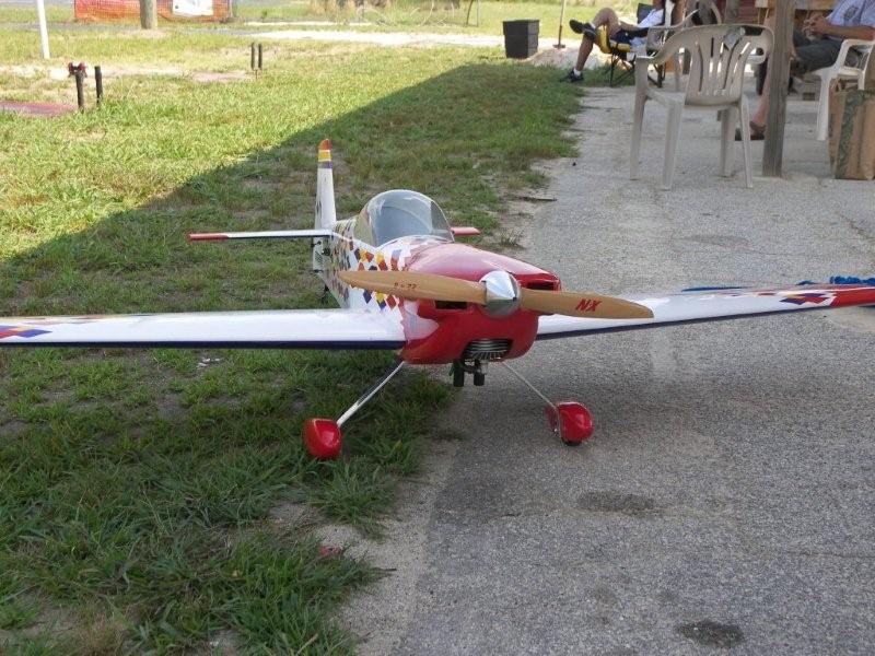

I put the wire gear shown on all my small electrics - it was and still is the best method of absorbing landing gear shock loads -in ALL directions
it is also lighter than any other gear typs -including the carbon fibre types.
The stock gear and wheel pants look much better. The fix DS Dave used was recommended by Ben @ 3D Hobby Shop. It's simple, easy and retains the good looks of the original by beefing up the structure supporting the gear. I have the same fix in my Aspera.
I'm sure you'll agree that there's more than one good way fix any problem.
Regards,
CR

There is no doubt that the gear mounting on this plane is very poor.
On a SLIGHTLY hard landing the center area of the thin ply mount used, bent down the middle, as both gear splayed out.
I removed the ply piece.
Of note is the soft BALSA triangle stock used as brace for this... what a joke!
I mode a thick ply doubler for the ply piece, putting holes in for the existing blind nut locations.
I made a new set of ply "walls" for the wing mount area and the firewall and fuselage areas, in effect forming a new stiff "box" for all the gear forces to be exerted upon.
All of this was closed up with generous amounts of epoxy.
To avoid the lever effect of the gear during hard landings, I also put in two thin steel bars with holes for the gear mounting cap screws. This effectively joins the two gear into a once piece unit, when they are screwed in place.
The entire area is much more resilient now.
The changes added around 2oz to the weight of the plane, but it was worth it.

I'm hoping this forum is not completely dead.
I was at my LHS yesterday and they had the E-flite Diamante 25E for sale for $75 which is about 50% of original price. They had had the plane in stock for a long time and they wanted to move it out. I could not resist, so I bought it.
After searching around I came to realize that part of the problem with this plane has been the problem of landing gears tearing up the fuselage on not-so-hard landings. So, I am now trying to figure out how to strengthen this area.
This first thing I notice is the angle of the landing gear brackets. Any hard landing would create pressure at the front of the brackets due to the angle and snap it off the fuselage. Also, since the brackets are split rather than one piece, a bump or rough area encountered by one of the wheels would not be supported by the other bracket, so it would tend to tear off the one side.
So, the first thing I'm doing is using a landing gear from another plane (that one is in plane heaven) which is a one-piece bracket and set at a 90 degree position rather than angled as noted above.
The next thing I'll do to strengthen the balsa ahead of the piece of plywood used to support the gear is to use fiberglass cloth and epoxying the whole inside area ahead of the landing gear support. Hopefully, this would make it much stronger.
Anyway, I'm going to try the above and see what happens. If the landing gear tears off on not-so-rough landings, then I will reconstruct the whole area with strong plywood, etc as recommended in this forum.
Any comments?

I'm on my 2nd Diamante and love them both. I fixed the Landing Gear problem by mixing up about 3/4 Oz Epoxy. First I screwed the LDG bolts in flush with the top of the blind nuts and with a swab covered in vasaline, coated each bolt as I screwed them in hand tite (without the LDG struts installed) Then I mixed the Epoxy and poured it into the bottom of the LDG fuse area from one of the two oval holes above. I tilted the fuse forward, backward and to both sides allowing the Epoxy to cover over the triangle shaped stringers on each side of the bottom. I then set the fuse level-side-to-side and angled down so the LDG to firewall area would be level. The Epoxy hardened about 1/8" thick and the LDG support structure is solid as a rock.
I crashed my first one so hard the only thing left was the tail section and the LDG support structure with the LDG intact and I used the gear on my second one.
This is an easy fix and is very strong. You'll like flying the Diamantemy first one flew with no trim required.
Good luck,
Dave
Good luck,
Dave
