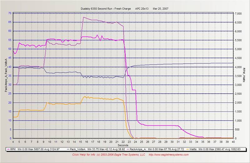

Anybody out there tried ths motor? Would this be enough for P07? How about its durability?

Here are some EagleTree DataLogger graphs using the 6350-16T and an APC 20x13 prop, TP5300 batteries. The motor ran well, never got hot and it was pulling a near 11 lb plane. It would probably work well if your plane was 10.25 lb or less but I think it would struggle if it were heavier and the wind picked up.
The first graph is an exploded view of a short time frame (a few seconds) to show volts/amps/watts and rpm. The second is for the entire flight.
Woodie

Great data Don,
It looks like the efficiency of the smaller motor is not as good at these currents. The Watts, current, etc., are acceptable if it were a 20x15 or 22x12. I guess it figures, as the length of the motor is less, meaning less torque for a given current vs. the longer motor. You don't get something for nothing. It would probably pull a lot more current with the bigger props and that accounts for John F burning one up.

Woodie, 5 minutes for the P-07 man thats quick or at least for me and pulling 67 amps my AXI 5320/28 would never stand for that it would be squeeling like a pig LOL, good info Don. I been wanting see some figures on this motor also.

This was just a test flight, not the full P07 sequence. I did a portion of the sequence but not all since I just wanted some logged performance data. Actually, I was somewhat surprised the smaller motor did as well as it did. It would probably be fine on a lighter plane with a smaller prop.
