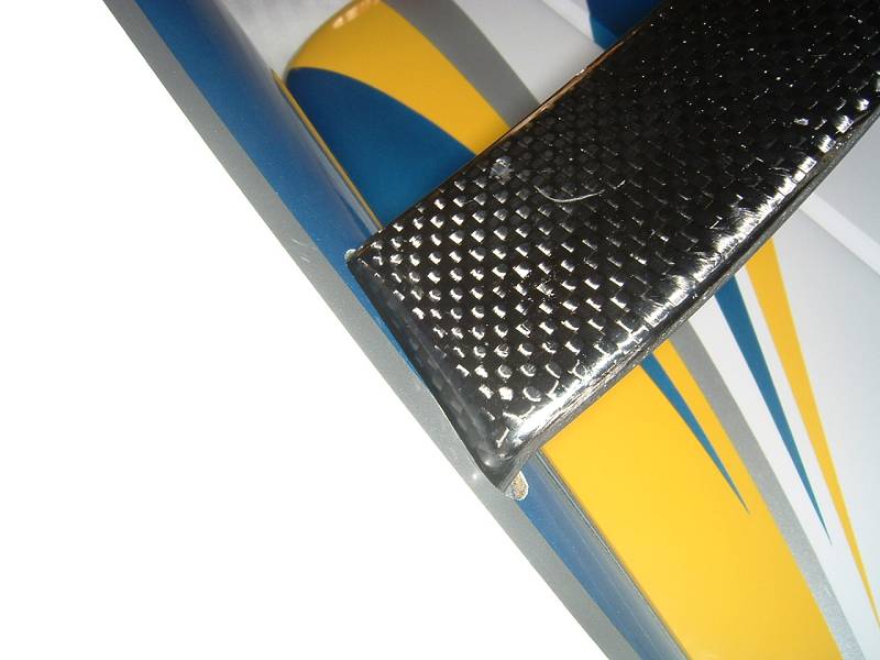

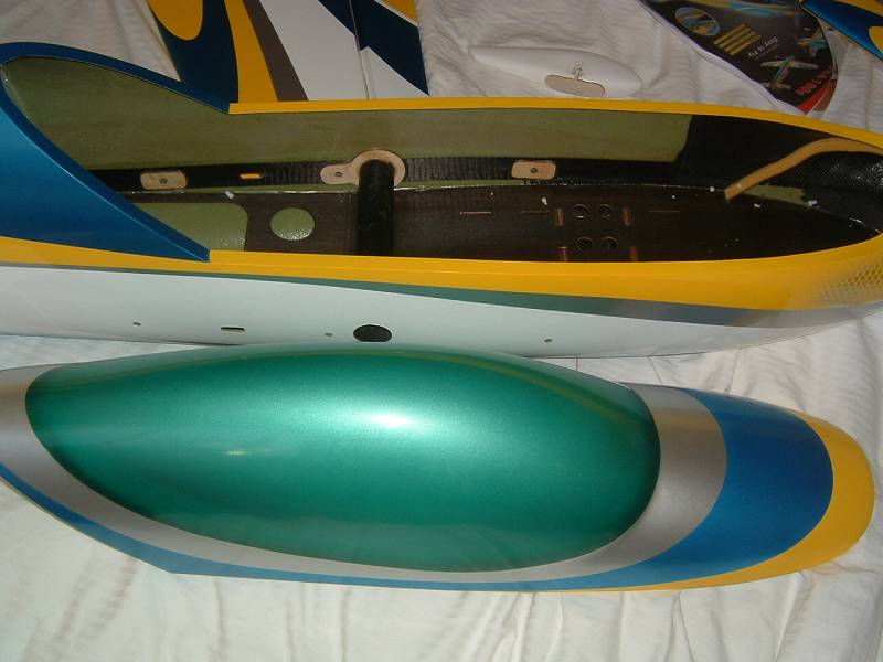

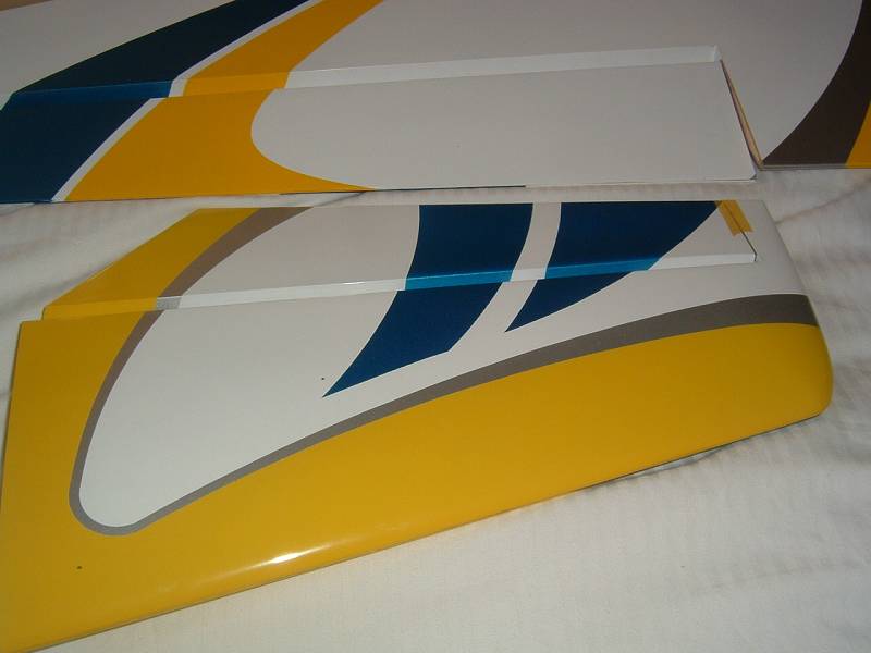

ID:	1091488   Click image for larger version
ID:	1091489   Click image for larger version
ID:	1091490   Click image for larger version
ID:	1091491   Click image for larger version
ID:	1091492   Click image for larger version
ID:	1091493   Click image for larger version
